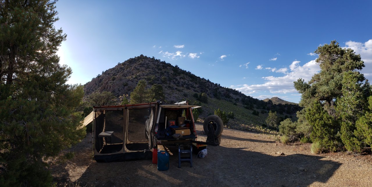

    Once I put on my side awning/room it was a game changer. I am considering a Kodiak/Springbar tent to make basecamp easier.

    Love this setup! Did you mount the awning to the basket or the base bars? I am thinking of getting the 4' awning and mounting similar to this onto my base bars to have some shade over the bed opening.

    Thank you, yeah I mounted the awning to the basket itself using some clamps I picked up at a local overland retailer. I don't actually have 'cross-bars' on my roof-rack..I did a custom mounting option. I will try to get some pictures of all that for you later today.

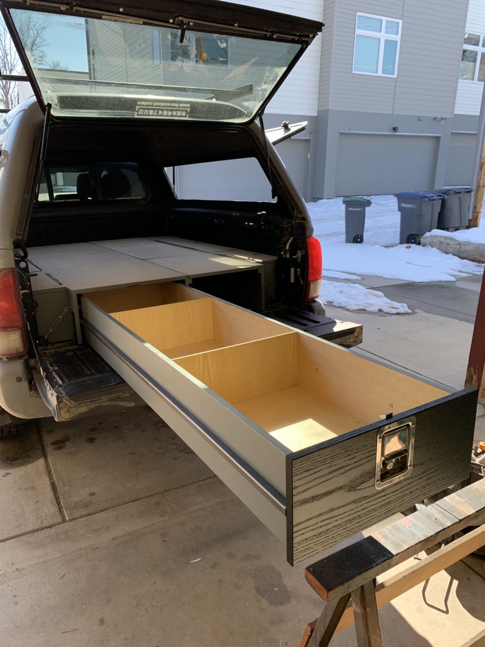

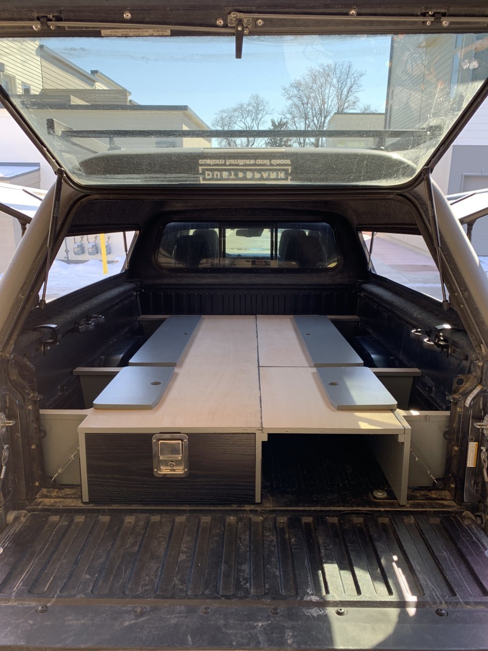

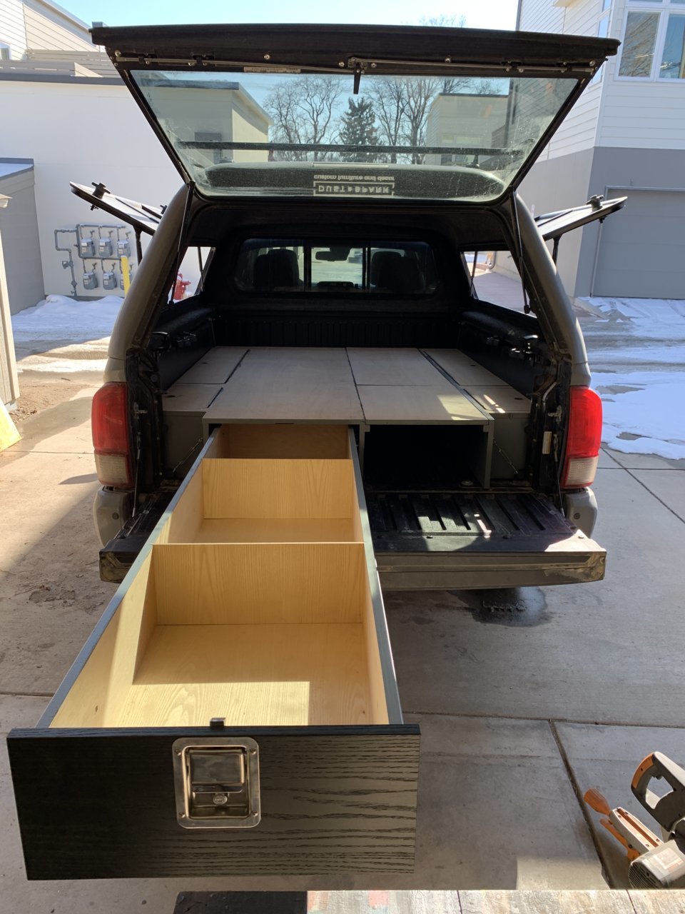

    I am almost done with my build-out. I primed and painted everything except for the top (which is getting black vinyl diamond pattern flooring) to match the color of the truck.

    Nice work - how much does that weigh?

    Did you use drawer slides? Btw looks great!!!

    Not sure on exact weight but it's fairly light for what it is. I can install it myself without struggling if that gives you an idea.
    I used the old 608z bearings and steel rails technique and it slides pretty well. I opted for 3/4" 14g tube steel instead of 1" 16g like most folks use. I wanted to give myself just a little bit more storage space in the drawer and it doesn't compromise anything.

    Thats sweet by any chance do you have picutres on the bearing process
    Oh and also what ply did you use?

    I would also like to see some more photos or plans if you have them. I plan on doing this same thing in March. I am waiting till after I get my fridge so I can decide where I want to put it and how I want to lay out my drawers.
    Nice work though! Looks great.
