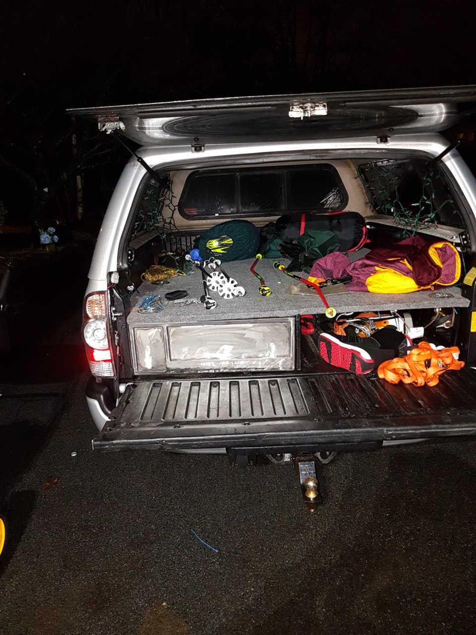

    Interesting- do they catch? I am thinking of making them at least 0.5" to 1" shorter. I have seen people take them down about 2" shorter than the top of the platform but feel as though that may be excessive.

    Doesn't catch, but there are some spots that the paint was rubber off. Does look nice and tight when closed though.20180225_210849.jpg(Pic was pre paint)

    I wanted to maximize drawer space, when I made mine the drawers were the same height as the cabinets (were rubbing, getting stuck), but then i just took a belt sander to it a few times, trial and error, until it didn't rub anymore. They slide freely and give me about max drawer height. I wasn't talented enough to cut the wood/mount the roller bearings to get as close as I wanted, so this was a relatively simple way to achieve that without being precise on cutting.
