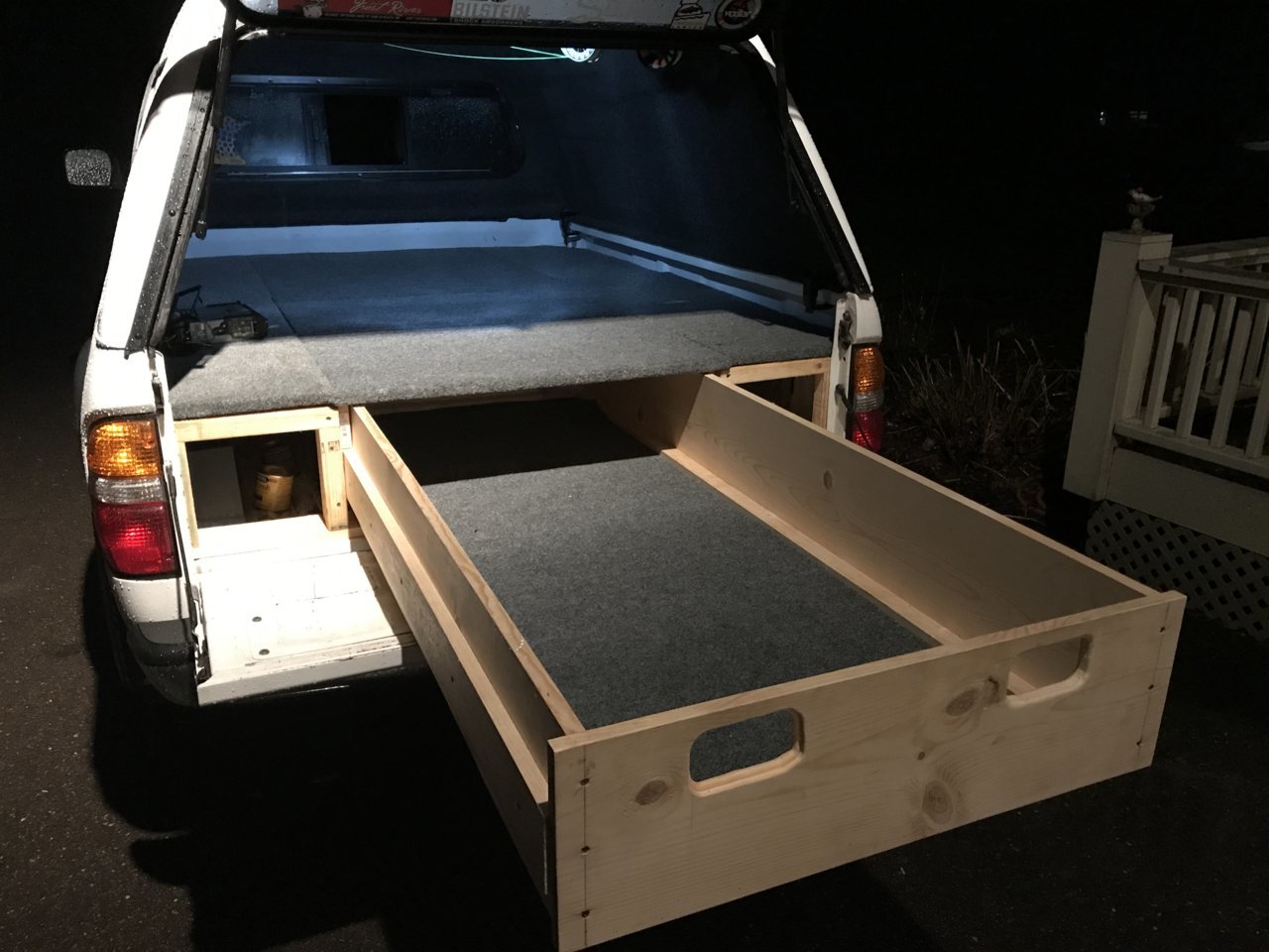

    Was digging through some old photos and found these. I have a 3rd gen now and went with a simple 2 piece setup. It’s aight. But now that I’m looking back on my 1st gen, I might have to go back to something similar.
    How about that scribe work :)

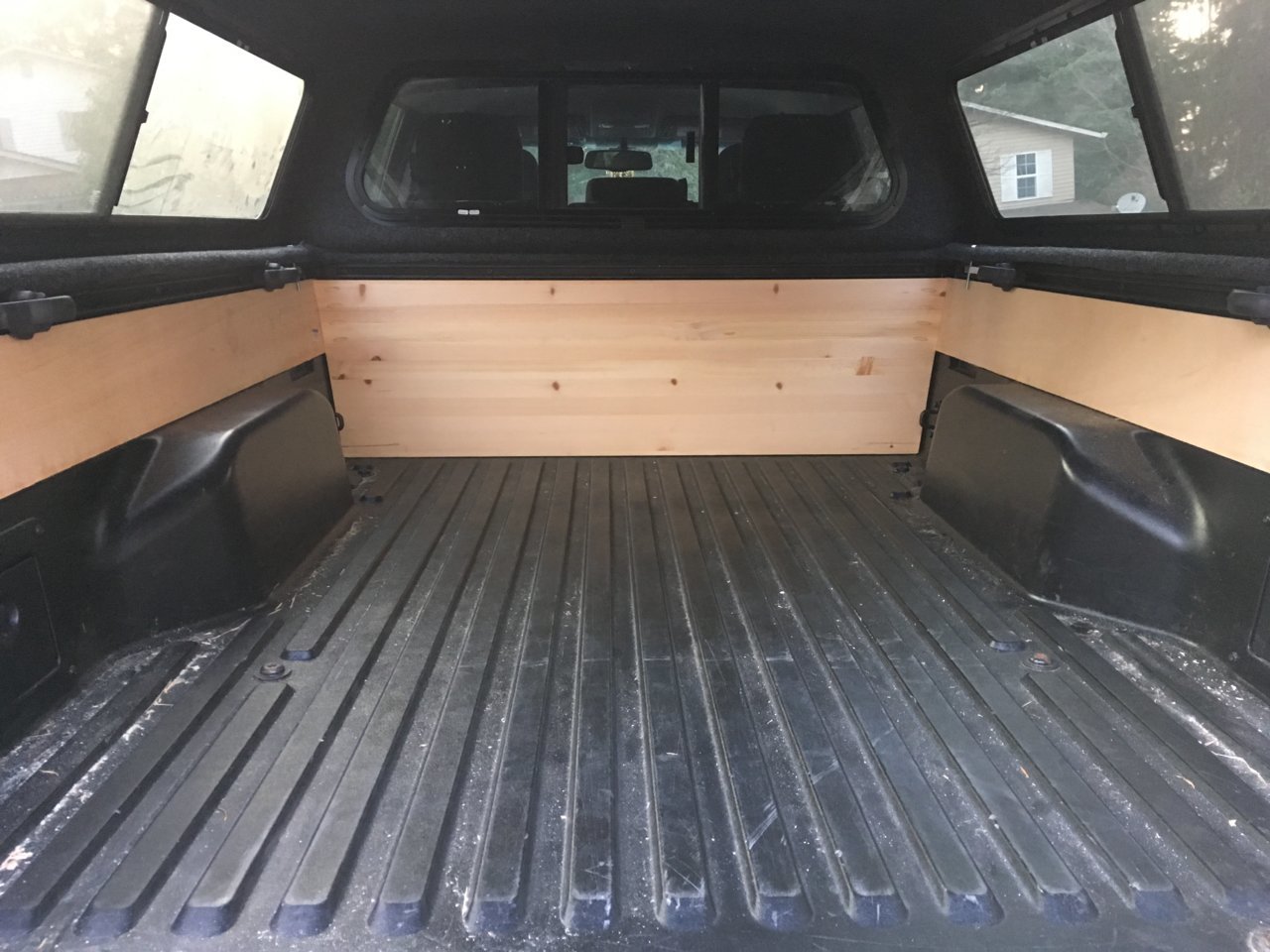

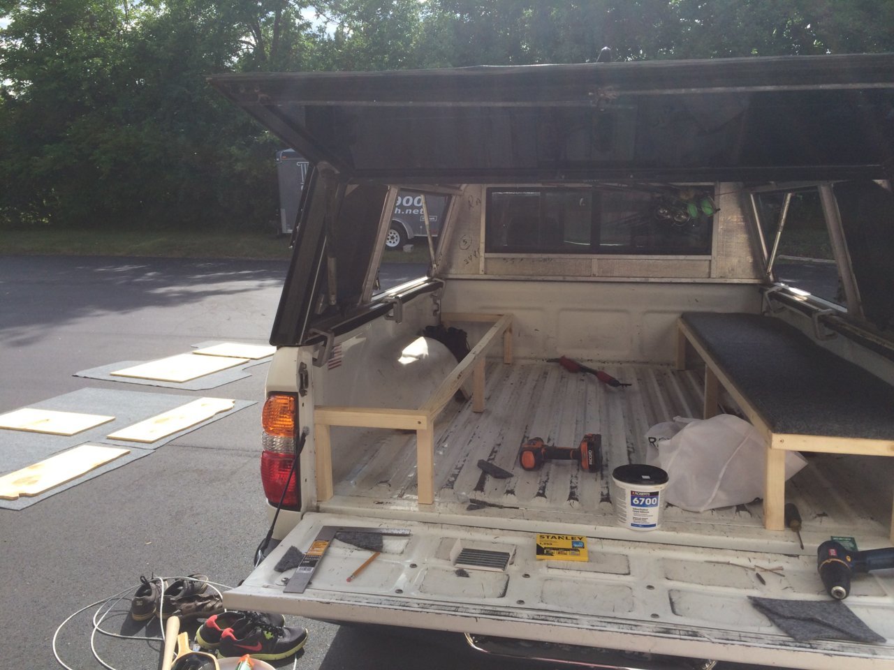

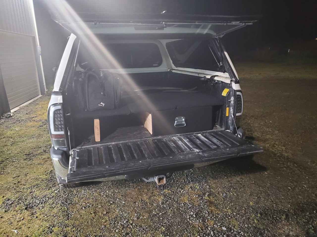

    After scrolling through a ton of pages I decided to go this route:
    3/4” plywood and some supporting lumber - wrapped in outdoor carpet. :thumbsup:

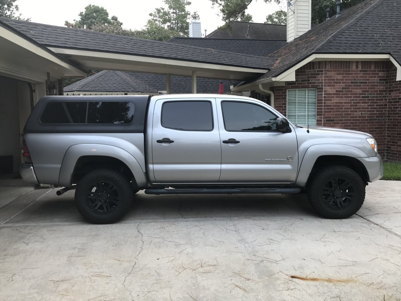

    Here is my solution. Though if I’m navigating some steep inclines it’s admittedly not the perfect option.A34026C1-B0CA-49B9-8F60-1CBB7EE99749.jpg

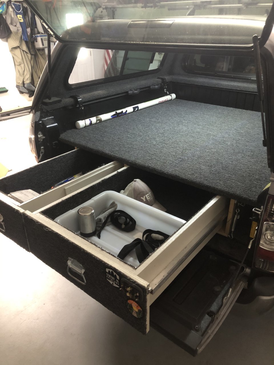

    Also will repost pics of my system. Which I have had for over 2 years now. Built custom back and side boards and connected via pocket screws. This serves to secure the removable main box which consists of a large main compartment in the back with a hinged lid and two drawer compartments up front. One compartment holds two drawers. The bottom drawer has an integrated pull out table. The second compartment was built for a drawer but it holds two collapsible crates which have served me well. No complaints, minor upgrades coming, but it’s been a good design.

    How is this design working? This is what I want to do, I’d like to put my cooler down in the drawer when I’m out wheeling, that’s what broke my current platform l, having that weight bounce around on top.

    This is amazing! About how much did it cost to build? I am looking to upgrade my setup...

    Total Cost 2 years ago was less than 300 but approximately 85 of that was for six drawer slides. I have a materials list and plans with all specs if you have a long bed and are interested. I had hoped to post the build last year but health and work got in the way.

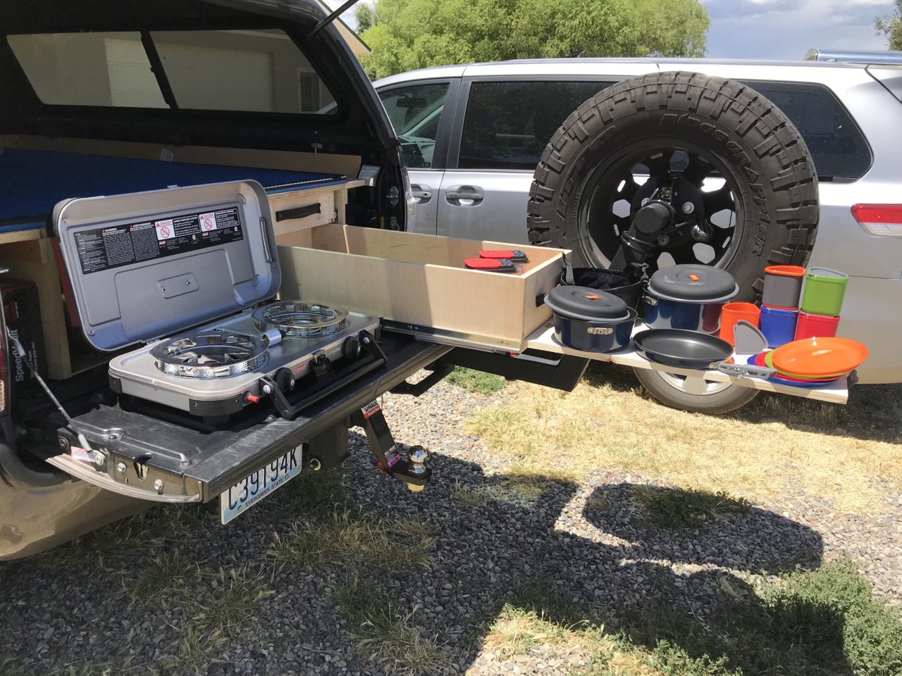

    Zactaco, sorry for the late response! I appreciate the compliments, the setup is still working really well for me. I honestly wouldn't really change anything. 90% of the time I have it in full-platform-mode. Sometimes I'll be rolling around with it half-open, and very rarely I need to pull the whole thing out. Sometimes, when I have both platforms stacked on the right side and I'm driving off-road, the braces will jump out of their slots. It's only happened a couple times, and isn't a big deal to me. If I was doing that more often, I might come up with a way to secure the braces in to the slots. Even just a nail through the end of them that inserts in to a whole in the bed plastic would work I think. I bought a long, shallow storage tote to keep things under the platform, and have been loving the simplicity/adaptability. Good luck man!
