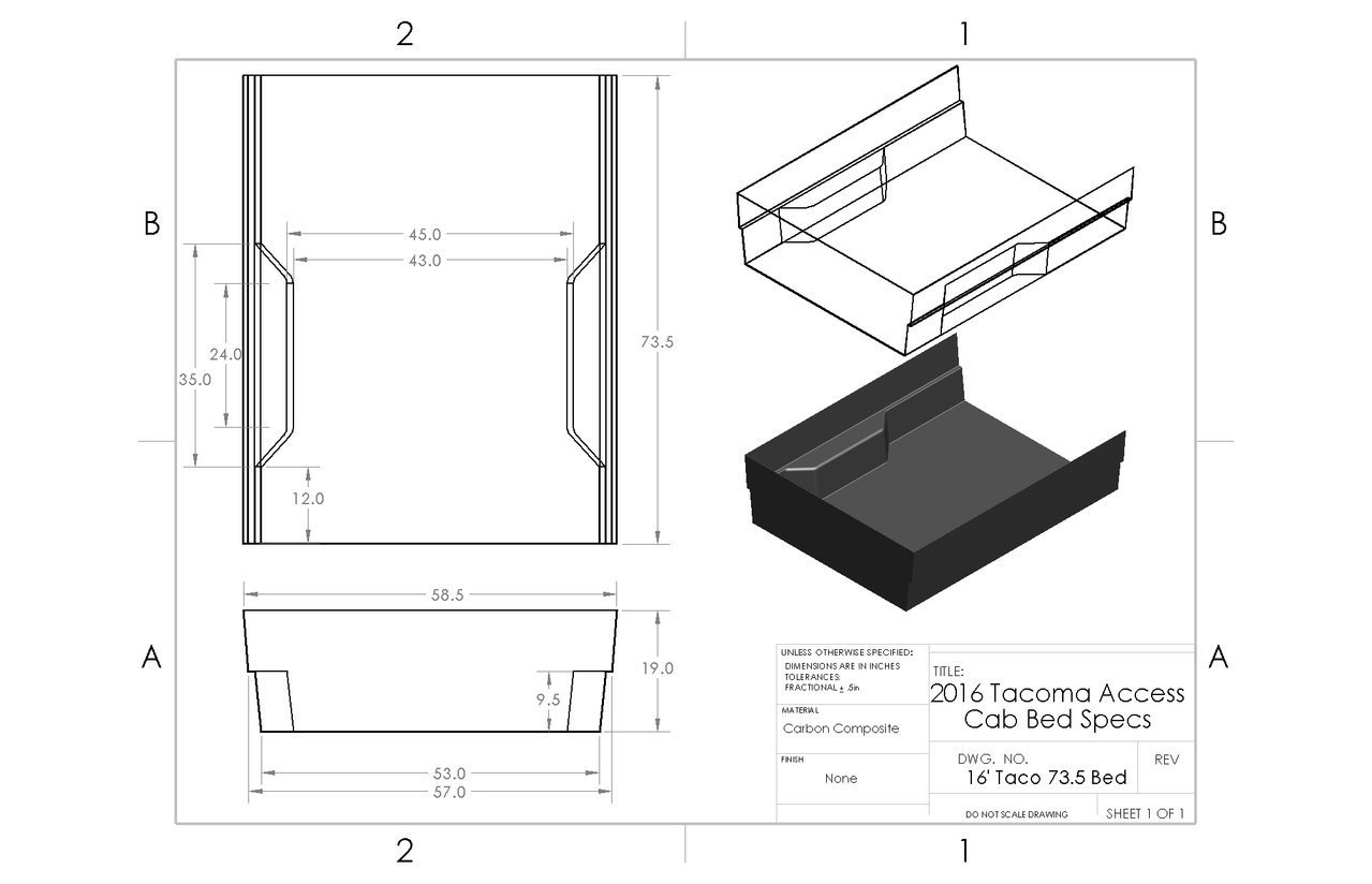

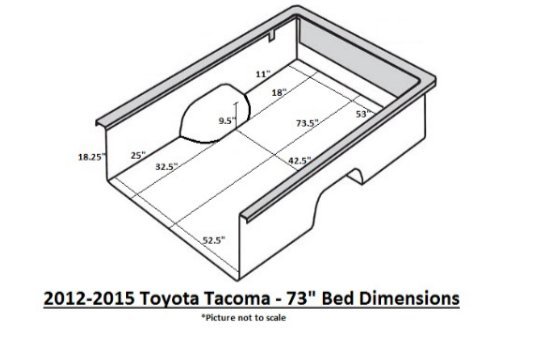

    Does anyone have dimensions of the gen 2 bed, or know where I can find them? Trying to plan my build but don't have the truck with me...

    I saw someone post 3d dimensions up here a couple weeks ago. Probably find it with a search pretty easily

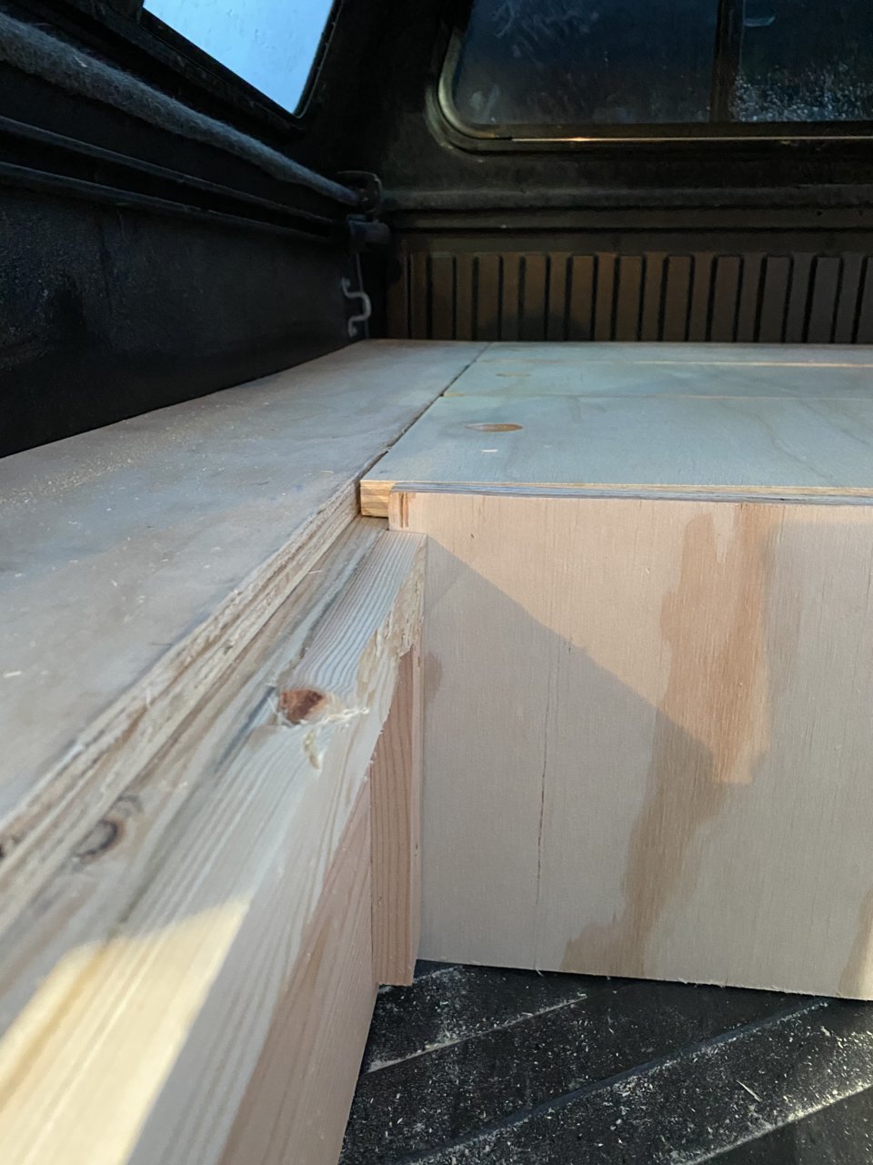

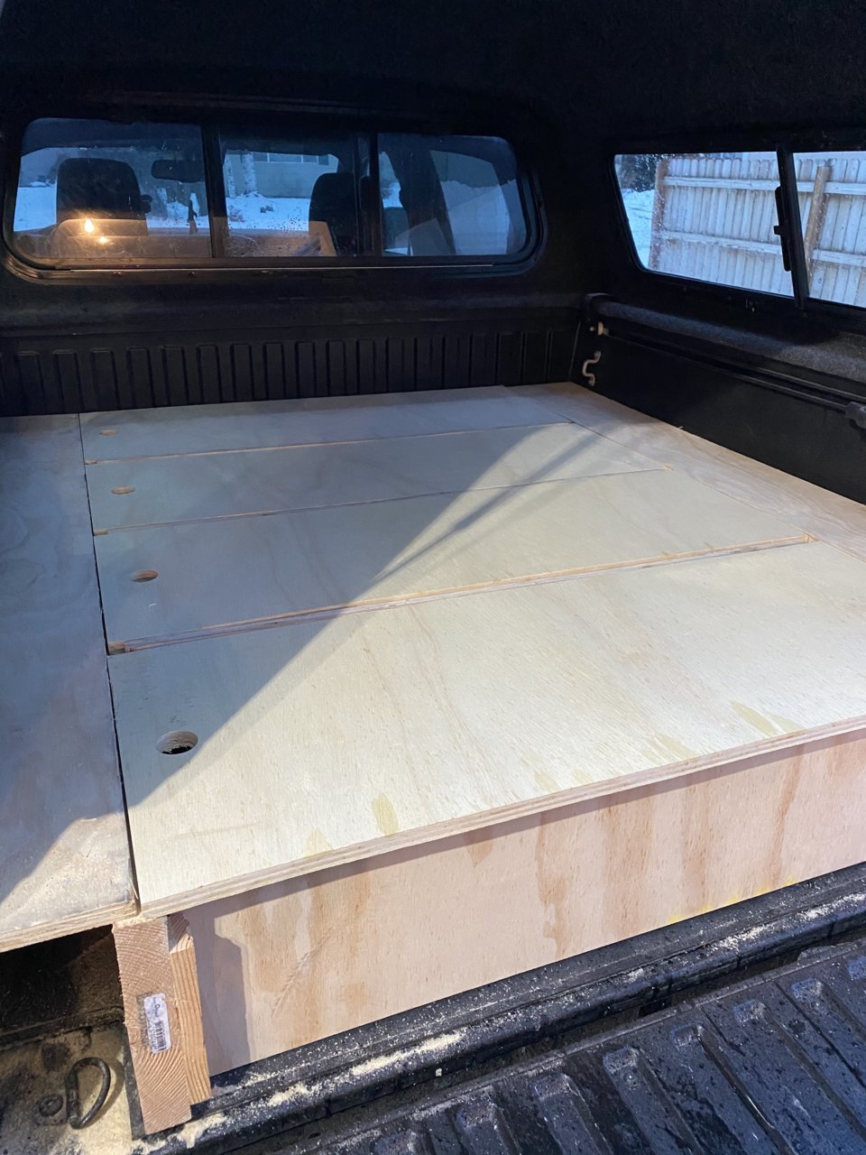

    I redid some stuff today. Made the dividers taller so the top pieces are more “locked” in. Also drilled some holes to make it easier to remove them. Still more work to do. Some waterproof paint or varnish and then carpet or rubber.
