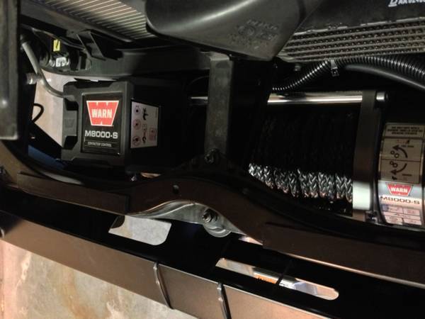

    Heres my setup. Nothing too fancy.
    Warn M8000S with Viking off road 250 series fairlead.
    Had to cut the mounting bracket and re-weld it a little further back to get the contactor to fit behind the bumper.
    2 step black anodized. Super smooth ;)

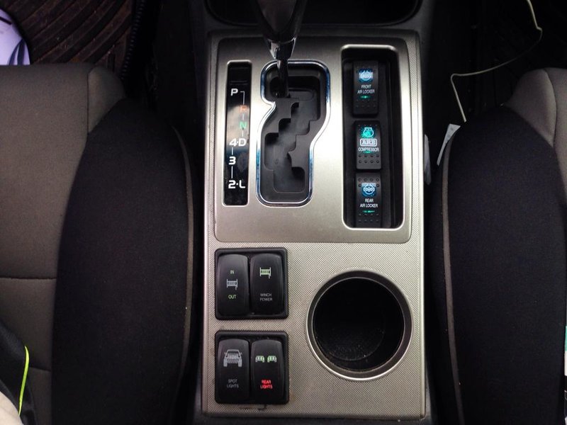

    as promised: pics!
    Jaysjammin and Pirhett like this.

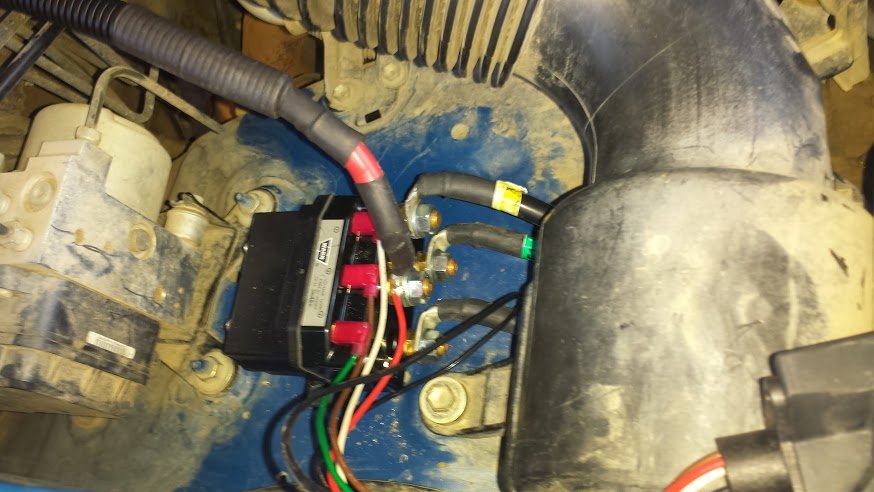

    Looks great David. Did you happen to take any pics of how you spliced into the solenoid wires for your in-cab controls? Looking to do the same thing on mine eventually.

    Do you have on and off switch for your winch so someone does not purposely start playing with the buttons?

    Correct! Switch on the left is the power on/off, which feeds the switch on the right. The switch on the right is a momentary ON-OFF-ON switch, so push up and it spools the winch in, push down and the winch spools out.
    I posted a rough write-up in my build thread HERE.
