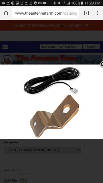

    Hey great install! What radio are you running and do you have pics of mounting location. Also does the attached look correct? How long wire did you need.
    Thanks !

    Yep. That's the one. I used the whole length of wire and just wadded up a few feet I didn't use. Good luck.

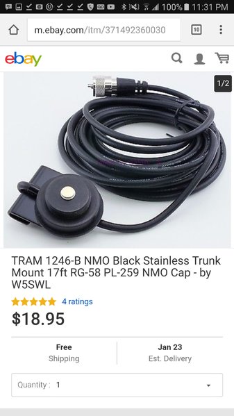

    What do you think of this version compared to the path you took. Also is your radio a detachable faceplate or attached. Just looking at ideas for mounting
    Thanks

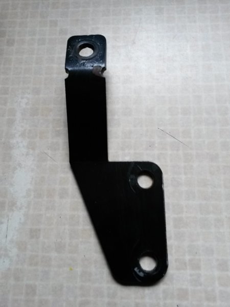

    I have an extra mount kicking around that bolts to the driver's side hood hinge.
    It can also be used for ditch lights.
    Not sure if it fits a 3rd Gen. I'll check.

    I've seen some pics on here using those lip mounts. I believe they work fine. I have never used one.

    Do you still have this? Please let me know - this is exactly what i have been looking for.

    Post is over 2 years old...
