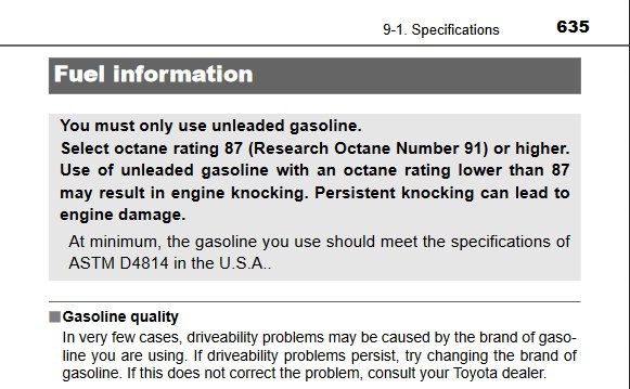

    Page 635 of the owners manual says 87 is fine...so the truck should run correctly on regular gas. It doesn't matter which brand I use or which station I get it from, it stumbles on every tank. So I'm just doing what the manual says and consulting my Toyota dealer.

    Smart... my truck performs NO differently on various octane fuels. Just note that Toyota recommends using TopTier brands only.

    I get it, and I'm not denying that your truck SHOULD run just fine on regular gas. It's a midsized pickup, not a sports car... however, many have reported symptoms such as these disappearing with premium fuel myself included. OVTune also has eradicated this issue for several folks
