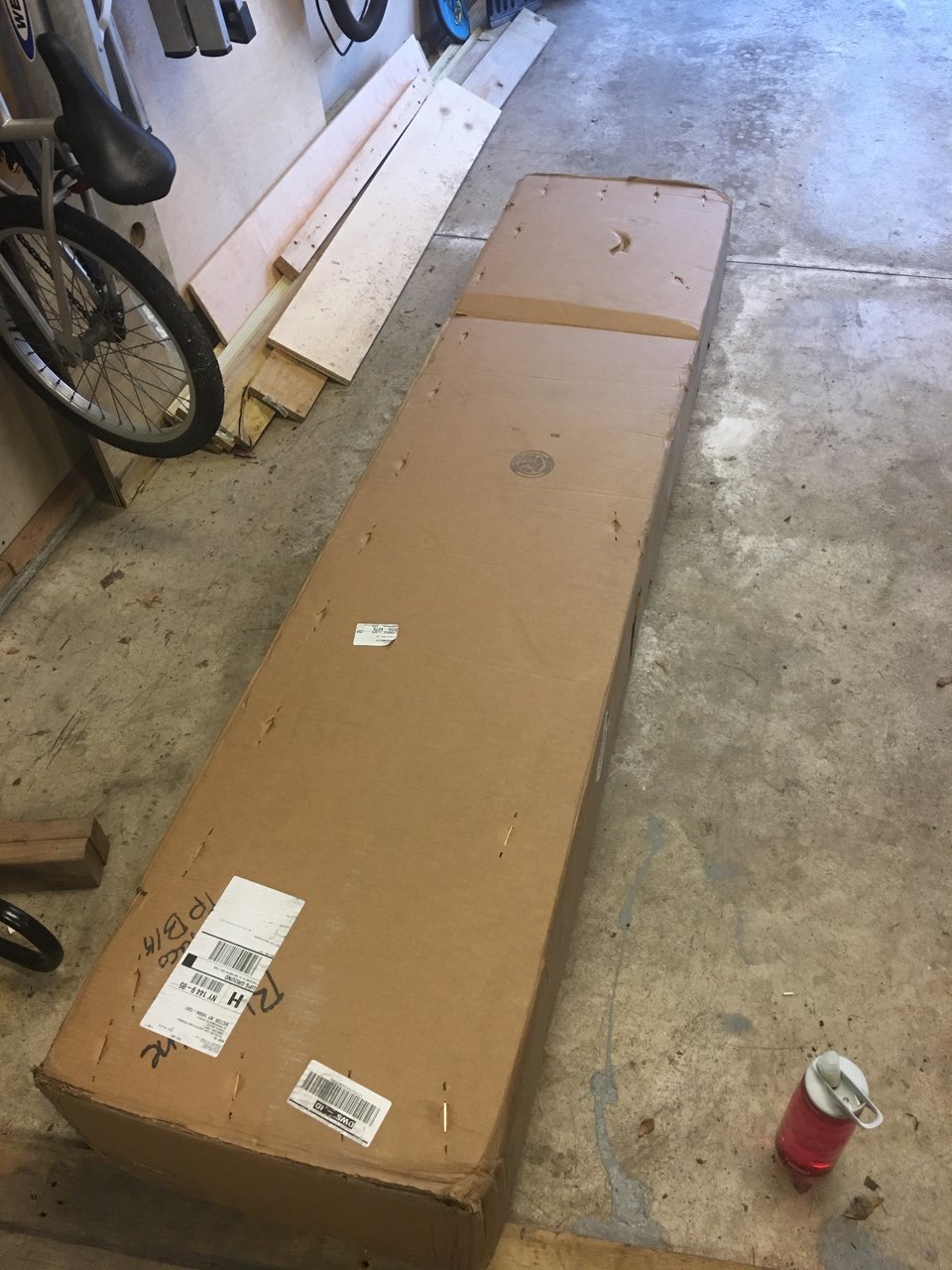

    I have been kicking around the idea of getting some rock sliders for a while now.
    My criteria:
    • To be used as a step (Have a vertically challenged wife and 2 young children which is an issue seeing that my truck is lifted almost 3").
    • Come painted / powder coated. I don't have time to do it myself.
    • Be a good value.
    • Be bolt on with a pretty easy install.
    • Give good protection to the rocker panels (I am not a rock crawler person).
    So after looking at a ton of offerings I came across www.shrockworks.com. They sell a few different versions of sliders for the taco. I ended up ordering the version that comes straight out from the frame and had tread on them to be used as a step. I didn't order directly from shrockworks though but instead ordered from Blueline Expedition Outfitters as their shipping cost was only $99. I ordered them on March 3rd and they shipped March 7th. They arrived to my door here in NY from TX by UPS on the 12th. This was a quick turnaround in my eyes.
    I was worried about how well they would be packed but shrockworks has that covered. They were packaged very well and came to me without a scratch.
    Like most of my installs I started this at about 10:30pm and finished at 2am. I believe that you could easily get them installed in an hour if you have an extra pair of hands to help you and one key piece of knowledge that I will share in a minute. If you are doing this job by yourself like me you will need some jackstands and a jack. The rest of the tools are pretty straight forward, 3/4 socket, 3/4 crescent wrench, and a 1/2 drill bit (Yes you have to drill 4 total holes).
    The sliders attach at two different spots with two bolts a piece. Most of the instructions are straight forward but one part was confusing for me. On the front support of the slider you have to remove a cover from a hole that is in the boxed area of the frame rail. This was easy but I couldn't figure out how I was suppose to get the two washers and nut on the back of the bolt for the support seeing that the frame rail is boxed in there. So I had to email shrockworks who got back to me very quickly and explained to me that you have to slide your hand into the boxed area of the frame about a foot back from the hole to reach that area. Once I had the info I was good to go.
    So far I am very happy with them. The fit and finish was great!
