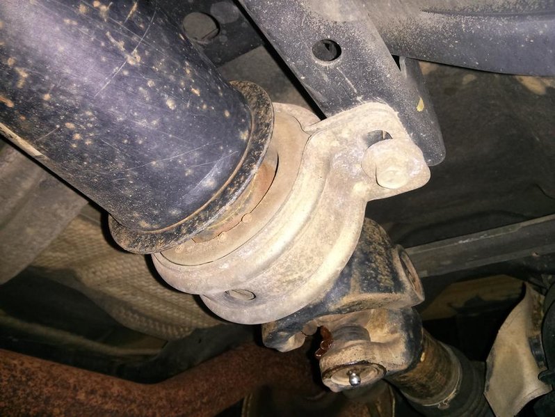

    I'm admittedly pretty weak in my Toyota tech with this "new" Tacoma. I knew my '86 like the back of my hand, but I haven't gotten into this one quite as much yet.
    The drive shaft looked to have two segments - one fore and one aft of what I believe was the center support bearing (that had a hanger and a rubber shroud or bushing). That center support was moving a LOT, but I didn't realize it needed to be more snug than that. My guess is that it was moving about 1/2" or more when I messed with it last night. The U-joints on that segment of the shaft seemed to be solid from what I could tell. Again, I have yet to get under the rear segment and investigate the U-joint near the rear diff.

    Definitely not the U-Joints, bro. I'll have to try something else. I shook and twisted the drive shaft (front and back segments) and there didn't seem to be any movement at the U-Joints. However, the drive shaft moves a LOT inside that middle bracket (see photo). Its probably moving about 1/8" - 1/4" when I push on it. Is that normal?
