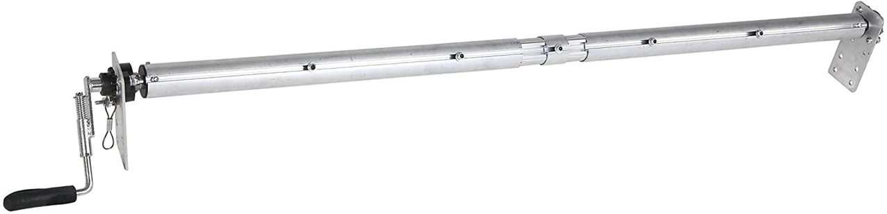

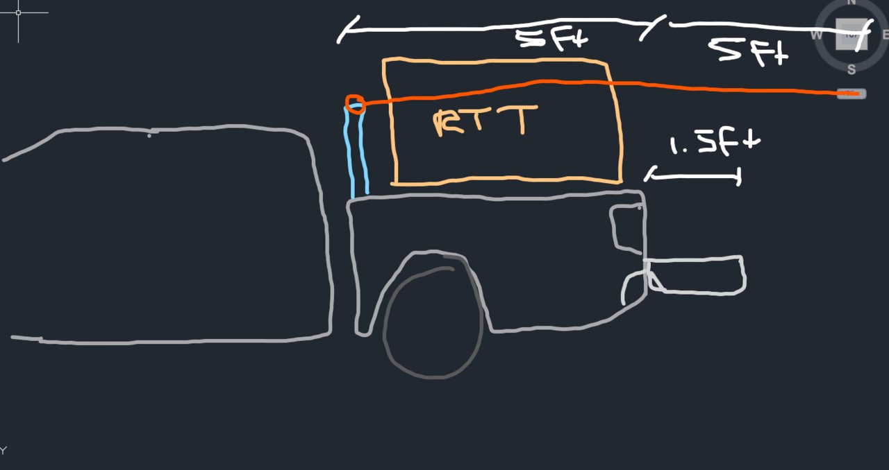

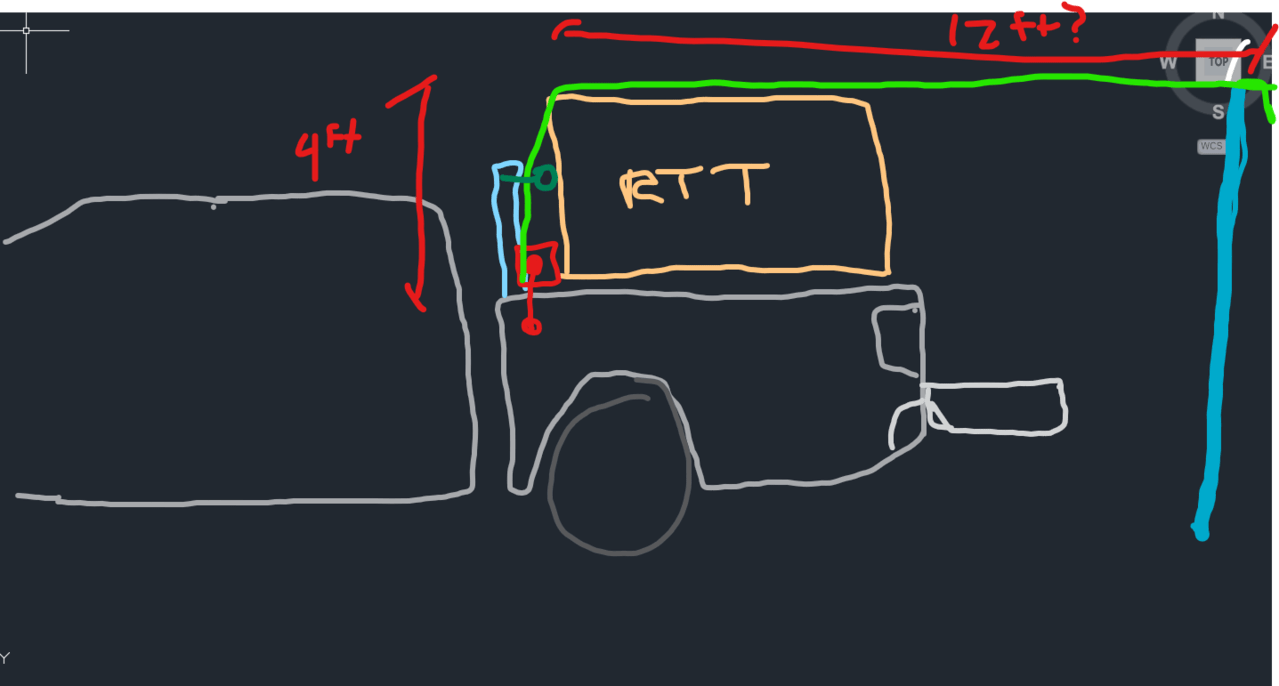

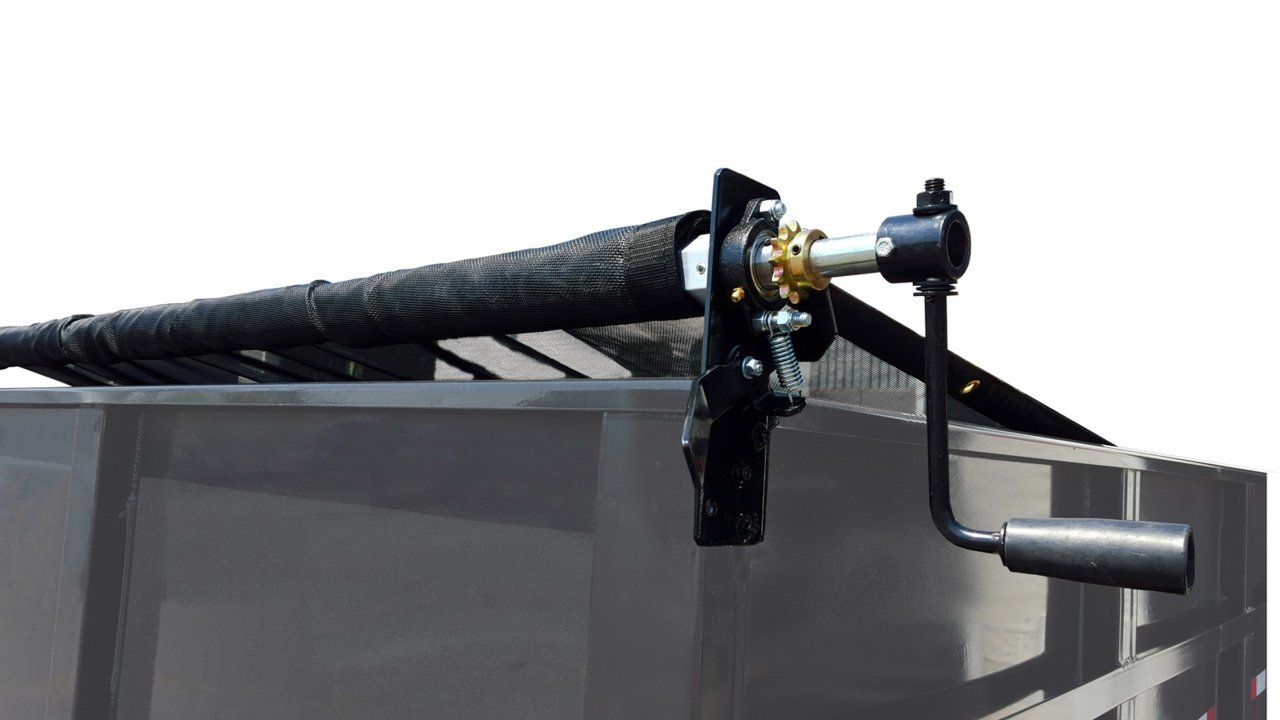

    my immediate issue with that is i have a 5ft bed. backrack is less actually a small number of issues;
    1) backrack is lower than the RTT when it's deployed. so i would need to be attached to the RTT, up and over, using the frame of the RTT as a way to keep things steady. (which i'm already doing ATM if i go with that tear drop idea)
    2) i would need a 16ft x 6ft tarp or some odd shape to actually get any use out of it. as i'd only have 2-3 feet past the tailgate and would like to have at least 8 feet of it.
    3) if attached to the back rack - i feel like it's gonna be a pain to put it away (unless i do some rotary/rolling tarp/ retractable tarp crank thing
    Maybe it's an idea what will work now that i think about it...
    ....An idea like the dump tarp would work... heavy as frick, but would work
    https://www.loadtrailparts.com/products/dump-trailer-tarp-kit.html
    Every day contractor gear becomes overlanding gear.....
    https://www.amazon.ca/Mytee-Products-Manual-Roller-Trucks/dp/B07THM65T5/ref=sr_1_5?keywords=dump+tarp+roller+kit&qid=1643984330&sprefix=dump+tarp,aps,66&sr=8-5&th=1
    This could work....
    somebody and tacoma16[QUOTED] like this.

    So this might work:
    Contractor gear turned Overlanding!
    manual crank dump tarp kit.
    https://www.amazon.ca/Mytee-Products-Manual-Roller-Trucks/dp/B07THM65T5?keywords=dump+tarp+roller+kit&qid=1643984330&sprefix=dump+tarp,aps,66&sr=8-5&th=1&tag=amazonquery-20
    Can bolt onto the base of the backrack and have it go up and over.
    Could also dual use it by having it hold down and wrap the RTT/ cover it since i've been constantly strapping a tarp down over it. i could just use the same tarp to cover it over.
    somebody and tacoma16 like this.

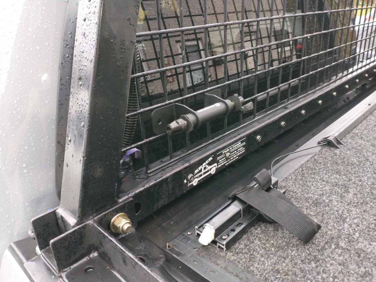

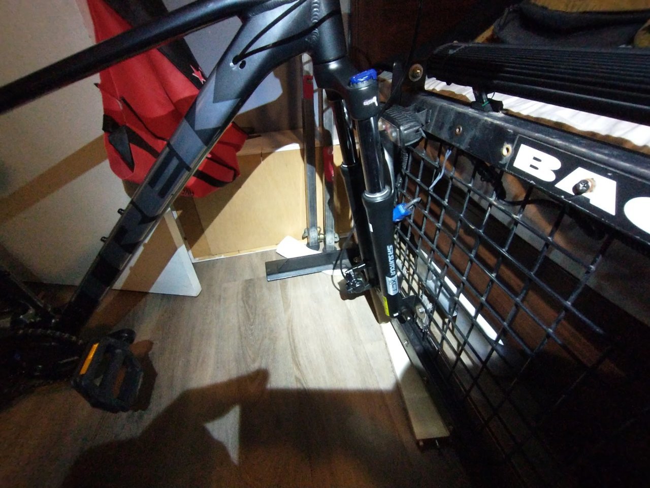

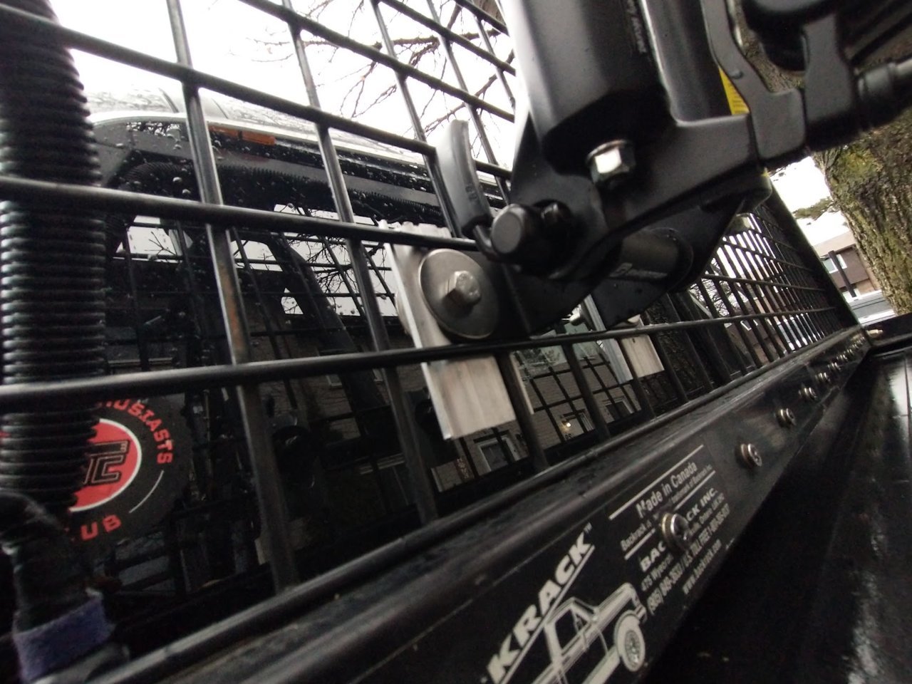

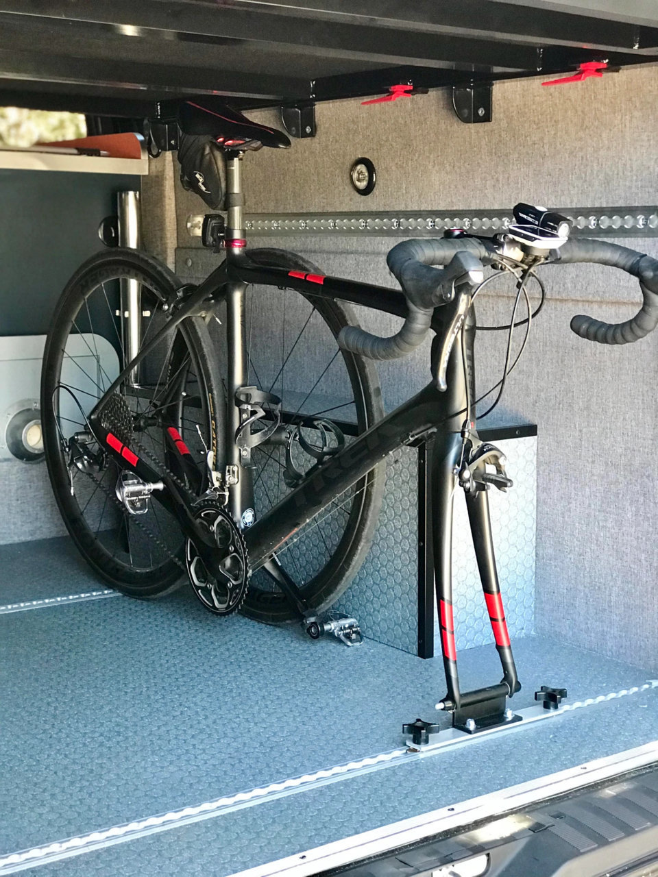

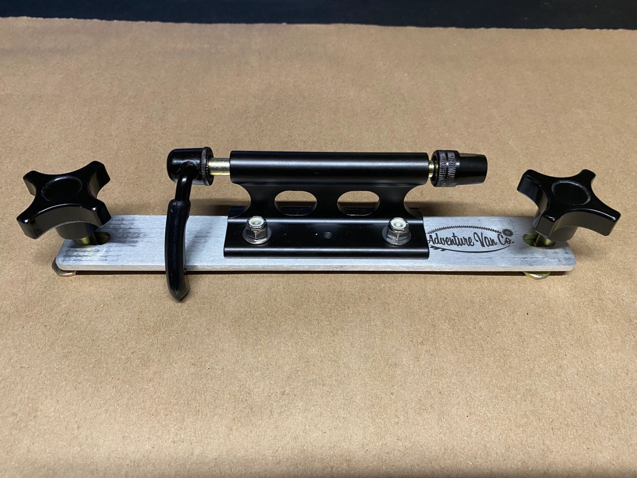

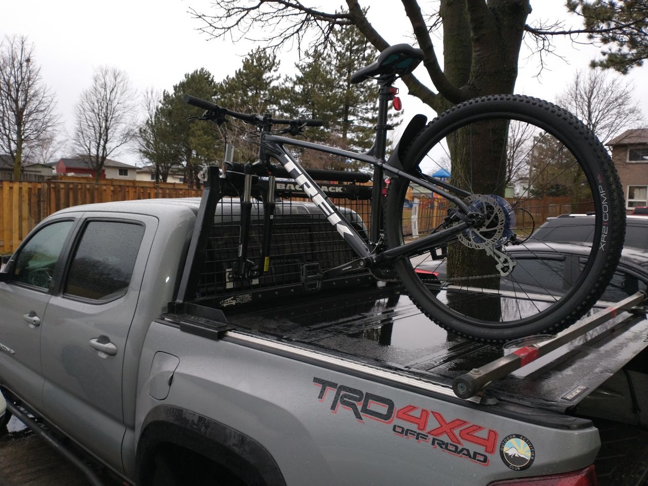

    DIY BACKRACK BIKE FORK MOUNT.
    Truck needed a bike rack, Considered getting an after market one for $200 like this Sport Rack Downshift Plus 1-bike Roof carrier and having that mounted to the bed cross bars that i have built before.
    But $200 is a stretch and i'd be a bitch to take off and on the Rack system onto the cross bars.
    Took a quick look online and found this as a DIY project; https://www.youtube.com/watch?v=QPQeCqre8pI
    However i dont have a spare front wheel axle to thread through the pipe and stumbled across this;
    https://diyadventurevanco.com/products/l-track-fork-mount
    This is basically exactly what i was looking for especially since i have added the L-Track system to the Backrack at one point in time (i since then removed it but i still have the mounts and parts to be able to mount back into the top.
    $70 but it's 90% what i'd think i needed.
    Assume the flat mount but with a bike on the top bar of the backrackbike_mount_1024x1024@2x.jpg
    Thought about it some more and gave up on the idea of using the L-Track.
    Problem is that if i have the bike forks mount to the top of the back rack, then I'm clipping the 10 foot protection bar at McDonalds or something.OOPS.jpg
    Otherwise, if i mount it to the Lower L-Track bracket on the Backrack;
    1) It jiggles
    2) i can't open the tonneau cover all the way up with the lower bracket on.
    3) i can build it for less than $70 probably.

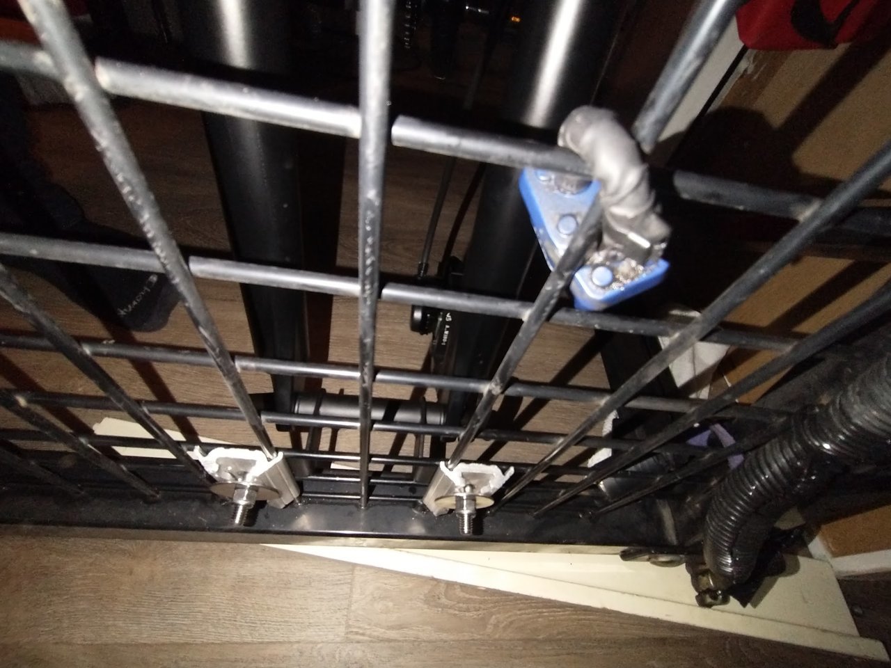

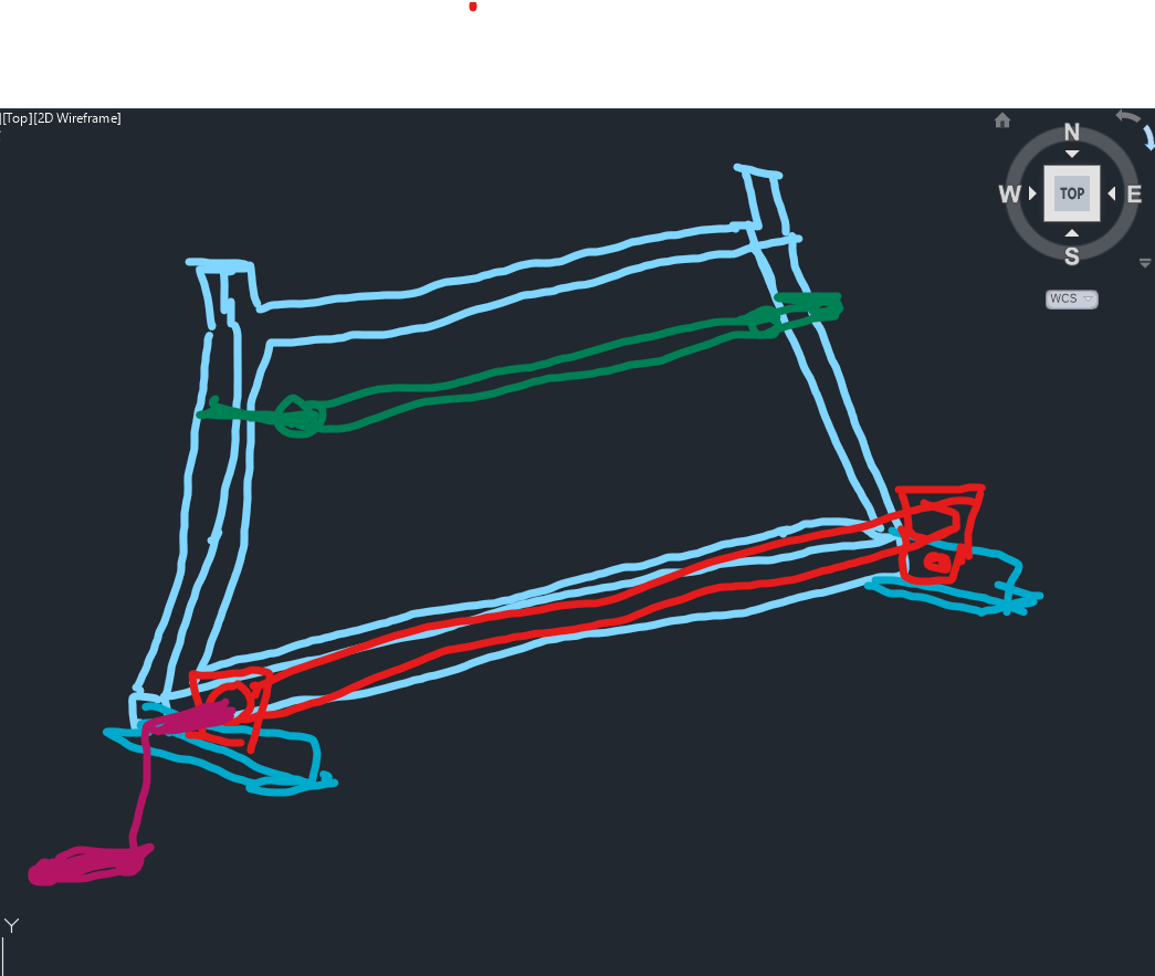

    Back to the DIY drawing board So i built one after coming up with an idea.
    First off Design Requirements;
    1) Ultra Low profile
    2) keep it Stuipid, Simple. No complicated engineering shit.
    3) Has little effect on Crossbars, willing to use 1 if needed for a tire mount.
    4) does not obstruct action of tonneau cover when bike rack/ fork mount is not in use.
    5) can also work with HoboRTT when in transport mode (folded up).

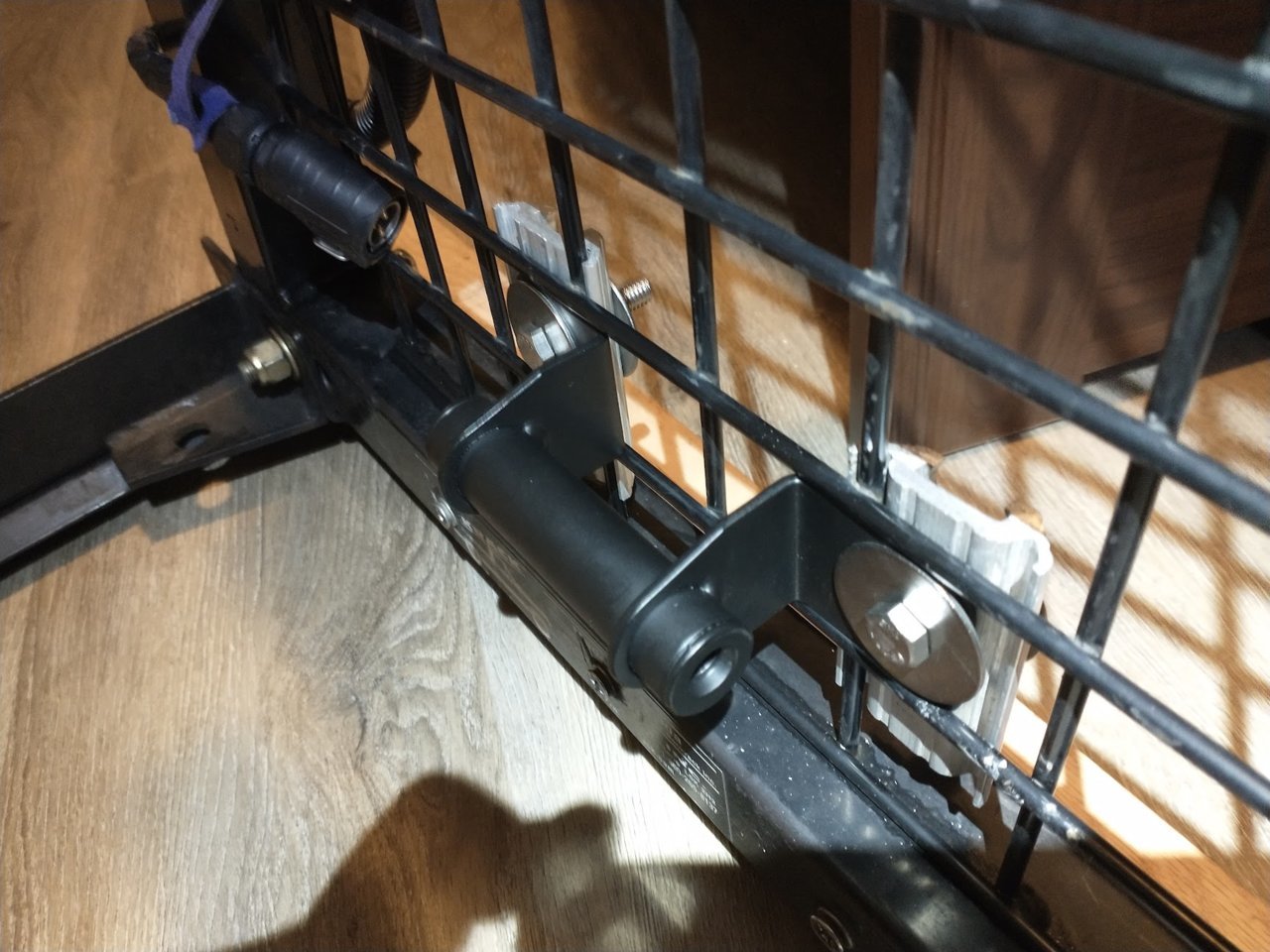

    Found $30 Fork Mounts From MEC. Could have gotten Amazoom but it's faster to just walk into the store. it's pretty sturdy.
    $20 on stainless steel bolts and other hardware (enough for a second mount, would just need another fork mount and i'
    :anonymous:
    MEC Fork mount somehow fit perfectly in between the rods of the safety rack
    Time for the Tonneau cover test...
    ... That gap...
    ..The way the L-track offcuts just hold onto the safety rack bars...
    Its perfect.
    Quick test;
    Works good.
    Live test;
    "Its frigen MINT!"
    - some Canadian or something.
    somebody, llamasmurf and tacoma16 like this.

    Man you don’t mess around. Got that bike super quick! Mounts look great!

    I got lucky with the Marlin 5 (large frame) since the marlin 6 would take - 3 to 8 weeks to show up if i were to get a large frame and 8 months for an XL Frame. and only 2 places within 50km of me had the bikes in a Large frame.
    place in Brantford sold their only Marlin 5 today
    Place in oakville had 3 Marlin 5s. 2 Blacks and one fancy pants colour Yellow Blue fade.
    all 3 sold today as well. I was one of them thankfully.
    i've been saving up for a "toy" of some sort whether it to be a VR headset, rear bumper for the truck, a Bike, or whatever.
    Because of the gas hit, and the Taco'd rim chat - i might as well just get back into shape with a bike.
    Mounts feel solid, a single ratchet strap and she shouldn't move
