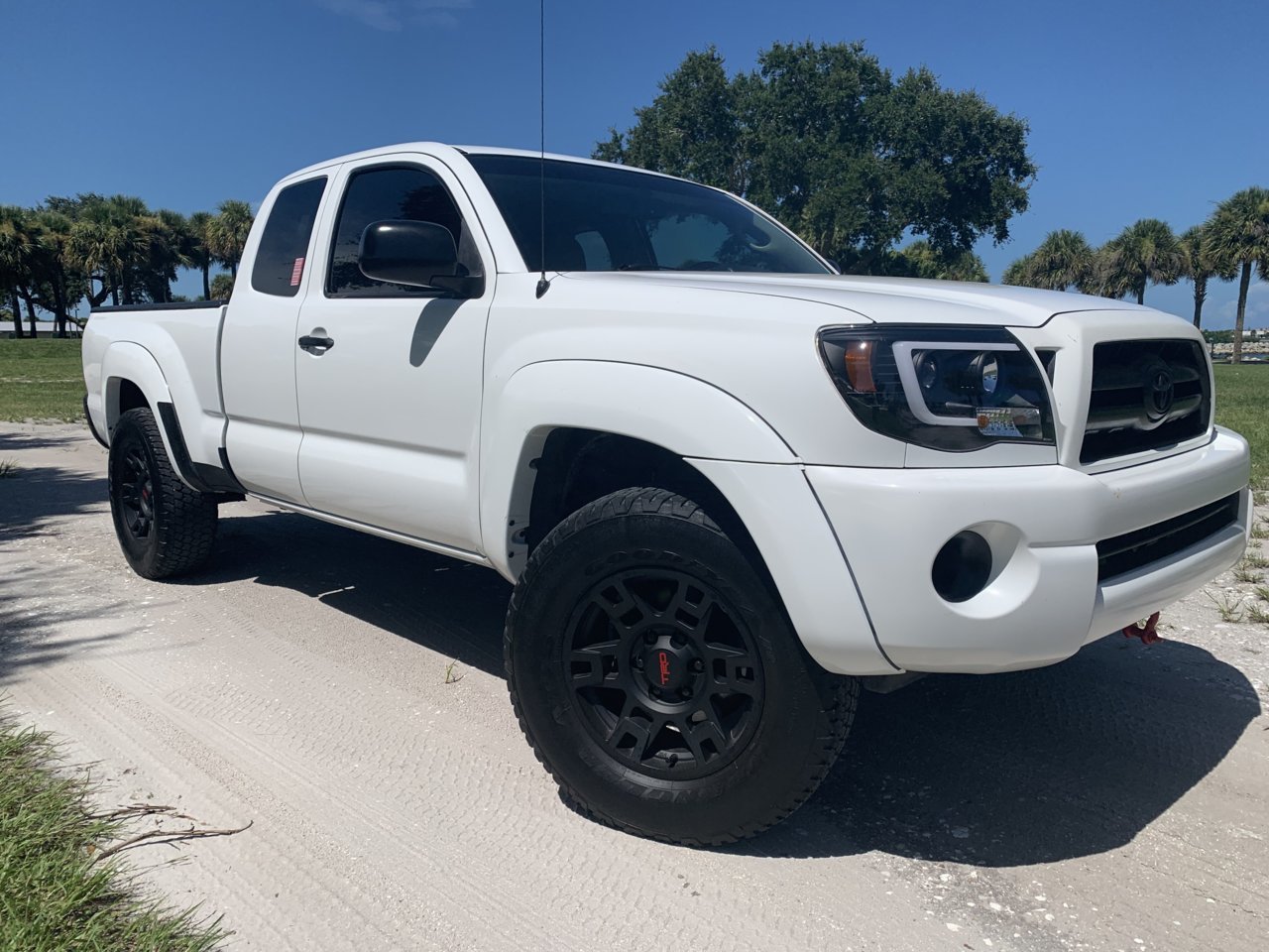

    I have a 2009 sr5 with the regular black side mirrors. I want to get new mirrors with the turn signals in them. Can i just get some that are made for a 2012-2015 sport? Will they fit?...i know i will have to run the wires, but im wondering if they will bolt right on. The mirrors with turn signals apparently were not factory until 2012...but the doors are the same are they not? Been looking on rockauto and they are pretty inexpensive. I also want to color match them super white, but that wont be an issue. Anyone done this upgrade to their pre 2012 tacoma?

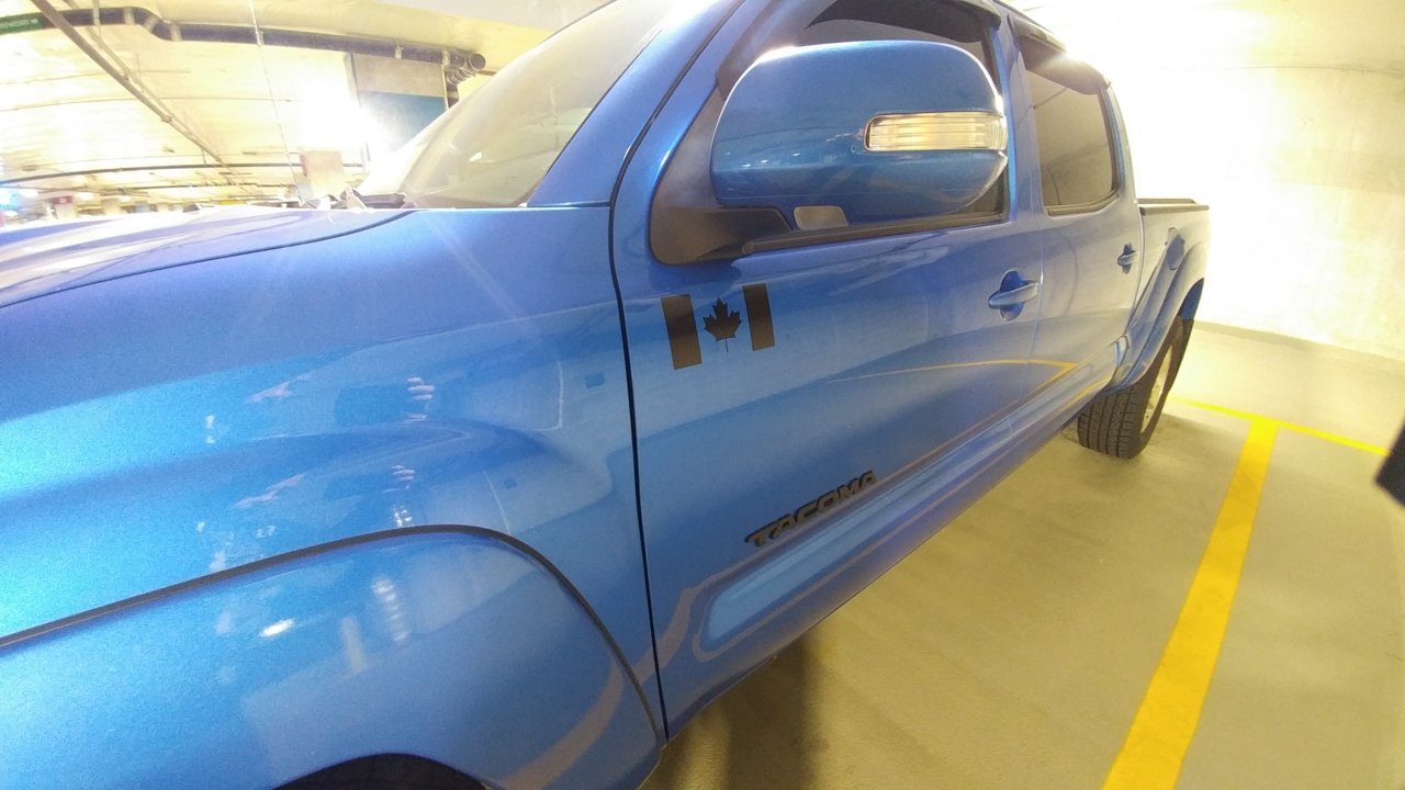

    redz80
    redz80 Well-Known Member
    Mar 21, 2010
    #33649
    298
    Brampton, ON
    Tacoma SR5 TRD 4x4 SWB
    SpeedwayTaco160 and LAMCKMA007 like this.

  15. Aug 26, 2019 at 2:08 PM
    redz80
    Mar 21, 2010
    #33649
    298
    Brampton, ON
    I bought a set of sienna mirrors from ebay and had them painted and I mounted them to my factory mirror perch ... There is a bit of work to dissassemble and reassemble put with a bit of patients it looks like it came from the factory.... Just the way it should have in the first place! Cheers
