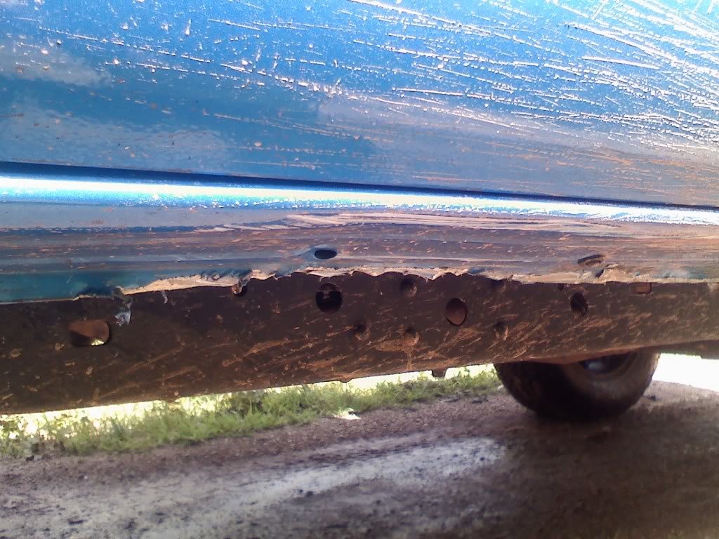

    Hey, i recently found out i have a good size dent/ gash in what i would call the side skirt area of my truck. Any good way going about fixing said problem? The worst part is i dont even know what i ran over.
    thanks in advance

    I would heat that as hot as I can with a heat gun and if the door opens get a peice of 2x4 and hammer that back down. I'm sure someone will have a better answer though

    Someone probably ran into your truck with a small dolly cart at home depot or something.

    Leave it. Haha I have one too

    It's called a rocker panel. Girls wear skirts.:boink:
    You probably got it from something that your front tire kicked up.

    holy hell.......... must of kicked up a cinder block

    I got one too. Painted the lower rocker panel with black gravel guard and it disappeared!

    If it doesn't affect the door I would just put some paint on the damaged area and hide it with some sliders like others said. Welcome to TW.

    I did that on my old Ranger. I just opened the door and smacked it flat with a rubber mallet then sanded and painted it to prevent rust and left it.

    Did you have the truck serviced at a shop lately? The damage could have been caused by the lift.

    Leave it and buy some sliders.. Its what I did :cool:

    that's what sliders are for guys.

    It looks like you went off road and hit something the whole rocker panel looks like it was dragged on something
