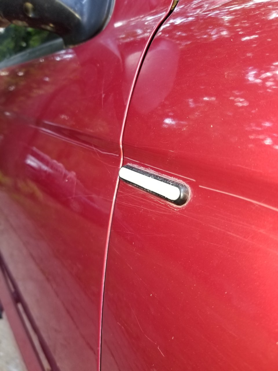

    Would you ever put an Audi side marker?
    They've been using them forever and they last 10+ years.
    would require cutting an oval-like shape in the fender though

    The Audi side markers are sturdy, but as you said the wiring comes out the back, and the shape doesn't flow or streamline well with Tacoma imo. Good recommendation tho, maybe they have a version on a different car that is more slim

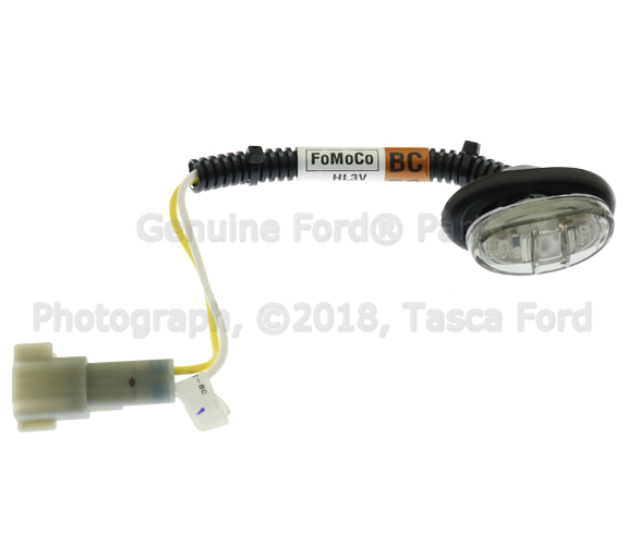

    just realized another option could be Ford Raptor side markers
    besides what they get in the grill, they also have an amber marker in the front fender leading edges
    and red markers below the tail lights

    I like the ford ones, based on the idea, they are made for outside
    Are they made for external mounting?
    Edit, I found them. They look good

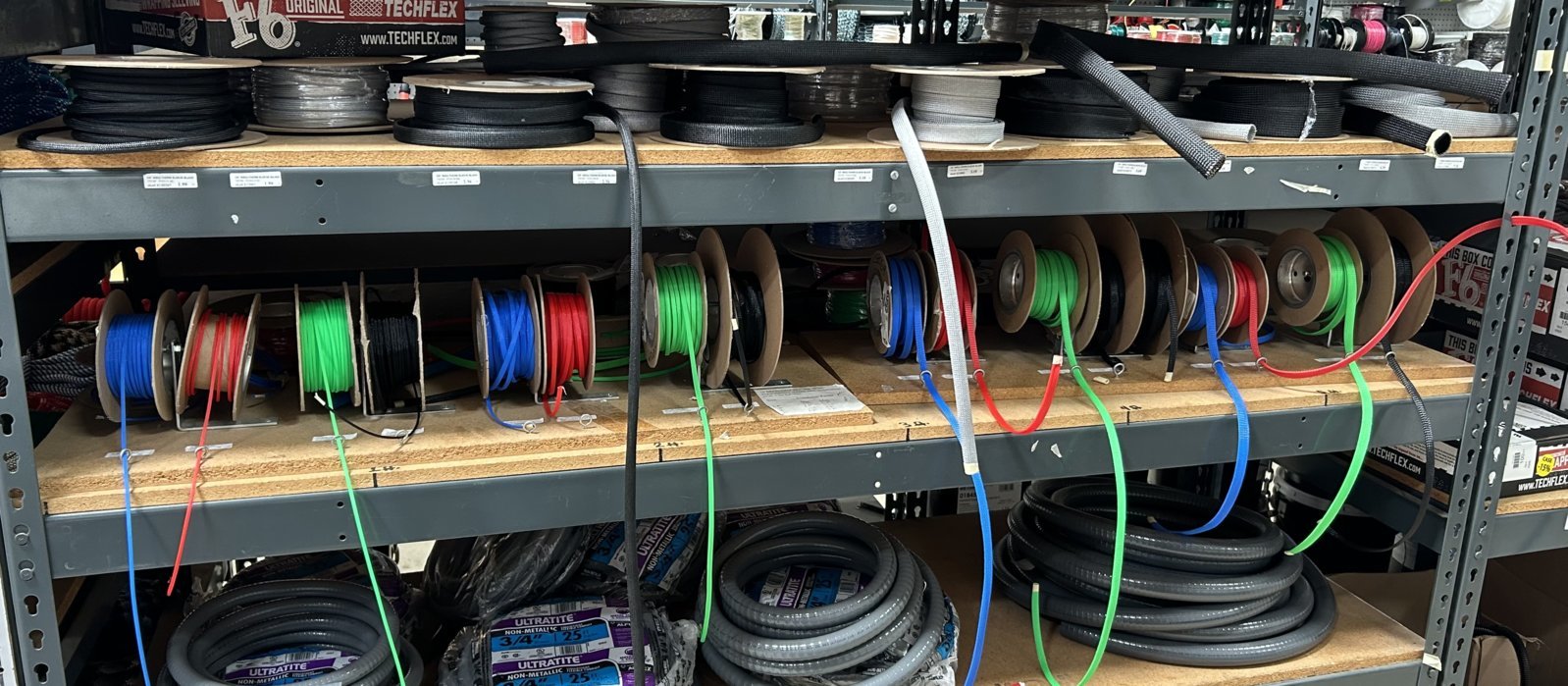

    just need to check if I have 1/4 split conduit
    Or get some
    or pick braided instead. As 1/4 is much bigger than 2 wires.
    Hardware store has a bunch of braided sheathing that would be slicker, in either 1/4 that looks like it would barely fit 2 wires. Or bigger next size up I think is 3/8.

    where is this? almost looks like marshals lol

    7,835
    SD CA
    Marshalls the GOAT
