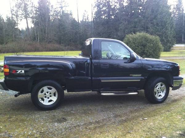

    Hey everyone. I traded in my 2004 Silverado for my 2013 Tacoma a few months back. I kept the snow tires, mounted on a set of Silverado 17" aluminum wheels.
    The Taco has the same sized tires and wonder if I should expect any issues using these wheels on the Taco?
    For looks I don't really want to be driving around for 5 months with Chevy wheels, but then it would be cheaper than buying steelies and having the tires remounted.
    What do you think? Issues with using these wheels, and aesthetic comments appreciated.
    Edit: Here is a pic of the old truck and the wheels in question:

    Have you tried to put them on the Tacoma? If they fit and do not rub, there should be on issue.

    I thought the center bore on Chevys was smaller or vice versa.

    The lug pattern is the same but if I remember correctly the hubs are different on the GM wheels.

    Yeah, iirc you can go Toyota to Chevy, but not the other way unless you have the center bore enlarged.

    Thanks for the quick replies. I was going to try to mount them but glad I asked here first.

    I know the old school toys and chevy wheels swapped with no issues at all. But with factory wheels these days, I couldn't say. But, if I were you, and had them laying around already mounted up, I would take the time to try it. The cost of even some cheap wheels and mounting is worth a little time to see if you can save some coin for something else.

    Silverado hub bore 78mm Tacoma hub bore 106mm
