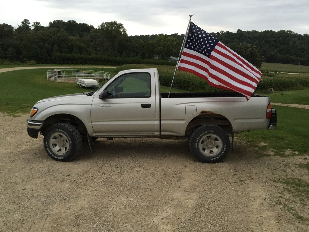

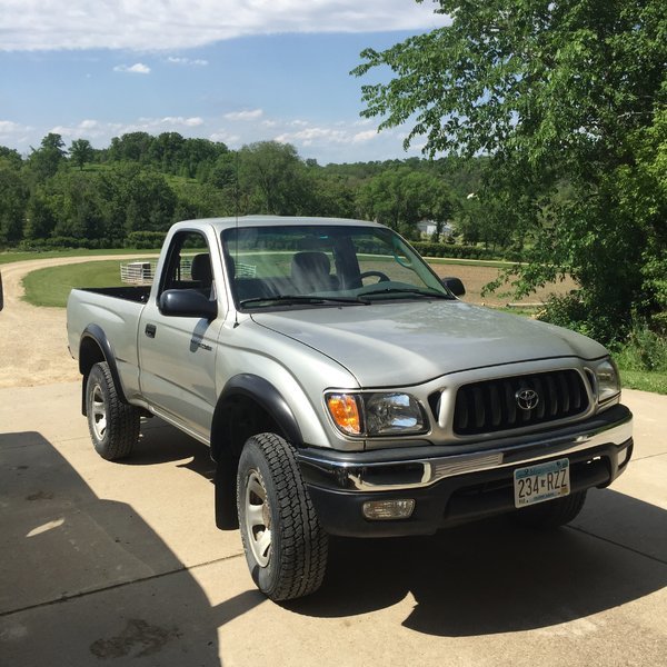

    Current Picture - 5/19/18:
    First Post-Lift Picture:
    The first picture I have... 'Merica!

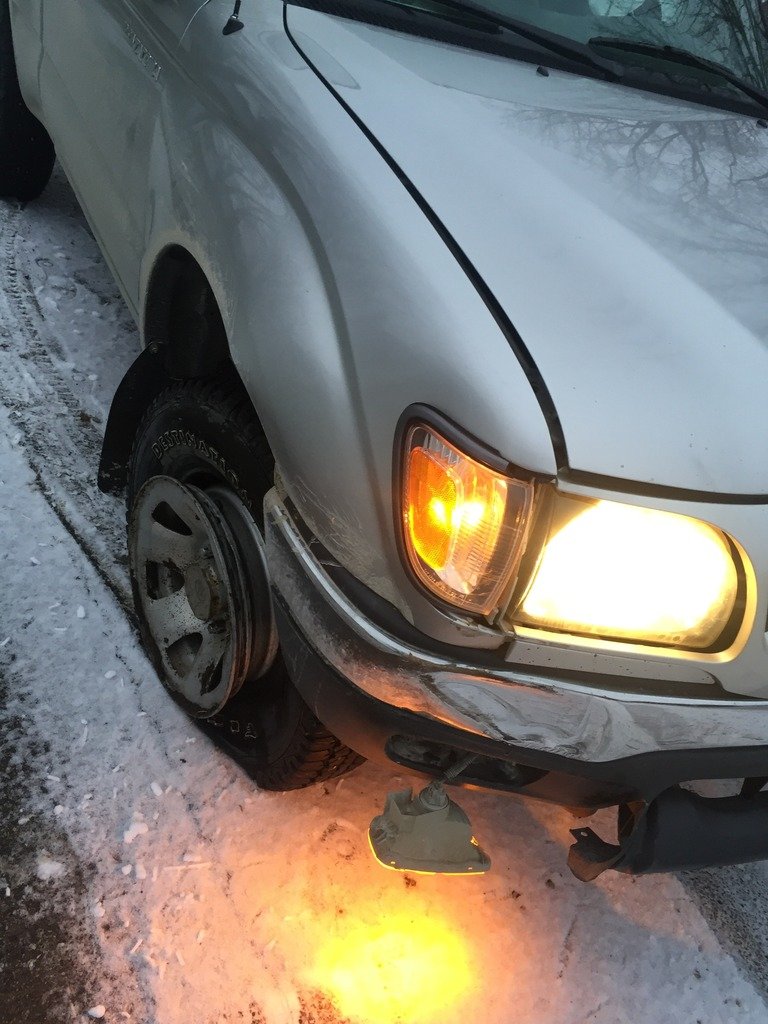

    A few months later, in December, I was involved in my first accident. I slid down an icy hill into a support cable for a telephone pole. I learned a valuable lesson, and luckily the damage was not too bad and no one was hurt.
    Soon everything was fixed (an expensive lesson), and I took the opportunity to install brand new headlights! They sure make a world of a difference!

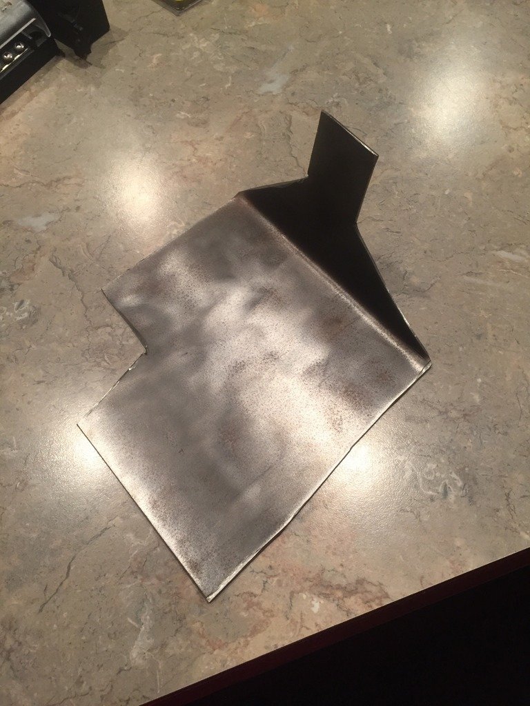

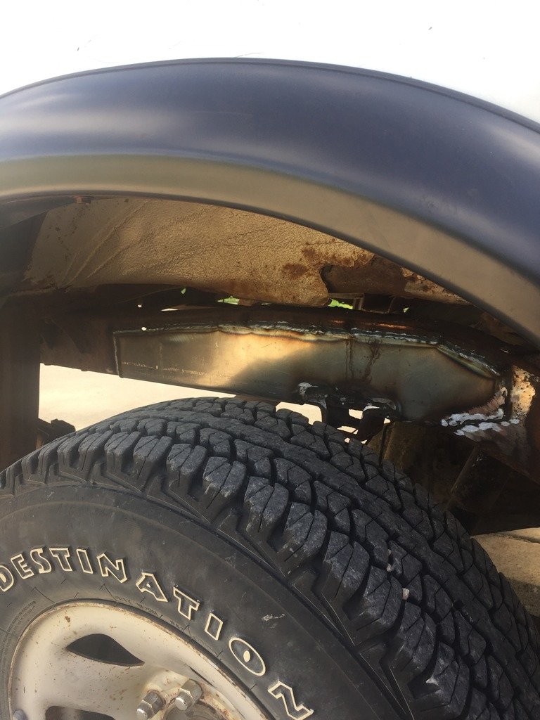

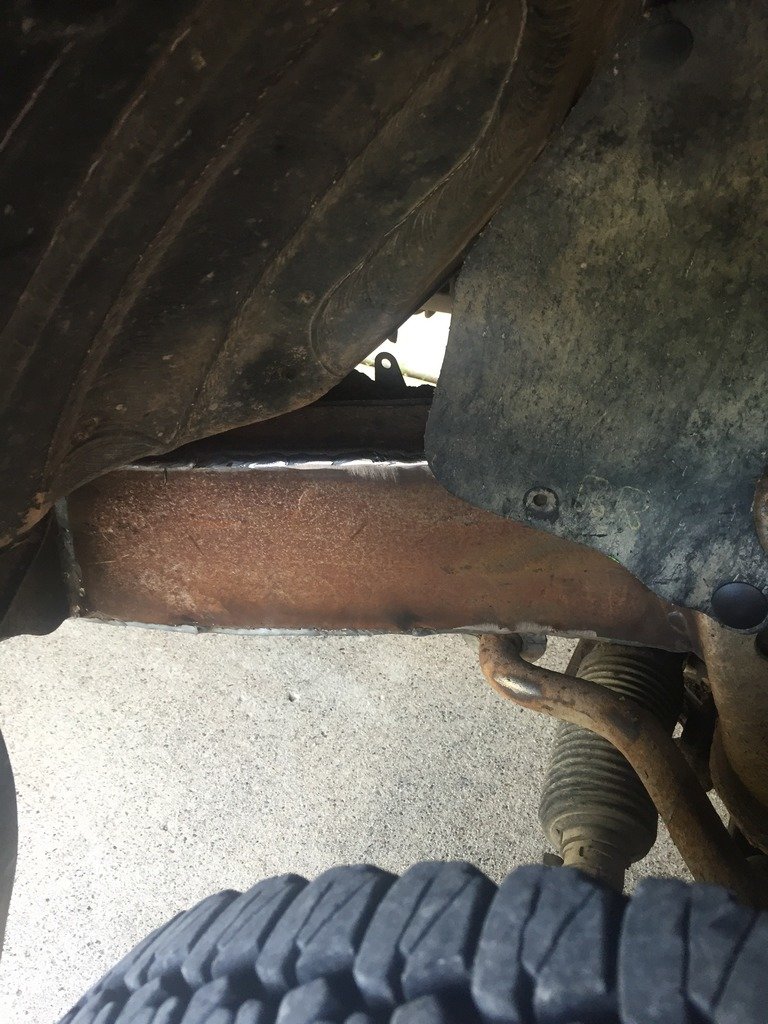

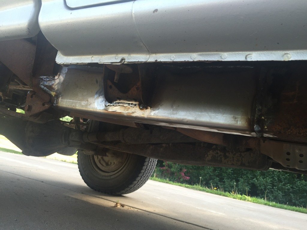

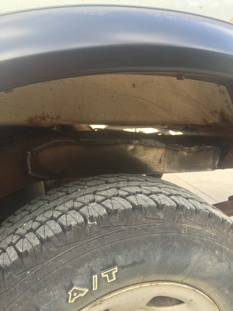

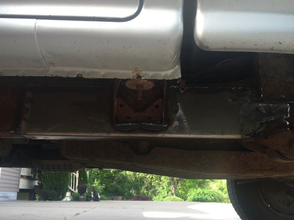

    Today I picked up my truck from a welder friend of mine who worked on the frame for me (I don't know how to weld). Since this truck has spent its whole life in the northern states, it's frame pretty much looked like Swiss cheese. My dad never takes his vehicles into the dealerships for any reason, and he wasn't even aware there was a frame recall let alone that he had to have it under coated to activate the warranty. So this is our solution for missing out. Tomorrow we will be undercoating it so it does not rust any further that it already has.
    Drivers side front
    Drivers side leaf spring area
    Drivers side rear wheel area
    Passenger side front
    Passenger side leaf spring area
    Passenger side rear wheel area
    After only a day of driving with the welded frame it's amazing how much firmer the truck feels, it must have been flexing pretty heavily before.

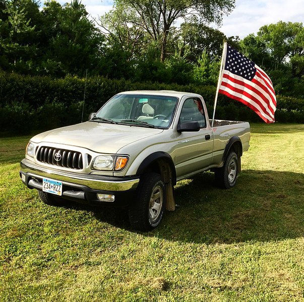

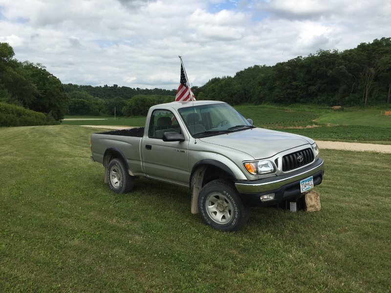

    Celebrating the 4th of July with flags and (stock) flex!

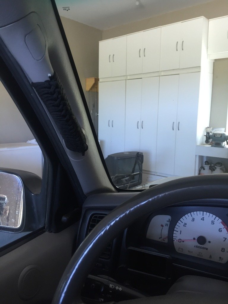

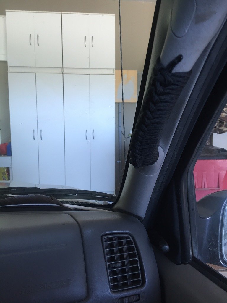

    Today I had some spare time so I wrapped my grab handles in Paracord. I like the way it looks, it's useful and adds a nice touch to my interior, not to mention a little more comfy to grab onto now! This thread has the video I followed for it, it's pretty easy to do
    https://www.tacomaworld.com/threads/paracord-oh-shit-handles-tut.408833/
    You can see where I Velcro-mounted my Ultra Guage as well.

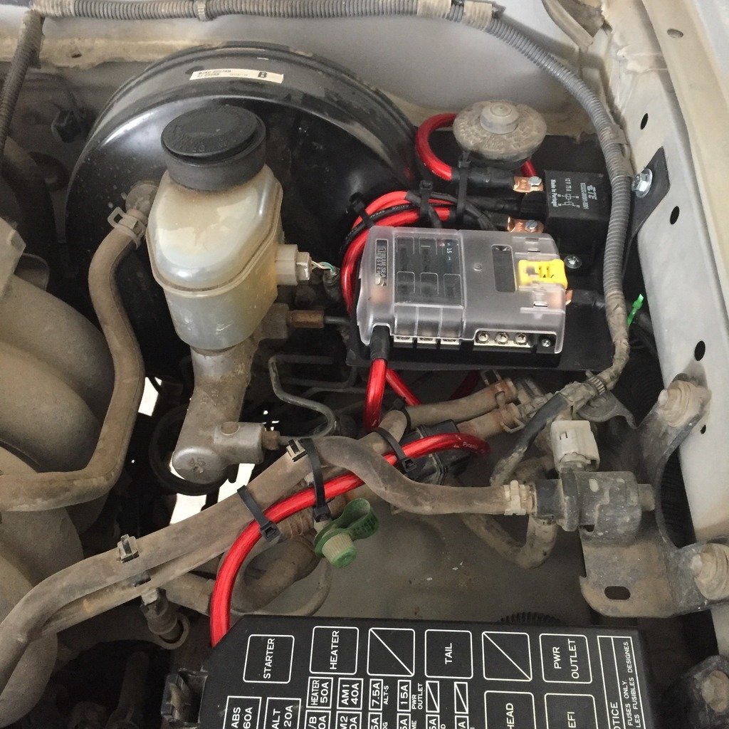

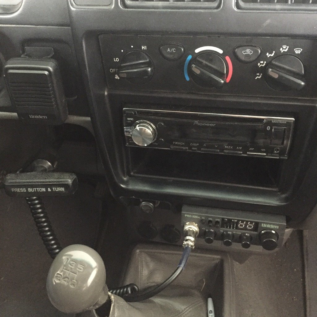

    A lot has happened in the past month as far as my truck is concerned. I completely wire wheeled and undercoated my frame, and I tried out some rust converter as well. It all appears to be working quite well (not to mention the black underside looks pretty sharp!). I don't have any pictures of the process or final result at the moment however...

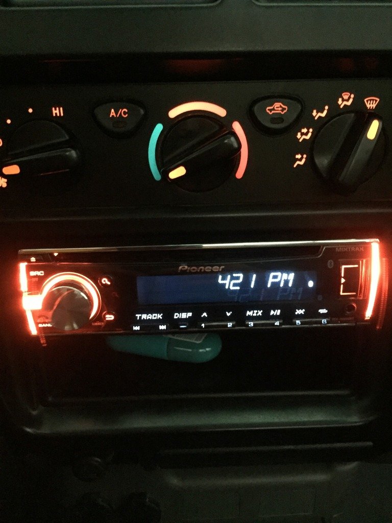

    Another mod that took place was the replacement of the radio head unit. It had already been upgraded from stock about 10 years ago for my dad, but I was looking for something a little more modern. The FlexSmart X3 Mini worked very well for the price, but my manual transmission seemed to mess up the radio signal it was putting out sometimes, making it extremely fuzzy and unpleasant to listen to. The radio I chose for the replacement was the Pioneer DEH-X6800BT. It has all the features I could ever want: Bluetooth, Radio, CD, USB, Aux, handsfree phone capabilities, as well as variable color illumination settings. My friend and I wired it up and and installed ourselves and I think it turned out great! I ended up matching the buttons to the orange color of my dash and matching the display to that of my UltraGuage. I think the contrast looks pretty good! Also, I ended up running the microphone up the driver's side A Pillar underneath the rubber, where I clipped it to the visor.

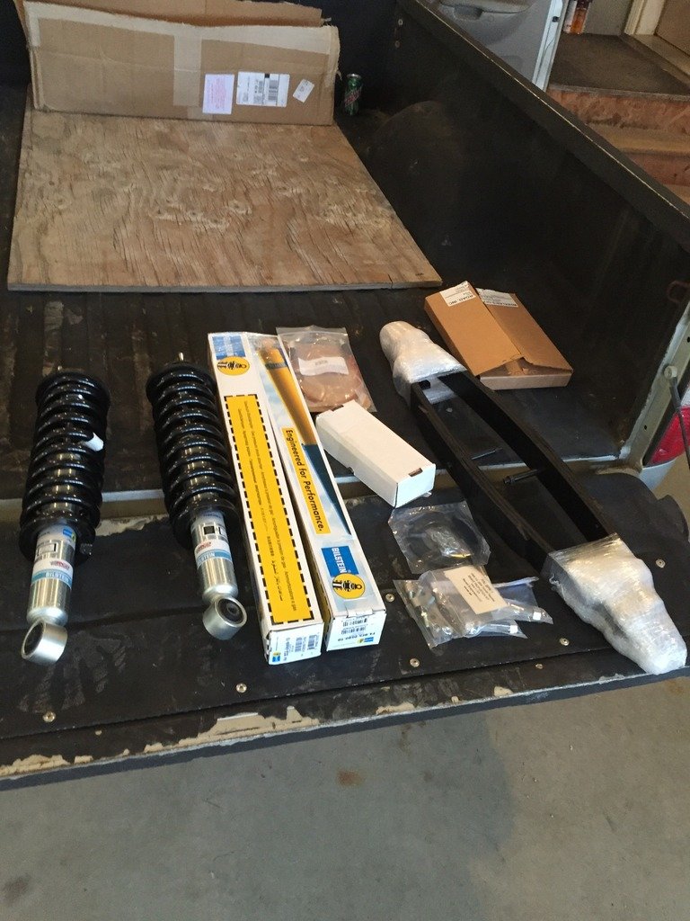

    Finally, I got around to ordering some new suspension hardware from Wheeler's Off-Road! :spy:
    I am going for about a 2" lift with all the new equipment. Dan and everyone who answered my questions on TW was very helpful throughout all my research and the buying process.
    Here's what I ended up going with:
    • OME 881 Coils
    • Front and Rear Blistein 5100s
    • New top plates, stem cushions, and washers for front shocks
    • Wheeler's Multi Leaf AAL 1.5" 3 Leaf Progressive (Includes new U-Bolts and center pins)
    • Wheeler's 4x4 Differential Drop Kit with Skid Plate Spacers
    • 2 new Lower Front Strut Mount bolts
    • 1/4" Polyurethane Top Plate Spacer (for compensation for the driver's side lean)
    • Rear Brake Proportioning Valve Relocation Kit
    • 19" Red Extended Rear Brake Line
    Next on my list: Install the Lift!

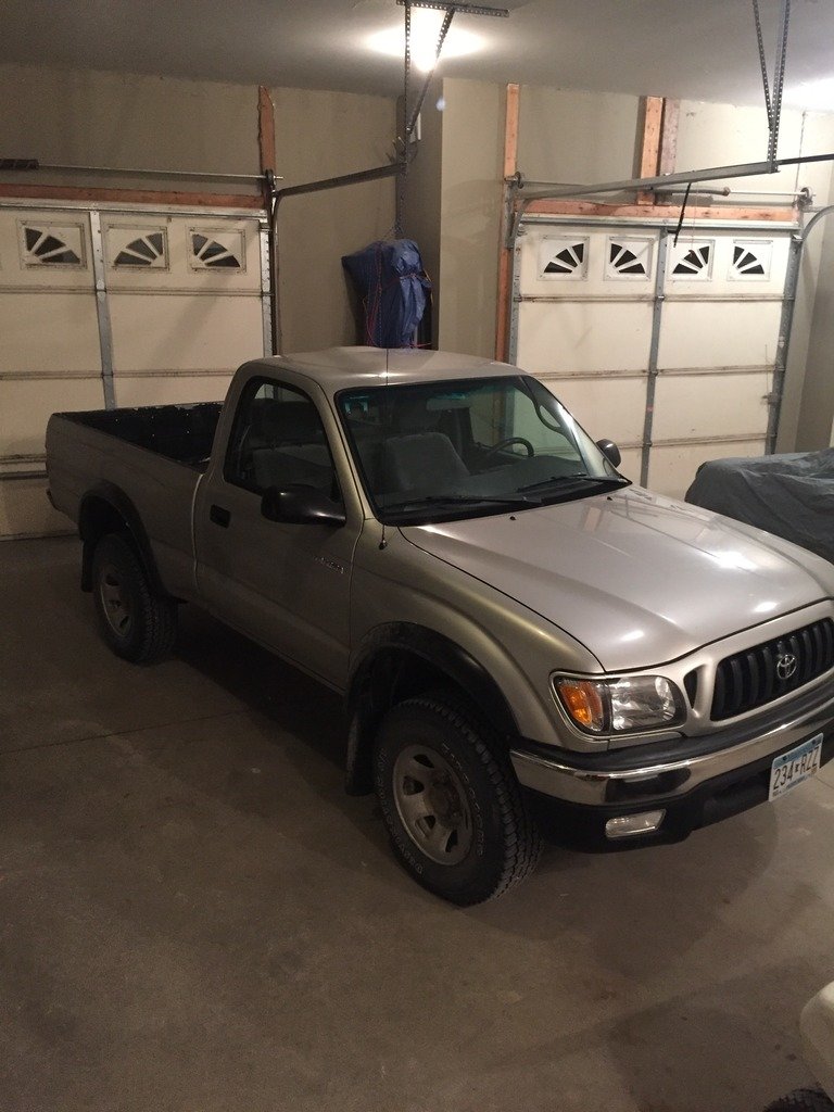

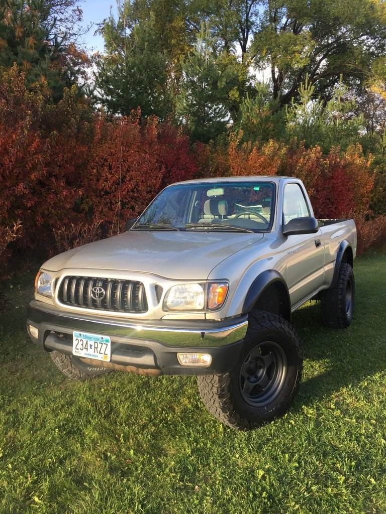

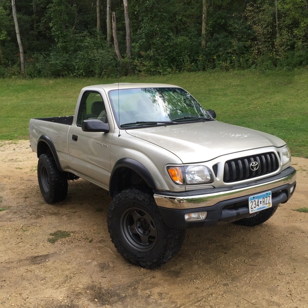

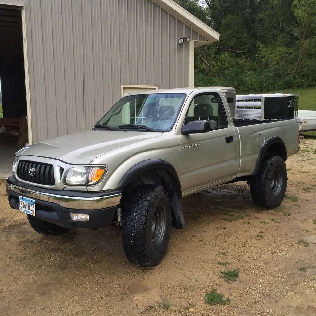

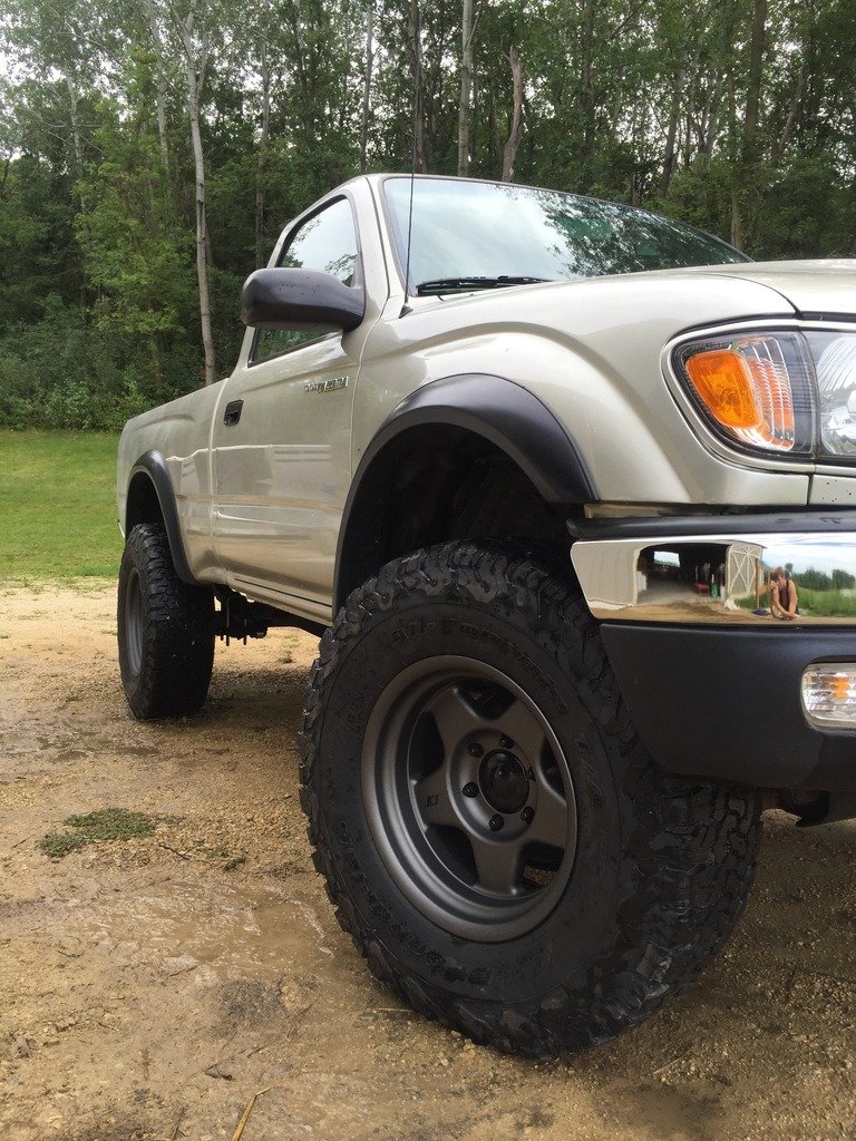

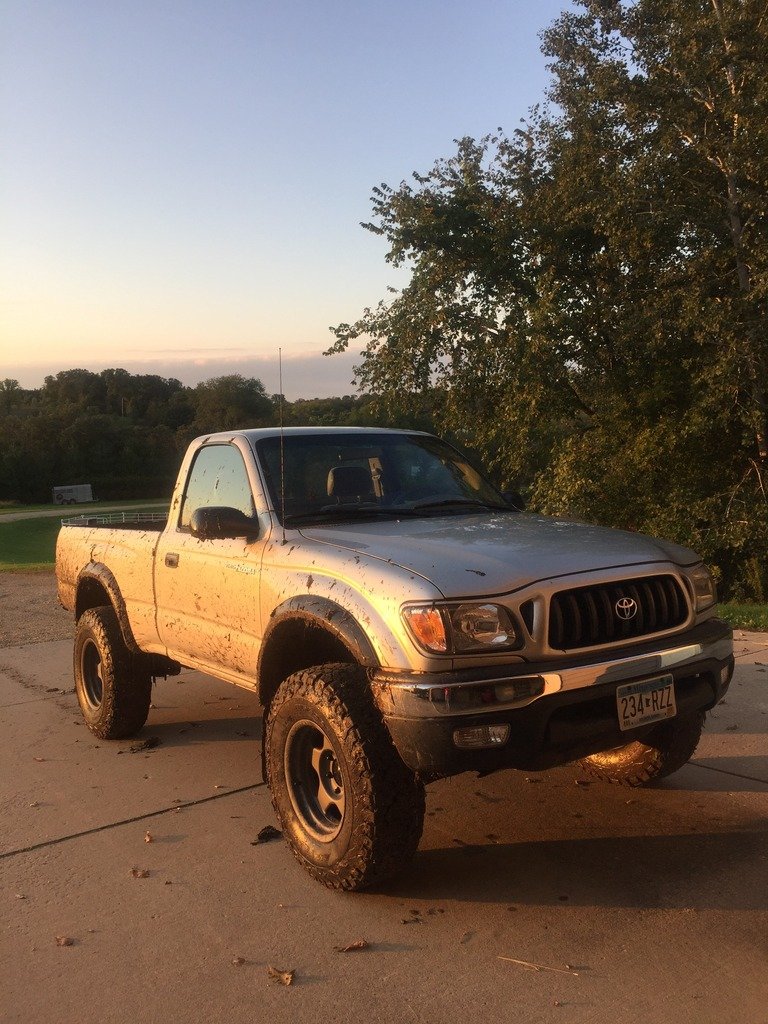

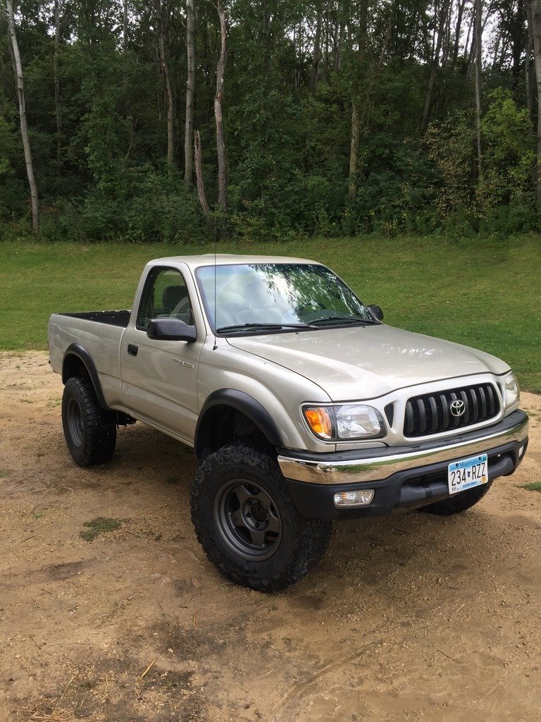

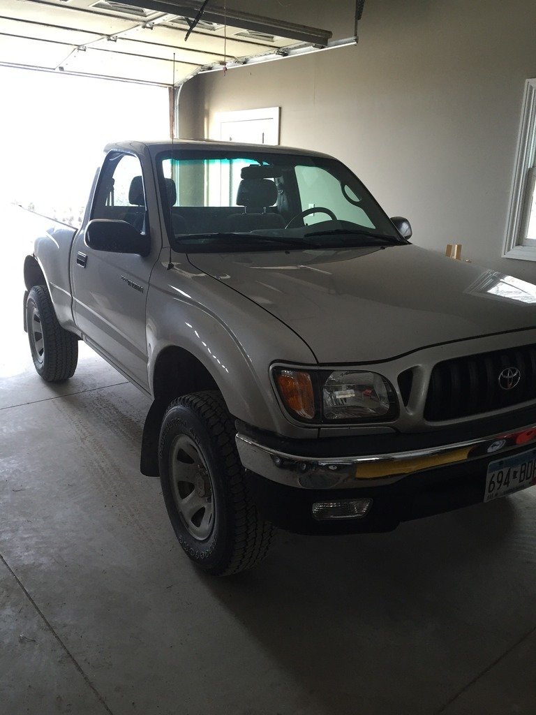

    Well needless to say, it has been a busy couple of weeks as far as the truck is concerned! It started out with a professional install of my lift kit (I decided I did not want to deal with the years of corrosion myself). I have to say I really like the Blistein Shocks/OME 881 combo. The truck feels approximately 200% better on the road. There were bumps on the highway that were so violent that they used to shut off my cruise control, and now I don't even notice they are there! I compressed one of my old shocks and it never sprang back... I think it was time for replacements! Oh, and sadly the shop wasn't able to fit the 1/4" Spacer in on the driver's side, not sure if there is a trick for how to fit it in or something, but I figure I can live with it as the slight lean isn't noticeable to me.
    Here's the last picture of the truck with stock suspension
    And here it is with the lift installed (Still running the stock 225/75/R15 tires/wheels)
    I liked the look of the lift and stock tires/wheels, but with my 16" F5s sitting in the garage I had an excuse to upgrade to new tires as well! I ended up going with 265/75/R16 BFG All-Terrain T/A KO2s. Paired with the gunmetal F5s they look really cool in my opinion. I've only had them on a few days now and I've already received multiple compliments. We will see how they hold up being daily driven on a gravel road. The only differences I've noticed due to tire size is a noticeable but not awful loss of power. There is maybe one or two hills on my drive that require me to downshift to fourth gear when it wasn't necessary before. Otherwise, the Taco is handling the new shoes wonderfully!
    I also took some rough measurements of the height of my truck (measured from my garage floor the the middle-bottom of my Bushwhacker Flares).
    Stock:
    Rear Passenger: 35 1/4"
    Front Passenger: 34 1/2"
    Rear Driver: 35"
    Front Driver: 34 1/2"
    After Lift:
    Rear Passenger: 37 1/2"
    Front Passenger: 36 3/4"
    Rear Driver: 37 1/2"
    Front Driver: 36 5/8"
    After Lift and Tires:
    Rear Passenger: 39"
    Front Passenger: 38 1/2"
    Rear Driver: 38 3/4"
    Front Driver: 38 1/4"
    Interesting how the driver's side is now EXACTLY 1/4" lower than the passenger side. It's a shame the shop wasn't able to fit the spacer in...
    I haven't quite decided what I want to do next on my truck, possibly a light bar in the bumper, a new muffler (Magnaflow?), or maybe a CB radio in the ashtray with an external PA system. I really haven't decided though. If you guys have any ideas please let me know!

    When I returned the UPS man had left me a gift :D
    75AC9995-0E03-42EF-9CB7-EE82A22ADACF_zps_612929d42c22973bcef0f7dd9ac2c75114a870b0.jpg

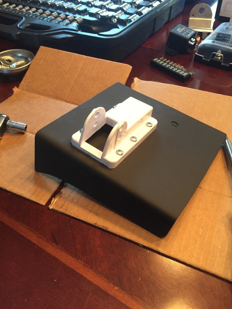

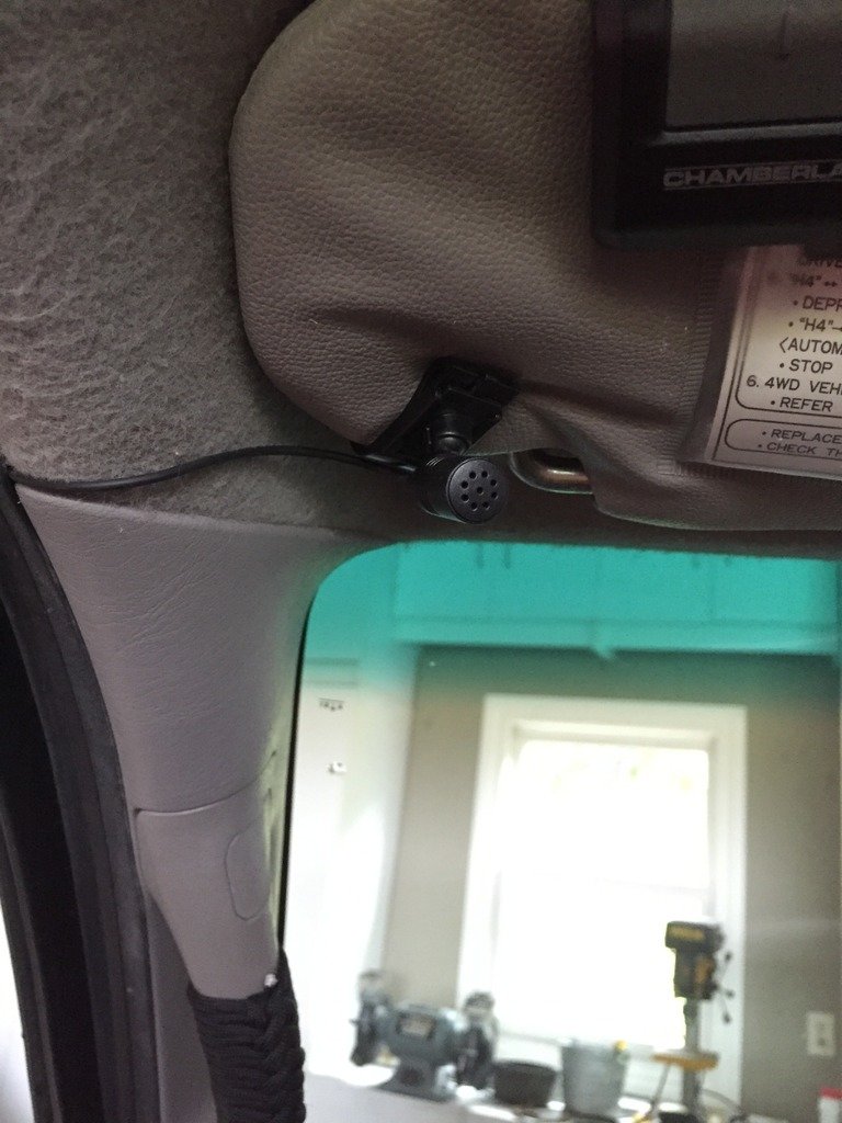

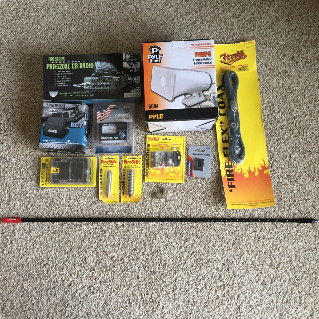

    Well, my friend and I got the CB and related components installed this weekend! I had to create custom brackets to hold the relay/fuse block and the PA horn.
    A31FB202-B6A4-41A0-90BA-EC45251B9645_zps_4ec99c679e1710e9c98dad2c94a39210a897dd20.jpg
    DAF10BDF-6F37-449B-BD7C-276E591DA70B_zps_521e2418976bea307356481789c8117140a5d0e6.jpg
    The CB radio install in the ashtray went very smoothly with just a little dremel work required. This webpage shows what you need to cut: .
    I followed the post by TacoDell (with the blue lines). For anyone who is gonna do this install I would highly recommend finding a coaxel "elbow connector" so the CB can slide all the way back into the dash.
    9F2BDB5D-9BBA-418C-A0F4-A4048EE13109_zps_629ec19653a3286be17be4fca3dce933db73adea.jpg
    All the electrical work with the fuse box went well. We tied the relay into the remote turn on wire for my stereo, so any fuse box accessories will not drain my battery.
    E8A219E8-E17E-4B3C-AE67-A51DA61DE132_zps_e0c84b7cc9e07e73b9faa57de07d2d7256a92780.jpg

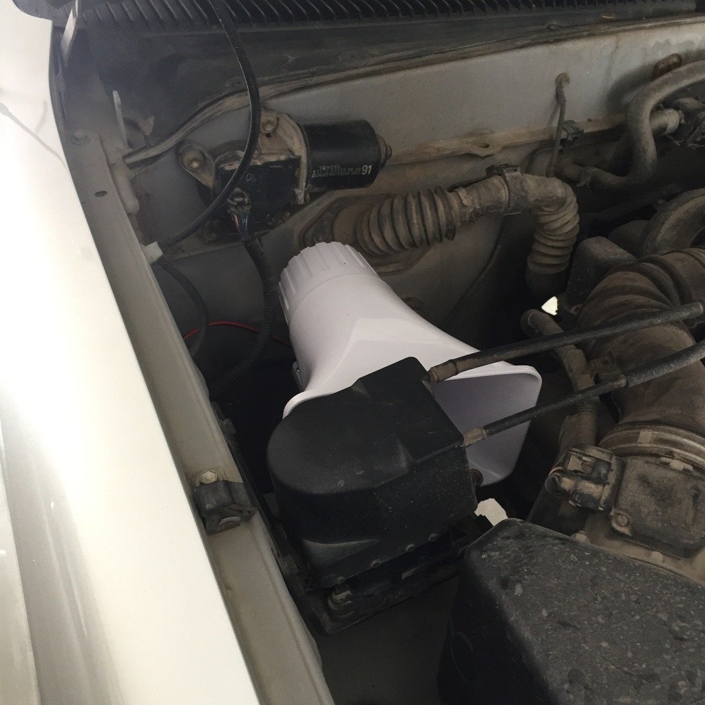

    I mounted the PA on the opposite side of the engine bay. I really like it so far! It's pretty loud without an amplifier, but I may add one in the future just for the heck of it. I set up a small Uniden speaker underneath my seat to hear incoming transmissions a bit better.
    45BC3C46-60DD-4B5E-8834-0841BA6AE556_zps_d6508a86d77d26e1385d462d9b22b4b015686500.jpg

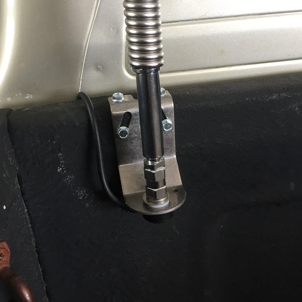

    The antenna ended up on the driver's side bedrail. I repurposed a firestik hood channel mount for the antenna.
    81150749-371F-4F39-9C4F-DDDFC9E8EE05_zps_2add090b9bbfe3363da10364c86e57d687270676.jpg
    FBDB7BCE-E350-438C-8CF6-BE7AD2C519F2_zps_1d5b87cb545e0c972b71b24205516f2a688ef193.jpg
    Overall, I'm very happy with the result. The CB will add some functionality and the antenna looks pretty sweet! The PA will allow me to yell at my friends and have a little bit of fun from time to time. :D
