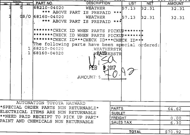

    I have an extended cab where the rubber is flaking off pretty badly on both sides. Now it's basically just a crumbly and flakey shell of its former self. 20 years in the California sun hasn't treated the truck well (the clear coat is flaking off badly on the roof and hood as well)
    Just got off the phone with the Toyota AutoNation in Hayward, the parts guy wanted $49 each (outrageous!) I could buy both online on eBay for 80 dollars shipped (roughly $40 dollars each) I told him I'd think about it and I was about to hang up when he said "If you are not comfortable with that price I can give it to you at wholesale price) He went down to $35, then eventually went down to $32.21 each (a user on this post said they got the parts for about $30 each so I was happy) and he placed an order for it. He said it's a special part so it'll take two days, so I'm picking it up on Friday.
    All in all I got both of them for $64.62, and with California's 10% sales tax my grand total was $70.92.
    If they give you an outrageous price initially you can haggle with them! He originally wanted $100+ for both parts but talked him down to $60. As @NightProwler said, they WILL try to upsell you. I don't know if all stealerships do this but my local one did. Be smart and get a good price.

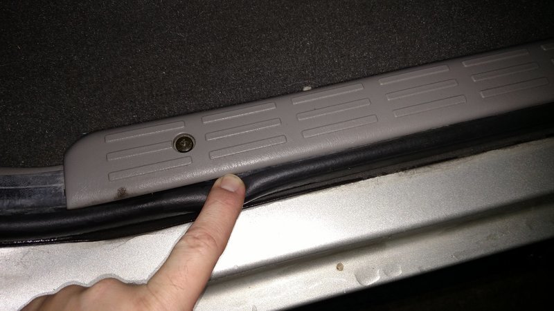

    This is where it leaked at and is enough to go over the plastic.... Especially with the water hose test

    Idk if I just can't see it, but looking at your pic again, I don't see any on the plastic running board. I see some in the door frame. And the rubber has moisture. I think that is normal. You WILL get water sprayed in through the door frame, especially when forcing water in the cracks around the door, and that'll create moisture on the rubber. As long as it's not getting past the rubber you should be good. But you said it was 'dripping down', so idk exactly where it would be leaking like that if so.. Unless it just LOOKS like it is dripping. I would assume you have a gap or something in the door frame stripping. Because up top, you've got the gutter to let that channel the water down to the front.

    Yeah that pic was from a few days ago....I have had the carpet pulled back since then. I can sit inside and see it coming in over that piece. That's why I took the door panel off and can see the drops coming through the butyl black sealant. My door gasket seems to be in pretty good shape. I did have Yakima towers on the roof but removed them thinking that was the cause.

    Looks like I was mistaken, they were originally asking almost $60 dollars EACH! I ended up getting them for half that so definitely do your homework and work with them for the best prices if you plan on buying from the stealership.
