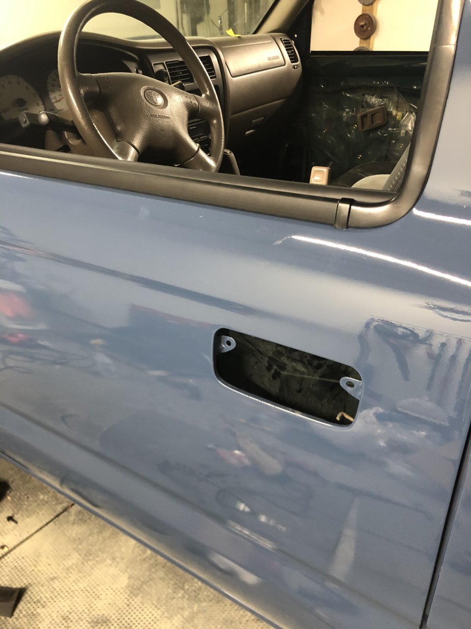

    I slapped some new ones on my truck today. After all the work repainting my truck, I didn’t want to put those cracked and faded ones back on my soon to be shiny paint.

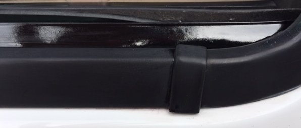

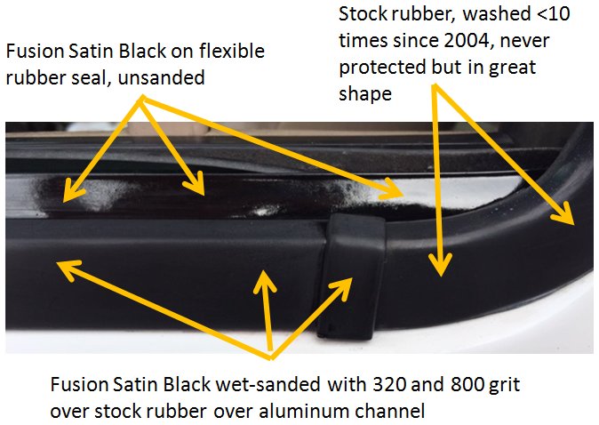

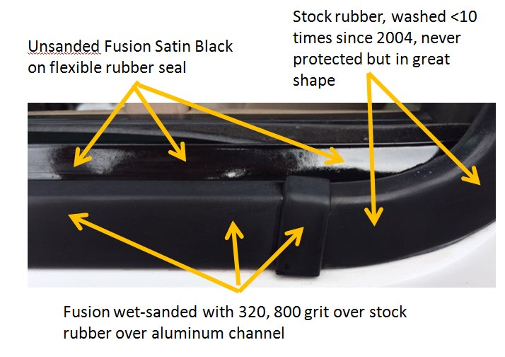

    In the 'fix your wheel flares' thread, Krylon Fusion Satin Black paint is suggested because it adheres well to plastic and rubber and later in the thread the Fusion line is said to not be available anymore. I just spotted it at O'Reilly and next-day-ordered the Krylon Fusion in Satin Black for the flares and did a test paint job on a window trim piece thanks to this thread. In brief, I think the Krylon Fusion is perfect for this. It looks like a factory match to the rubber seal and doesn't stand out at all as a Kragenized home-painted junk which I was mildly expecting. It adheres well to the flexible seal (top third) even when flexed and I expect it should last a long time. Upon application, the Fusion dried with a more glossy finish than I expected for a 'satin' product, perhaps because I used 3 thick coats, so I spent 5 mins wet sanding the aluminum portion with 320 then 800 grit. I left the flexible seal unsanded as the slight gloss looks a lot like rubber after recent addition of protectant.
    The pic below is taken in HDR with a modern cellphone camera, and captures pretty well that the finish looks like a nearly perfect match. This route looks a lot better than I expected, so I'll keep this instead of swapping for new sometime. Another lesson learned is that the Fusion Satin Black /is/ shinier than I expected, so I'll look for a flat black Krylon Fusion for the wheel flares. The Krylon Fusion is a great find for painting plastic/rubber, I'm going to look for it in Flat Brown to camoflague sprinkler parts in the yard next.

    that looks interesting, you said it can adhere well to the rubber moldings/strips around the exterior windows?
    perhaps the side mirror housing as well?

    It works far better than I expected on the flexible seal section of the lower window trim. I almost wet-sanded the flexible rubber part with 2500 grit to bring it up to show car quality, but figured time is better spent elsewhere. I haven't tried it on the flexible rubber seal that runs around the remaining periphery as you mention but I suspect it might work perfectly for that. The satin might be a bit glossy for the remaining rubber trim, at least for me, as this truck never gets washed and the only shiny spot is now this lower piece which is small enough to not look out of place. I tried this first instead of plasti-dip because I was looking for a closer match that can be sanded/renewed if necessary.
    I think the Fusion /is/ perfect for the mirrors and I think threads here recommend that. Last I checked, Amazon didn't have Fusion but O'reilly does so it seems it is not out of production as the wheel flare thread questions.
