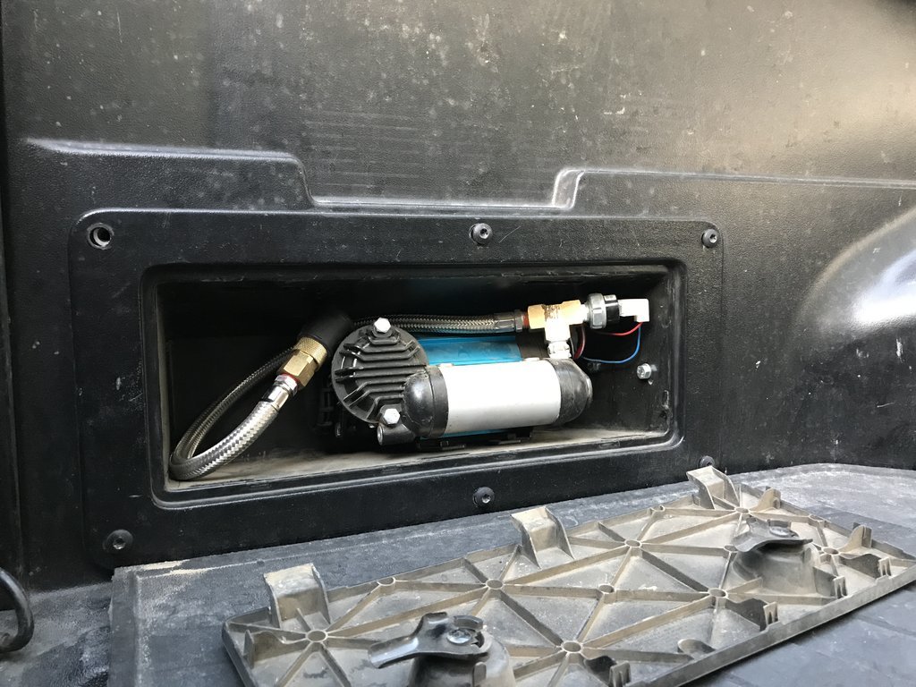

    As far as mounting location, I mounted my arb in the driver side cubby. You could probably mount a viair there or in the dead space between the bed and the fender if you wanted to.
    I have too much stuff in the engine bay so didn't want to try to mount it there and I didn't want it inside the cab just because its so loud.
    For wiring, I ran some 4ga wire from the battery to the driver bed cubby. I mounted a small plastic project box to the outside of a cubby where I installed the relay for the compressor and then ran a lead to the switch in the cab of the truck. You don't have to use a project box for the wiring, I chose to so I could leave space in the cubby if I wanted to store other stuff in there. Plus it keeps it looking cleaner when you open the cubby and don't see a rats nest of wires.

    I mounted a 2.5 gal tank under the bed, over the rear axle. The spare tire rest against the tank but fits. The compressor is mounted in the driver cubbie.

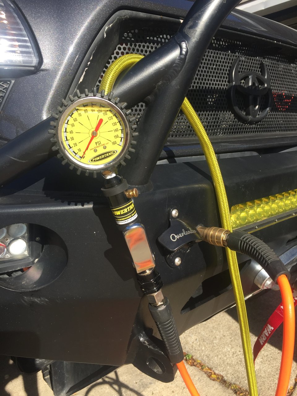

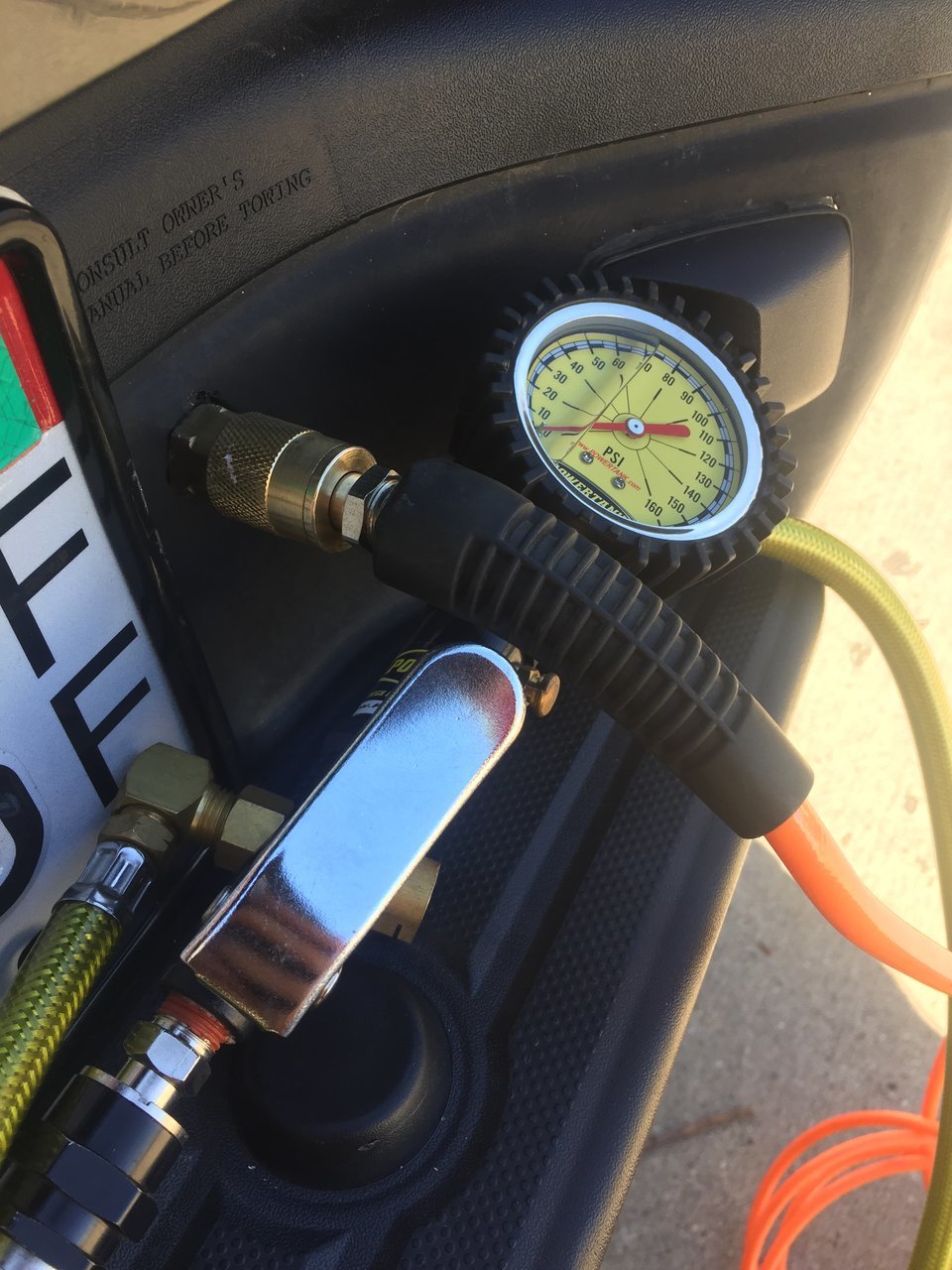

    Have mine under the hood mounted on the passenger side near the firewall, but opening the hood gets old:

    Bingo! Thats how I want to mount my quick connects. Will have to get a little creative with the front as I dont have a steel bumber. The bottle opener is a nice touch! :thumbsup:

    So, I gotta ask...how do you secure the quick disconnect to the inside of the bumper? I have both air and water disconnects that I am trying to mount them in a similar fashion, but have no idea how to secure it to the plate it is being mounted to. Hope that question made sense.

    Thanks man!!! Get stopped in traffic quite a bit and they ask about it haha!
    I drilled the hole so the threads would fit snug then screwed the hose on and used a hose clamp up against the backside of the bumper.
    Hope this helps!

    Thanks! I was tempted to mount them this way, but didn't know if there were other options. Much appreciated!

    I did the same as above
    I used a barbed firing on the back side and a QD on the outside and some 1/2” washers if needed
    Use loctite 545 on everything otherwise it’s gonna be a pain
