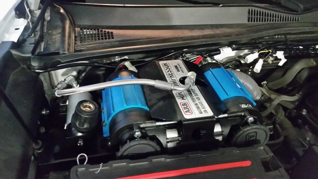

    I mounted mine in the engine bay. double ARB setup. airs up tires super quick. Mounted with the slee mounting brackets.

    Wow, nice set up! I really like that.

    yea, tankless. With the speed of these air comps i didnt see a need for it.

    If all your doing is airing up tires, then skip the tank.

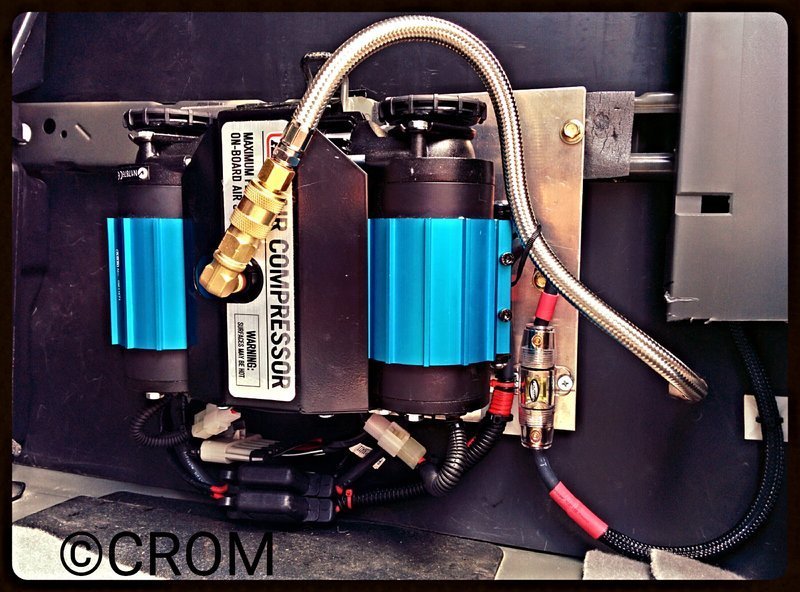

    Most compressors are sealed so dust ingress is not a problem, mount it pretty much anywhere. I didn't know all that when I did mine and it ended up behind rear seat which was great for me. I am very happy with the way mine turned out and it gets used a lot.
    My goal for airing back up was speed so I went with the best performer in the smallest package. It puts out an amazing amount of of air and takes me just over 1 minute to air back up my 33's from 18 to 40.
    For wiring I rolled my own. I threw away the ARB wiring harness and supplied switch.
    I ran compressor ground to chassis and +12v from battery using 4 AWG welding cable. I bought an 80A relay to stuff in engine room and a $0.10 simple rocker switch in the cab switch to turn it all on. :laugh:
    I documented the shit out of the install in these posts below:
    ARB Twin Air Compressor Install
    ARB Twin mounted and wiring done, Mar 2016
    Hot wired the compressor, Mar 2016
    ARB Twin mounted to aluminum plate, Installed, Mar 2016
    4 AWG wiring install from engine bay to back of cab, Mar 2016
    Air compressor ground wire, Mar 2016
    Air compressor fuse holder, Mar 2016
    Complete project parts list, Mar 2016
    Heat test after 10 min run time, Mar 2016
    Air Compressor relay, circuit breaker, Mar 2016
    Air Hose pictures, 2015
    Passing airline through bulkhead (back wall), Mar 2016
    Air line installed and quick disconnect in hitch, Mar 2016
    Aluminum mounting plate, Mar 2016
    Air line filter, Jan 2017

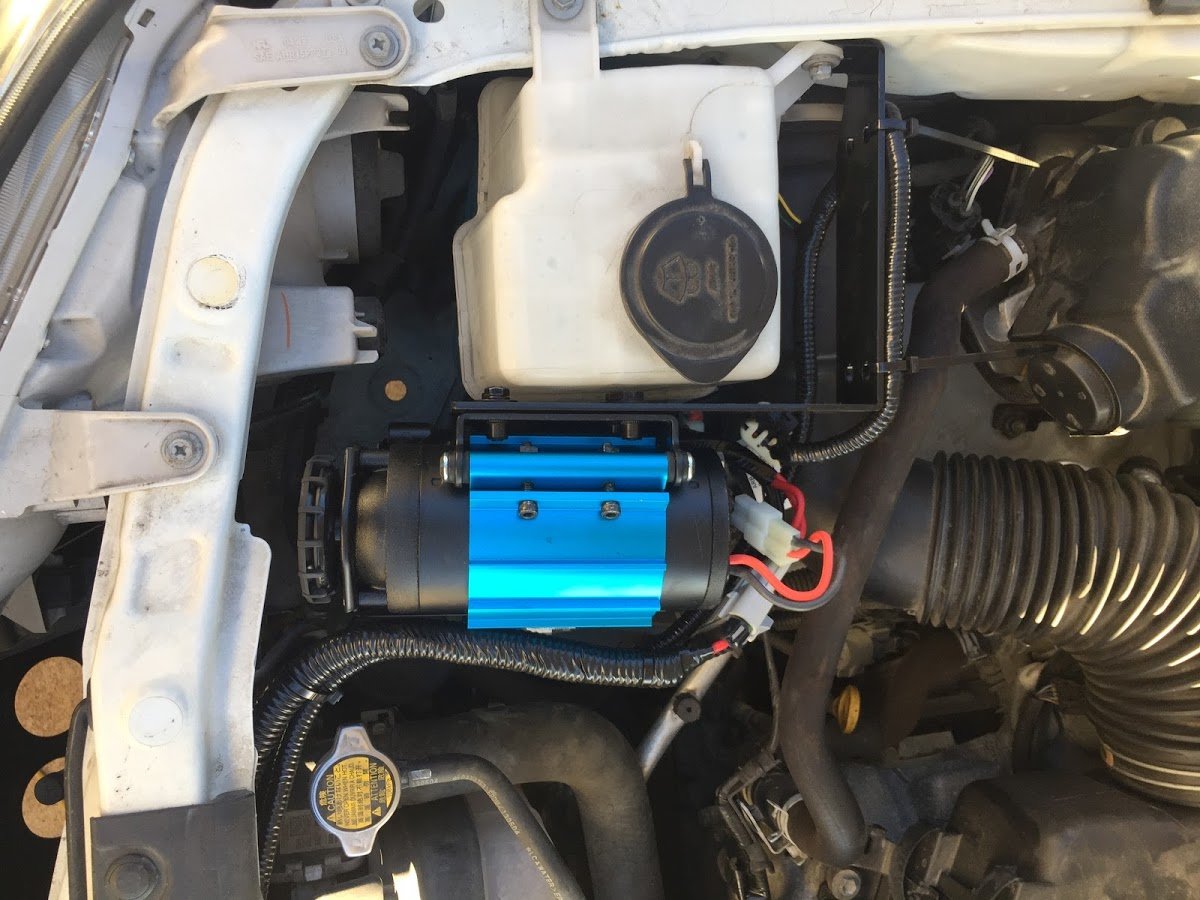

    A little help from someone with a working ARB twin comp. I just wired up my comp it comes on but has very little air pressure, i have check for leaks cant seem to find any. Manual dosent really have anything about no pressure. It never shuts off like it says it should in the manual any help would be great!

    any pics of your install? how do you have it wired?

    I read a report a couple weeks ago that had a similar symptom on a brand new compressor. Turned out it had internal damage, the check on one of the pistons was bad and not holding air. You may want to call ARB directly and see what they say , I have heard nothing but great things about their customer service.

    Did you remove the red caps over the inputs, and install the filters in their place?

    Looking at the picture the motor on the left is not running, the connector does have power going to it.
