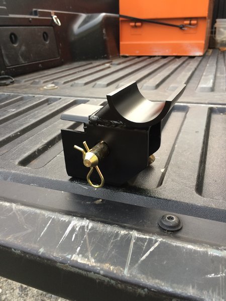

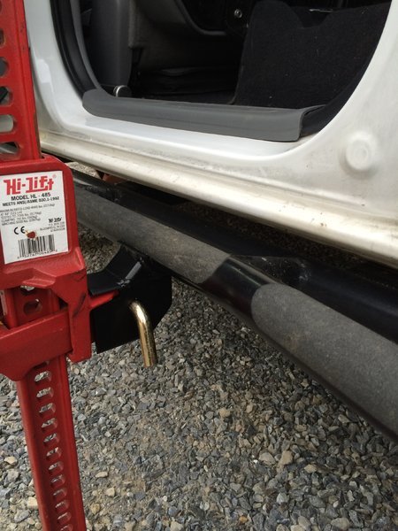

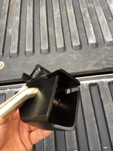

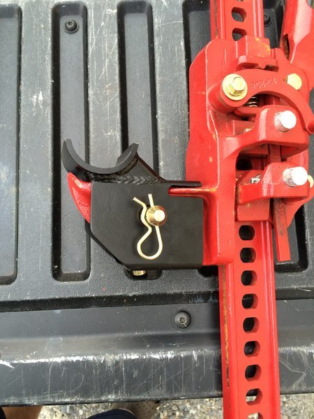

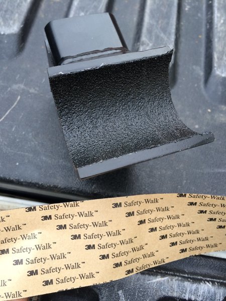

    I guess I'm blowing up my thread, haha. Got my slider adapter for the high lift in the mail today. I bought it from @adanfon . He started making them recently, and has quite a few happy customers. He's asking $55 shipped and offers large base plates as well. I will always buy from a small 'company' whenever it makes sense. Here's how it showed up.
    Great work IMO. It fits the jack nice and snug.
    I installed some 3M anti slip tape I had left over from the sliders a year ago.
