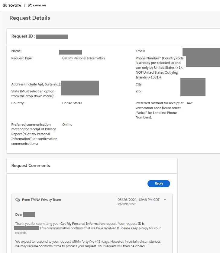

    here is my first response to my request for all of the data toyota has collected on me.... looks like another 45 days

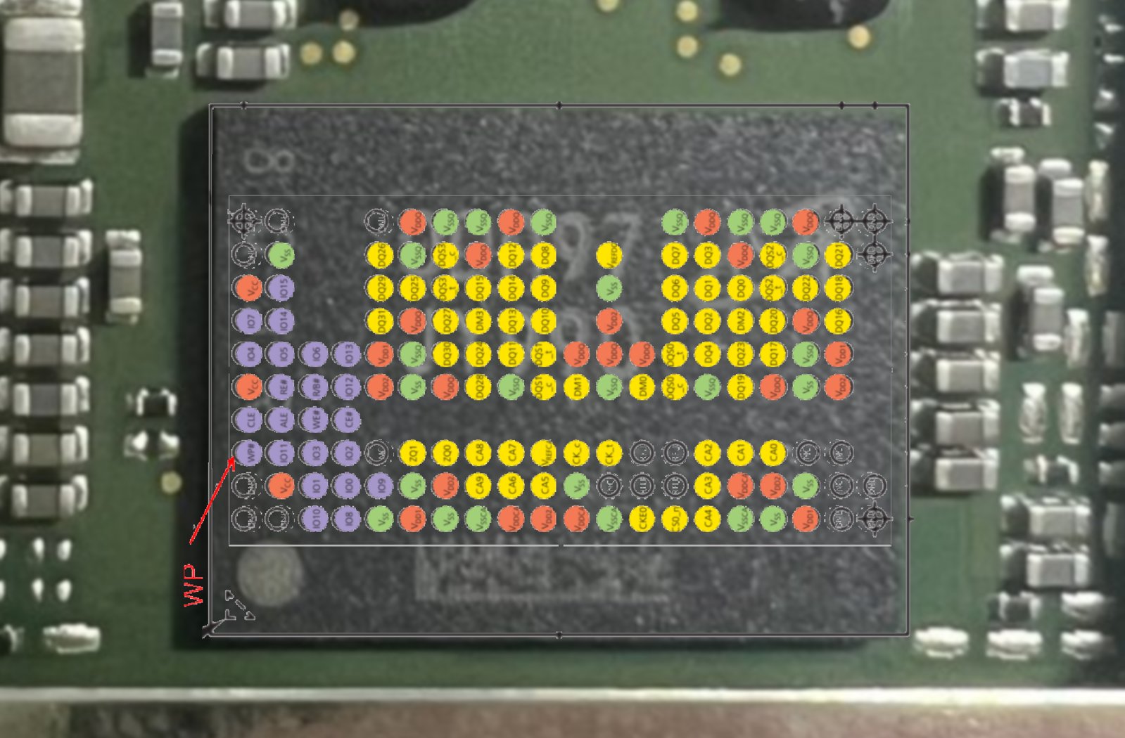

    I'm no graphic artist, but for those interested if the white paper posted above is for this chip this is the ball layout. Oh again if that is the correct white paper for this chip I was wrong this chip Locks read and Write when the WP pin is low, which is odd.
    can someone verify for me which pins on the big main plug to the DCM are the 12v+ and the GND? Which pins power the whole board

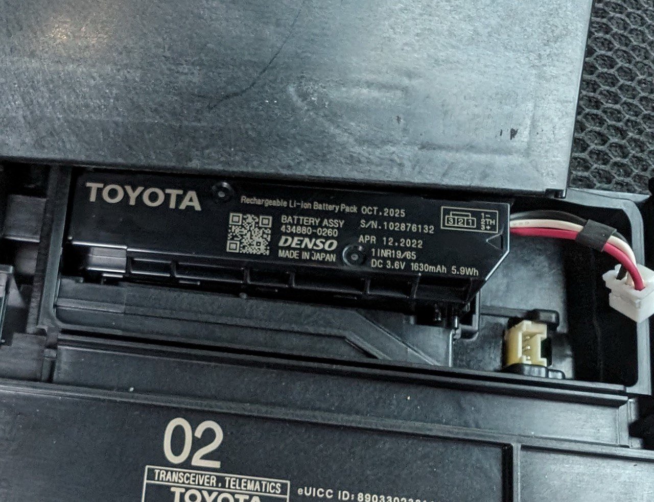

    i also removed the backup battery from the DCM, it was super easy to do the battery removal. Is it possible, and can someone verify whether one of the power source wires went to charge the battery? Or would that make no sense?

    Looks like one is switched on when truck is running, and one is always on.

    That makes more sense.
    on a third somewhat tangential thought,
    Here’s a pic of the backup battery in the DCM that i removed.
