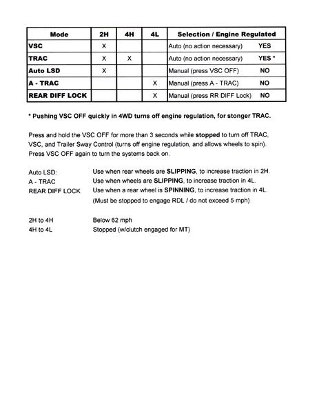

    I thought that was understood but, looking at my "cheat sheet," I guess it wasn't obvious, so I changed it a little. Maybe this one will help a little more.

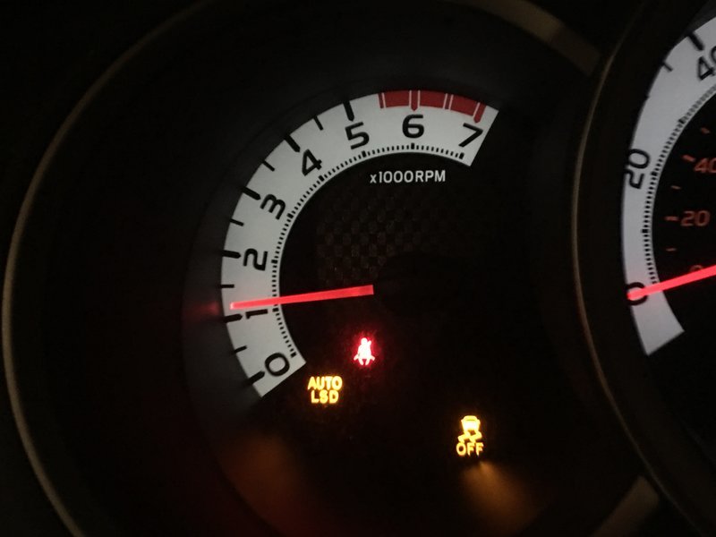

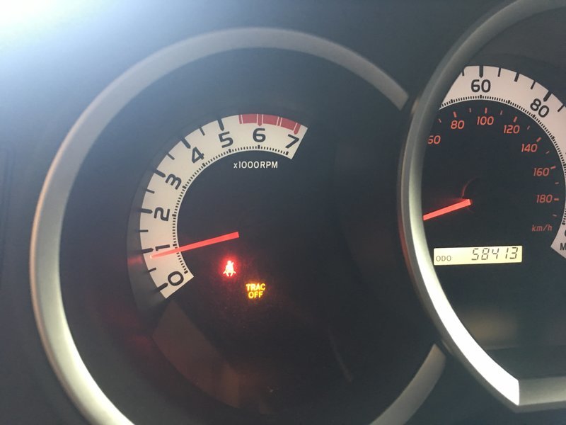

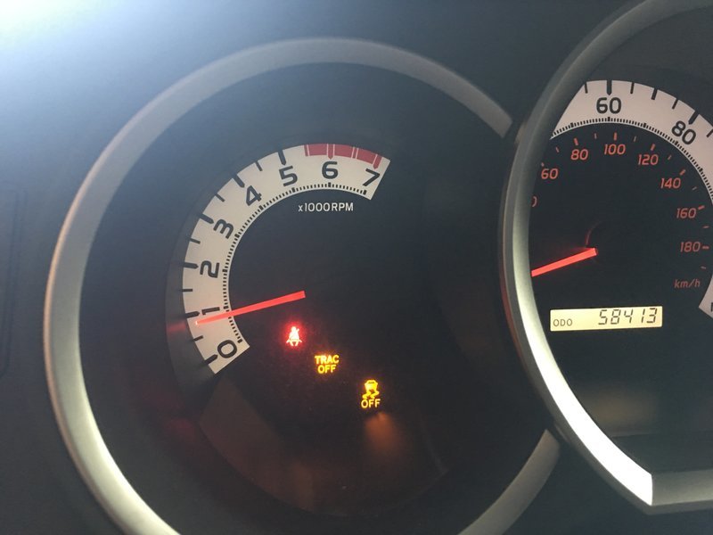

    This is from my 2013 sport. This is while in 4wd hi. 1st picture is quick push of VSC button. 2nd picture is VSC button pushed for 3 seconds.

    Thanks... TRAC OFF is more traction, as the engine regulation is turned OFF for more drive power to the traction tire(s). This is you not moving, yes?
    VSC OFF is NO (0) traction control or stability control. Open diff tire spinning. It overrides the TRAC OFF light.
    Can you do the photos in 2WD with the quick push?
    On mine, (2010) I have an AUTO LSD light and a VSC OFF light, but only until 30 mph, when VSC comes on.

    Yeah, I'll get pictures. This was while sitting still. Yes, TRAC off is no engine power management. I can't remember if auto LSD works in this mode while in 4wd. In 2wd auto LSD only works until 30 mph also on the newer trucks.

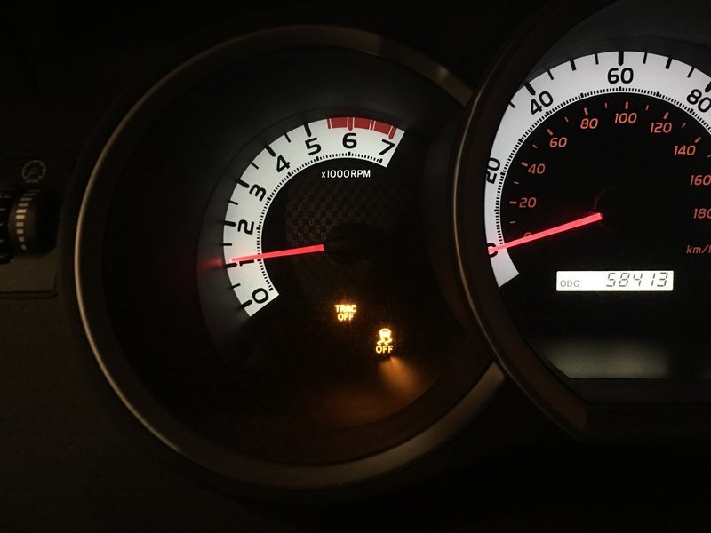

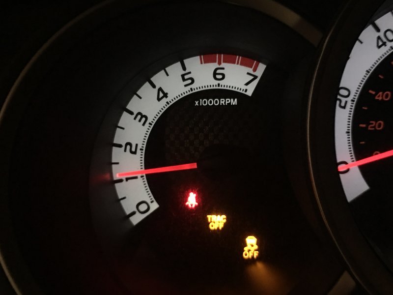

    This is in 2wd. 1st pic is quick push. 2nd pic is 3 second hold.
    3rd pic is 4wd Lo. Only option. TRAC and VSC are off with no option to turn it on.
    Quick push of button 2wd.
    3 second hold of button 2wd.
    4 Lo, only option.

    Interesting... we 2009-2011 Tacos don't have a TRAC OFF light. Funny that it goes on in VSC OFF mode, sort of a contradiction there!?? TRAC OFF = More traction control & VSC OFF = No traction control!!
    You will see that when you are driving in AUTO LSD (which is the same as TRAC OFF, but in 2WD) the VSC OFF light goes out at 30 mph.

    There is a difference between the auto LSD and trac off. Auto LSD will apply brakes to slipping tires to send power to the tire with more traction, kind of like a mechanical LSD. Trac off just turns off engine power management. But yes, auto LSD will turn off above 30 mph.
    They seem to have lumped Trac off and VSC into the same light. They should have had 2 separate lights for this.
