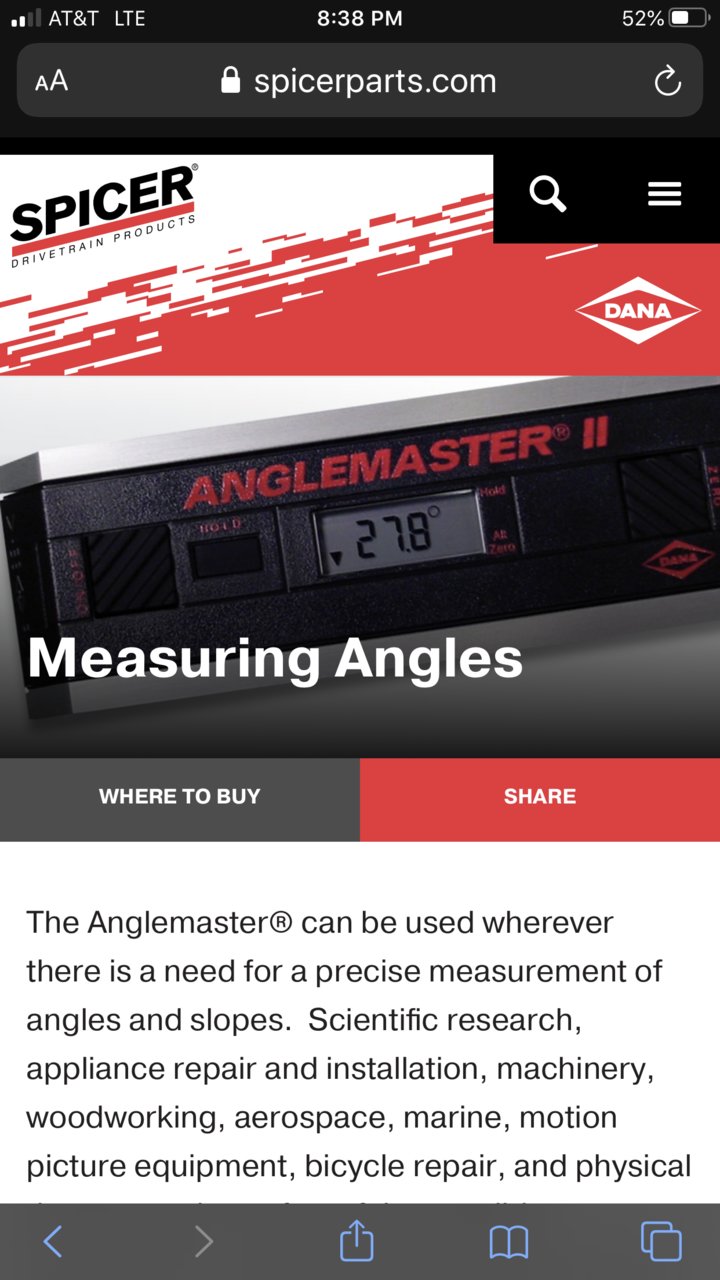

    ardrummer292[OP] likes this.

    Yeah, I'm seeing the double cardan joint added aft of the carrier bearing as a possible solution, but that sounds very expensive. Again, only needed if things get REAL bad.
    That's my plan, unless the installer dude has one already.
