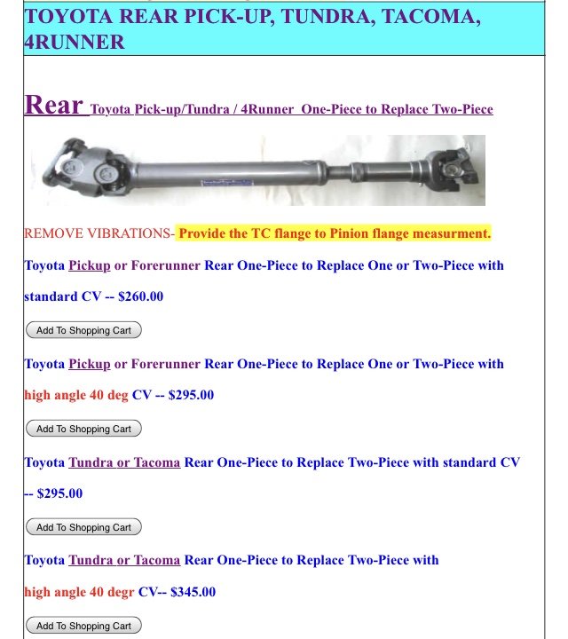

    Also... pre-made two piece double cardan driveshaft solution?
    http://www.driveshaftsuperstore.com/CUSTOM_Toyota_drive_shafts.htm

    Halfway down the page, there are options for Tacomas and Tundras.
    Am I mistaken in thinking these could work as an off-the-shelf double cardan solution?

    I don't think they are the DCLB version. Also only 350 bucks makes me a little skeptical on the quality of parts and how good it actually is.
