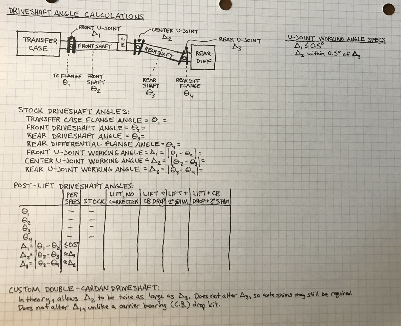

    I'm planning on getting my lift installed this week. Gonna meet up with @EatSleepTacos this afternoon to figure out my baseline angle values. Hopefully this template is helpful for others who are trying to cover all their bases early.
