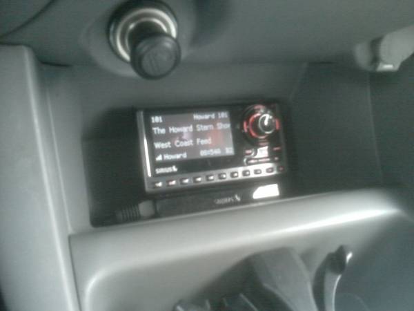

    Hello All - I just bought a 09 dc OR a few days ago, so far I am very impressed as I was a Ford guy for years. My last Ford was a mess but it is over now :).
    I have a sirius sportster 5 that installed in the truck but I DON'T want to keep using the AUX-In. I currently have it installed using the Aux, but the volume is noticeably lower than the radio/cd player. With my Ford I used a mini-to-RCA cable, connected the RCA cables to a box that connected directly to the back of the radio. Some of the parts I think I need is:
    1 - mini-to-rca = http://www.crutchfield.com/p_043183190/Arista-Stereo-Mini-to-RCA-Adapter.html?tp=1934
    2 - Toyota Auxilary Input Adapter (TOY03-AUX) = http://www.gosiriusxm.com/Toyota-Auxiliary-Input-Adapter-Converter-40TOY03-AUX41_p_384.html
    3 - SFA 12M shark fin adapter
    Anyone know if this will work? I am worried about the TOY03-aux because it only shows to a 2008 Taco. Some of you guys are pretty good with this so I am hoping your good with this.

  13. Jun 22, 2009 at 9:15 AM
    shadgkiss
    shadgkiss [OP] Member
    Jun 6, 2009
    #18115
    16
    Howell, NJ
    2009 Double Cab, TRD Off Road
  14. Jun 23, 2009 at 5:59 AM
    oghwga
    oghwga Member
    Apr 29, 2009
    #16562
    9
    nj
    09 dbl cab 2wd sb
    so this adaptor plugs into the back of your Sportster and hardwires to the back of the head unit? And everything still works the same except that now you have good volume control? If this is true then you are the man and i will order this today. That is my only complaint with my Sirius is the volume through the aux port is so darned low.
