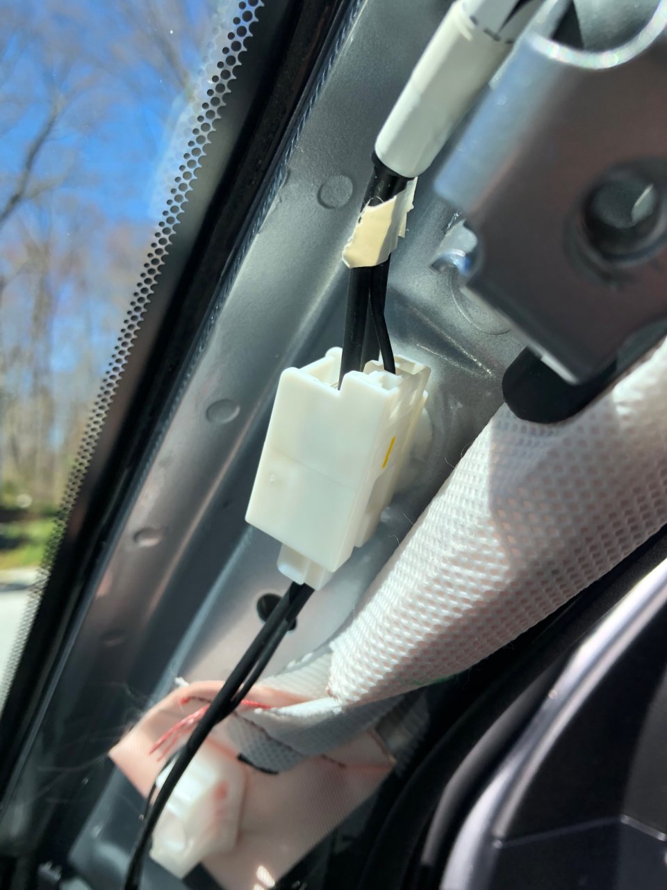

    Thanks again. Just pulled it and found the antenna cable. There's 3 wires, from the shark fin that go into 2 wires to the stereo. It seems like the 3rd wire is a coax. Is there a different wire, after the harness for upgraded models? Cheers

    Looks like you have the antenna but need cable to the radio. You can go to the dealer and they can get you what you need.

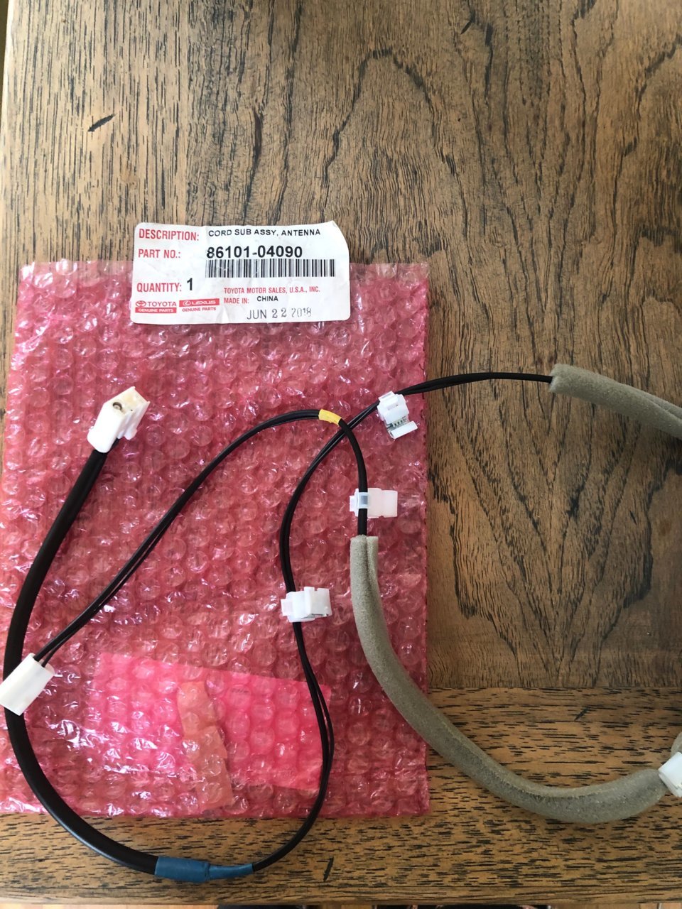

    It definitely does. I just hooked up a new wire from the A pillar to the head unit (antenna cord sub-assembly above), as the last previous cable didn't have the satellite radio connection. The head unit isn't recognizing the antenna. I'm totally perplexed

    Thanks for the help. I've driven the car all over, within a 100 mile radius now and still no reception. I replaced the wire harness in the pic below. The one is the pic is the old one, that didn't have the Sirius cable in the harness. Do you think the new one can be bad? The AM/FM works perfect

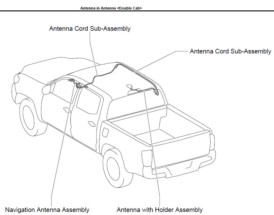

    Not sure if you ever got resolution on this but at least with my truck (2019 SR) the sharkfin antenna DOES NOT have the xm antenna inside it. I am wanting to do something similar to what you are doing and took the antenna apart to make sure. If you look at parts diagrams it shows 2 different antenna models. 86300-04080 and 86300-04090

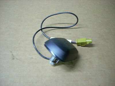

    I have purchased a OEM Chevrolet XM antenna for $10 that I am going to mount on my roof. I also ordered a Fakra K extension cable to run from the antenna back to the radio. I am planning on mounting the antenna in the passenger front corner of the roof.

    I ended up with an aftermarket xm antenna per here

    So I have completed my antenna install. I wound up using an OEM Ford F150 xm antenna that I bought from a dealer for about $30. Paired with the extension cable and adapter it works perfectly and the reception is amazing compared to those crappy magnetic antennas. I mounted it on the roof right above where the passengers head would be. Much cheaper than using the factory Toyota antenna and redoing the wiring.
