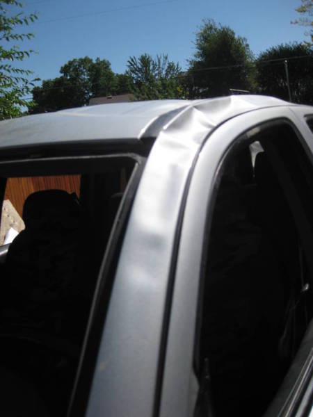

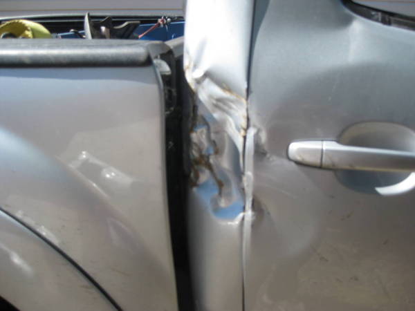

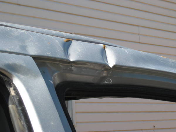

    Uh. It's beat to he//. But it's only 1 owner.
    Custom body work/damage ARB rear locker Bumpers Shocks Other parts Tires and Rims Air tank fully plumbed into truck "Golf ball mod"
    I am looking to get patch panels for the right rear corner of the cab, a roof skin as long as it goes all the way to the back glass. also if i could find the sections that the front top of the passenger door seals.
    I got a rough estimate of rhino lining the whole truck at around 2 to 2.5 grand. not bad for the whole truck plus it will help cover some of the smaller gashes and lifetime warranty if i drag body later on in life

    Debadged, Toytec Ultimate Lift, Banks Monster Exhaust, AFE Pro Dry filter, Black Grillecraft grille, Flat Black background headlights, Red Blinkers and markers with alternating turn signal mod, Krypton Bulbs 6000K Headlights and Fogs, Fog Light anytime Mod, LED interior lights with map light mod, AVS Black Taillight Covers, Tinted Windows, WeatherTech Digital floor liners.
    the roof skin should go from the rear glass pinchweld to the windshield pinchweld... and looking at the damage you have between the a pillar and the cab corner/c pillar... you may want to look into getting a 'uni-side'.. this would be a one peice 'frame'.. basically take your doors off and what you see is the uniside, 3 pillars, windshield pillar, roof rail(which would meet your roof skin) and cab corner and everything in between...
    if you could find one in a junkyard it would be nice..
