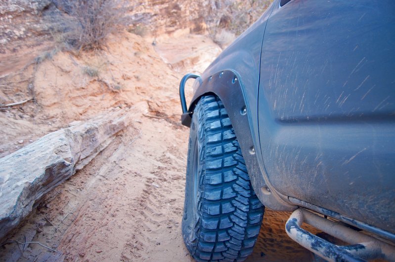

    Please stop, we get it you have a drop bracket but no sense in spewing bs because you couldnt figure out how to stuff 35s.
    Heres pictures for proof, my truck utilizing full range of travel on coilovers with both 35s and 37s

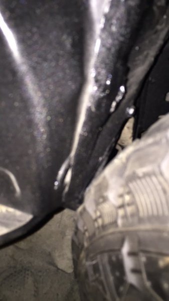

    Would you reccomend 4.0 bs or 3.75?
    I have 4.75 with 1.5 spacer and this is where I'm at lol

    Your picture is super blurry but looks like you need to cut/hammer more. Both of my wheels are 3.5 bs but different width so -25 offset (16" wheels with 35s) and -38 offset (17" wheels 37s) so I couldnt really help you

    My caster is only 1* so I think that has to do with it... The firewall is hammered and the cab mount is as far back as possible.
