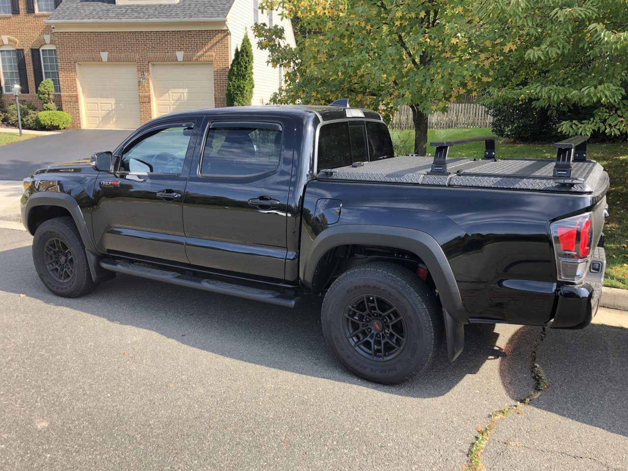

    Installed the DB cover a few weeks ago, and just got around to installing the FR rails on Friday.. it was missing ALOT of hardware (I had ordered the combo direct for DB).. Called DB and they said I had to call FR.. Called FR and their customer support rep Liam was awesome.. all the HW , and then some, arrived in the mail on Monday. I dig the look of just two rails for now, but will be installing the 3rd in a week or so when the RTT arrives.

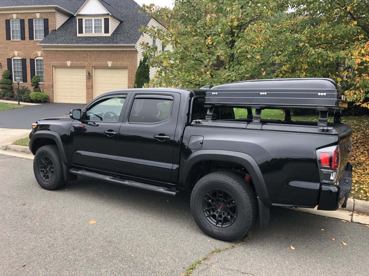

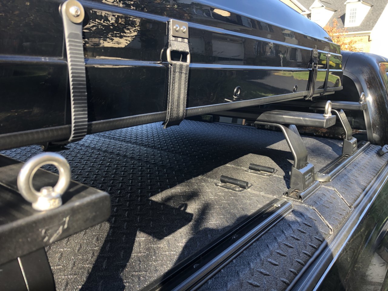

    Did an initial setup.. anyone that is looking to do the FRunner/RoofNest combo keep in mind that the awning rods have a very specific angle to be installed, and the angle +bowcurve doesn't work out of one window (the window facing the Cab) . Since I've ordered some black M8x30mm screws to remount the RoofNest, (The original bolts are M8x60+mm , its endless ratcheting.) I will mess with the the RNest placement by an inch or so and see if that will work for the awning.. if not. Will just have to get creative.. as my plan next is a CaliRaised Roofrack, so when in the tent I can keep a cooler , and misc within window reach.

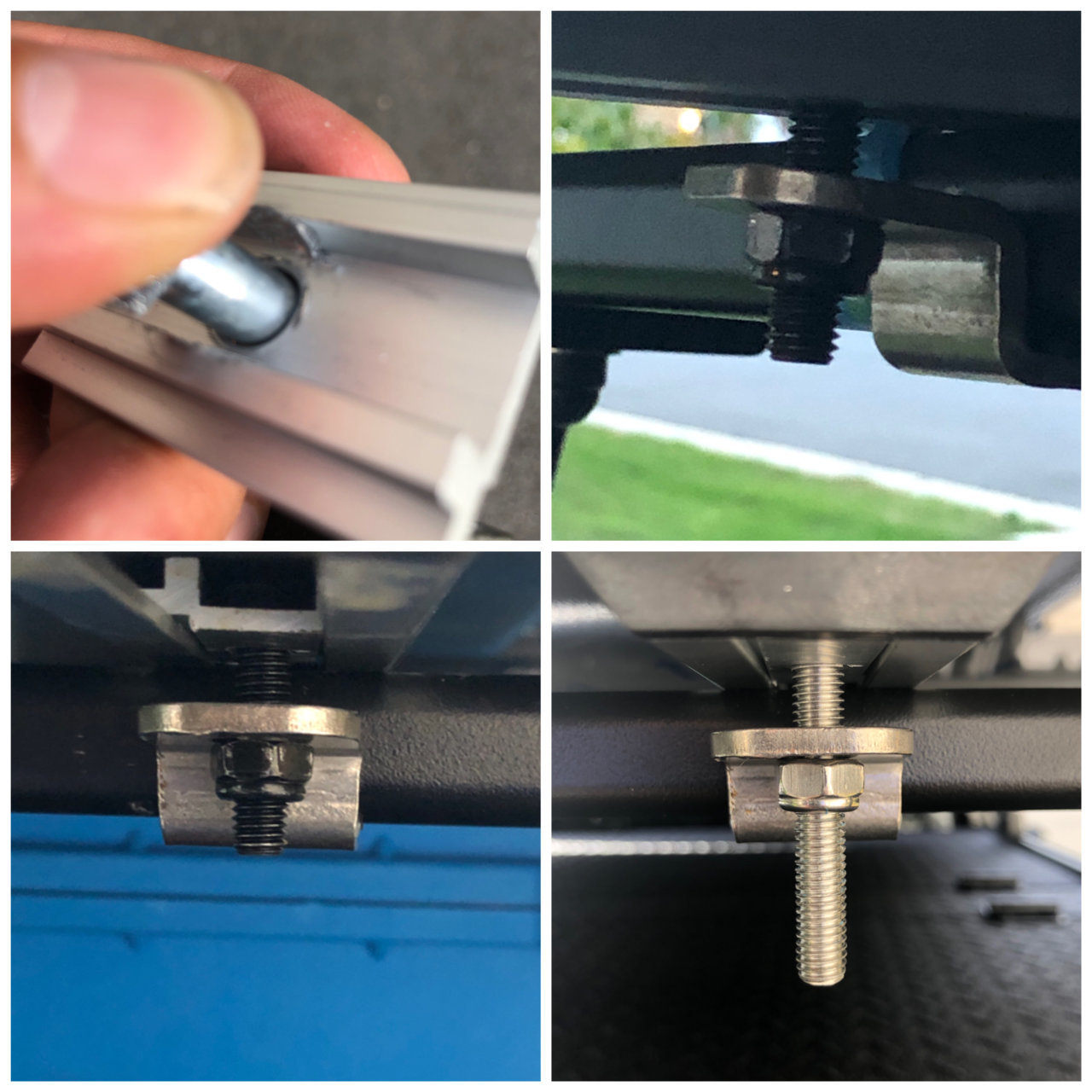

    Finally swapped out the stock RoofNest Hardware , re-adjusted the FrontRunner Rails and reset the RoofNest a little further back. These bolts are M8 30mm and allows clearance to use the space b/w the top of the Diamondback and the bottom of the RoofNest. The hardware from RoofNest feels like one time use hardware (the bolts strip and I've had to cut two bolts off already to replace with these 30mm's. Also , as shown in the picture, the slider brackets are aluminum and just wants to chew that M8 if you are not careful. I contacted RoofNest and they were very helpful and sent me another set of slider brackets and hardware (although I doubt I will ever use the nuts/bolts, but having extra sliders is important for the chew factor. A couple of tips: when tightening the nut, you want you use your other hand and pull down on the steel bracket against the nut, this prevents the bolt from spinning in the track (and resulting in chew) . While doing this you want to tighten it until it pinches your fingers "almost to the point of discomfort", then do the other side.. for the final tightening I've found that you can just hold the bottom of the boltscrew and continue to tighten with the ratchet wrench they provide on purchase (its really helpful) , and forgo using a ratchet socket, unless you want to deal with stripping etc. Hope this is helpful for anyone else. https://www.amazon.com/gp/product/B07M5LHH1H/ref=ppx_yo_dt_b_asin_title_o02_s02?ie=UTF8&psc=1

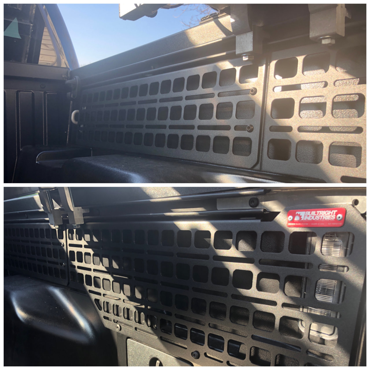

    Received the Goal Zero kit mentioned above, just haven't had time (or sun) to play with it. In the meantime I went with BuiltRight Industries Molle bed panels https://www.builtrightind.com/colle...e-rack-system-4pc-kit-toyota-tacoma-2005-2021 on a black Friday combo deal. Tips for anyone doing this install (which was very easy btw) , is you don't really have to outright remove the Diamondback Cover in order to get these panels installed.. I did unhinge one panel , but that only took seconds and was more for light and access during the install. You can easily unscrew all the bedrail torx screws and slide these Molle panels underneath without removing or loosening the DB center anchors.
