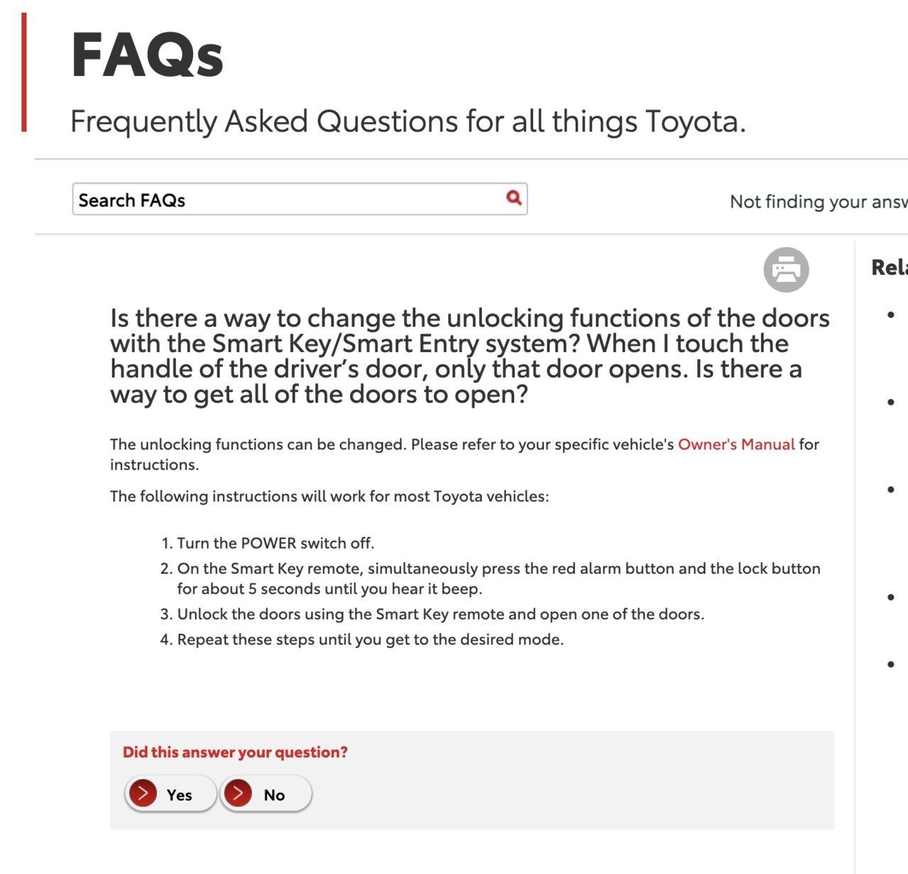

    The smart locks / grocery store experience had been frustrating me.. y'know.. get to the truck and have to touch and open the front door in order to unlock the rear passenger door to load groceries. Found this and now its easy.. just touch the driver handle and bother driver + rear door unlock. http://toyota.custhelp.com/app/answers/detail/a_id/7729/related/1

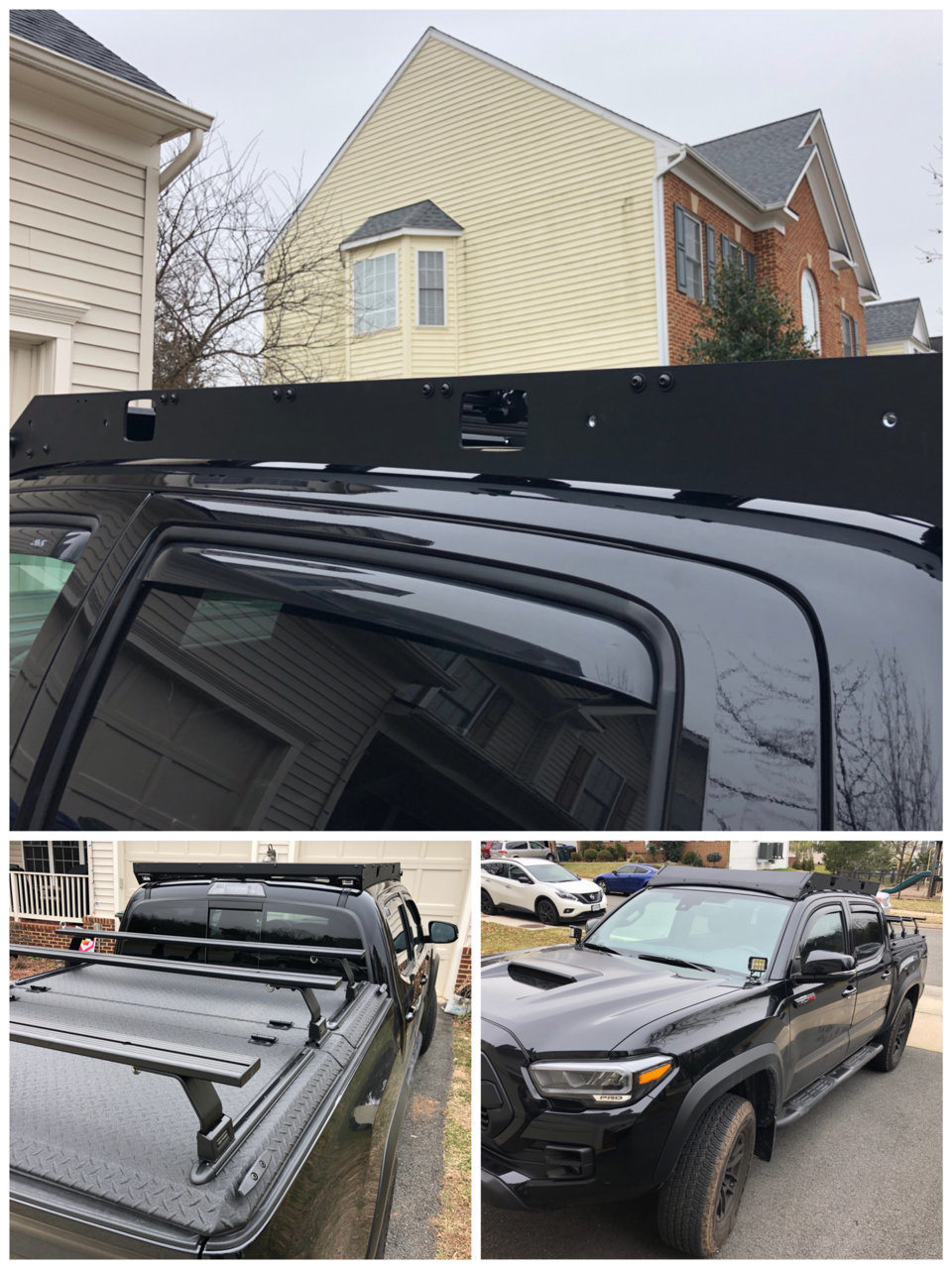

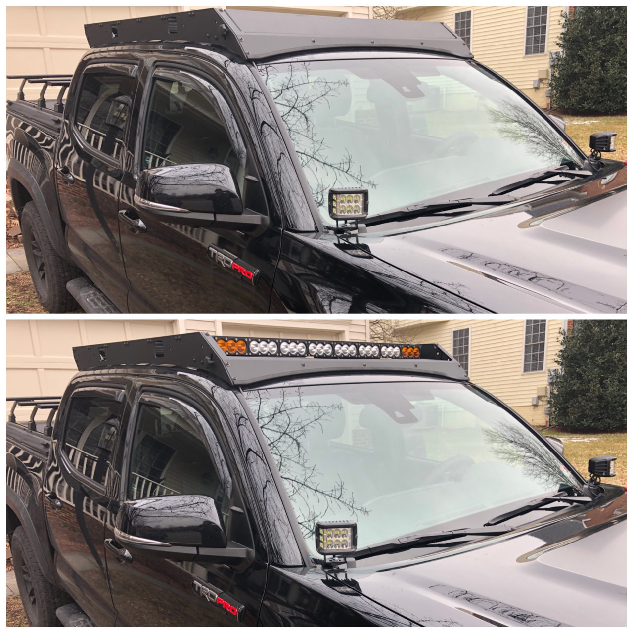

    • Installed the Cali-Raised Premium 360 roof rack over the weekend. I'm still waiting on the light bar and 4 more light pods for the sides.
    • Appears there are 4 5/16 threaded holes on each side panel that will be unused , and I've asked them to clarify what they are for or whether they can be used for anchor points for eyebolts .
    • If so I've found these online https://www.amazon.com/dp/B077GYQY3...olid=39NIYT6FSC1PJ&psc=1&ref_=lv_ov_lig_dp_it and may use them for that or even to make a place to hook up an awning.
    • I've noticed the Cali raised bars do not have entry points to slide in bolt hardware for more tie points. Curious if anyone else has any ideas or creative ways they have used the rack .
    • UPDATE: The response I got from CALI RAISED on the 4 5/16 threaded holes is that they are for roof rack handles or accessories. The spacing between the holes for a handle is 9.5inches - FYI

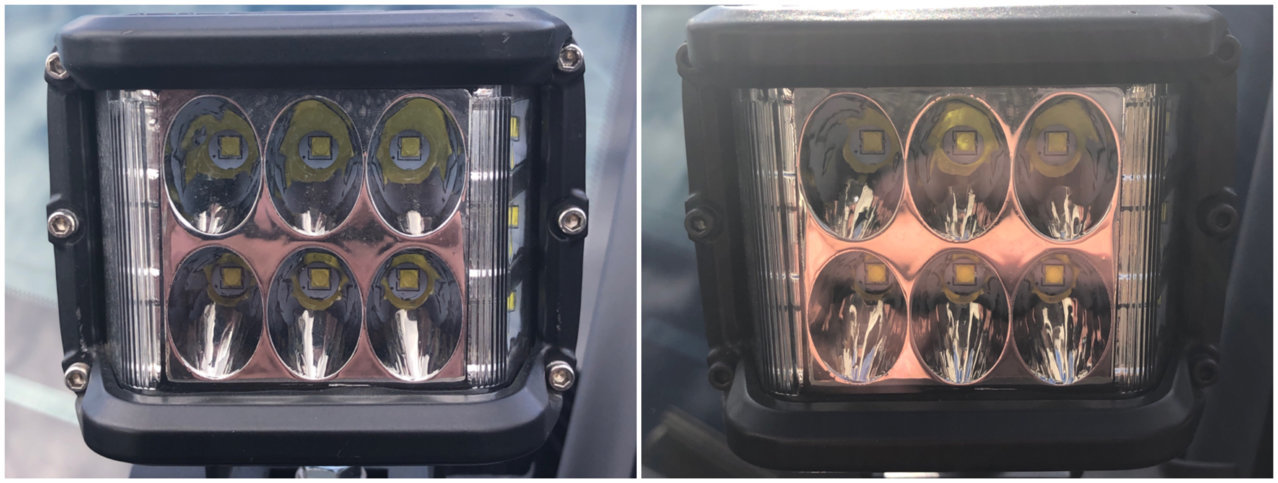

    $2.63 Chrome Delete on Cali Raised Ditch Light Bolts.

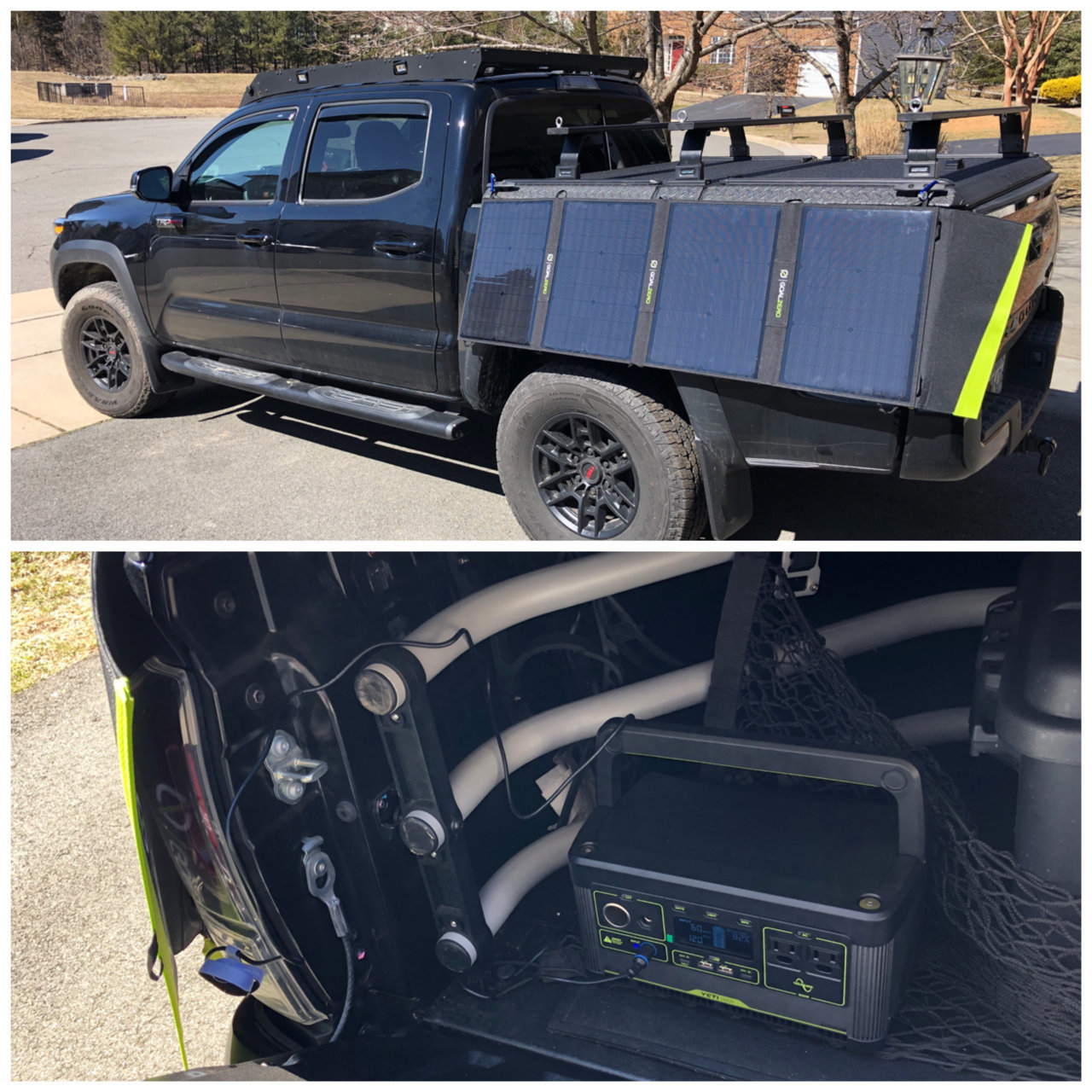

    Installed 360 pods and juiced up Yeti.

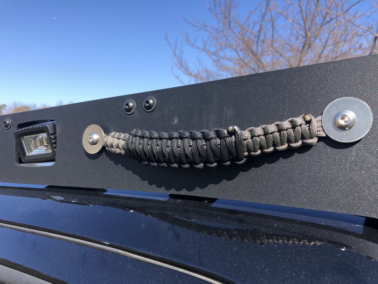

    The Cali Raised rack is 9.5inches from bolt to bolt.. Haven’t found any handles yet , so made some out of paracord for now, although this does do a number on your hands (blisters) when making.

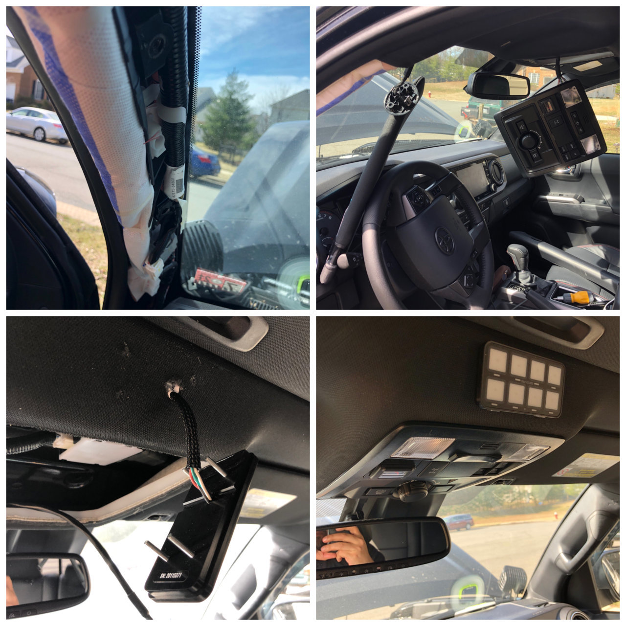

    PowerTray came in , installed: Couple of tips.
    - The PowerTray instructions suggest removing the fuse panel cap when installing.. I did that, and halfway through realized I might be difficult getting the fuse panel cap back on once installed , so I started over..
    - Bolting the power tray is TIGHT.. as opposed to the directions I did the L bracket first, then the tray , then connected the two together.. mostly for accessibility
    * By doing it this way , you can tilt the tray to squeeze in your hand to tighten the first bolt, hand tighten that bad boy as much as you can .. I hand tightened with a socket in hand. Then you can do the outermost bolt.
    * Highly likely you will need an flexible ratchet extension to fully tighten these bolts.. And this thought will go thru your head " Man.. if I ever need to get to the fuse box or underneath this thing , its gonna be a PITA"
    - Access to the firewall will be TIGHT TIGHT TIGHT after install, I ran the Blue wire to the ignition afterwards , strong coat-hanger fed in from the inside of the truck, attach blue wire with elec.tape and pull it thru...easy.
    -I've been chipping away at this to avoid an all day install, and am about 90% done , secured up the excess wires until next session.
    -Will probably skip the pink trigger wire for now , so basically have the white to tap into parking lights , and then I'll start on light bar wiring before connecting everything together.
    -This BY FAR , is the best SP9100 wiring and installation video i have found, very helpful . https://youtu.be/pIWOeJZ282M
