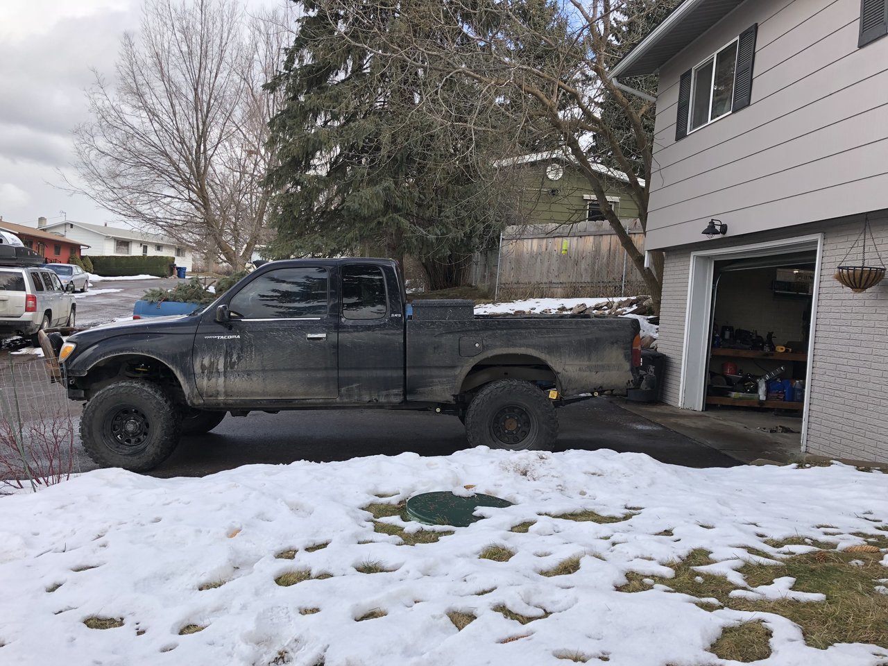

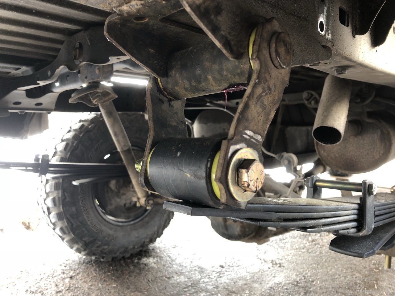

    Pics from today...

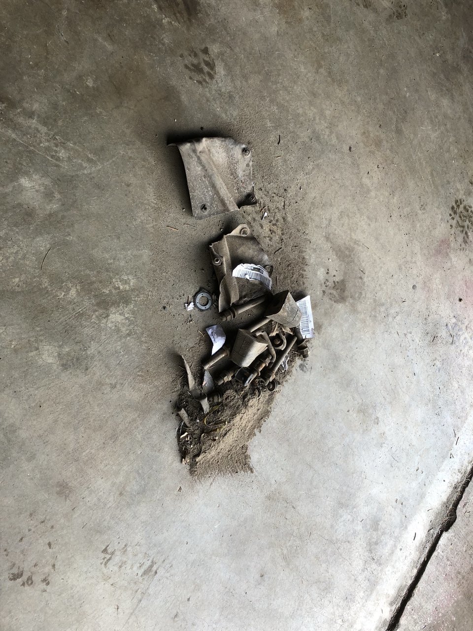

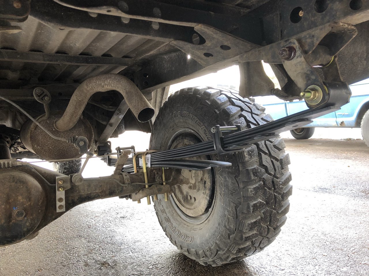

    Had to modify the stock shackles to accept a 1/2" x 4 1/2" grade 8 bolt on the spring side.
    Also did new u-bolts from ToyTec, 1/2" x 4 1/2" front spring eye bolts, brake bracket doohickey, and the 31131 Monroe shocks
    Also hacked the exhaust off...too big a pain to work around. Decided to u-bolt flip at a later date.
    Stance is about perfect now, needs 33's.
    Pile of broken junk, dirt, hacked u bolts, etc. so much mess.

    I would say I got an easy 2.5"-3" of lift in total over the stock stuff, which was terribly sagged.

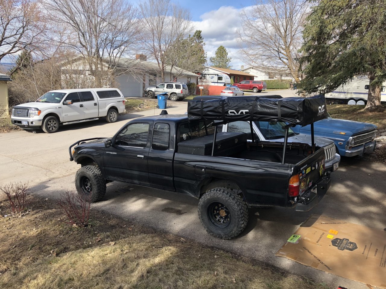

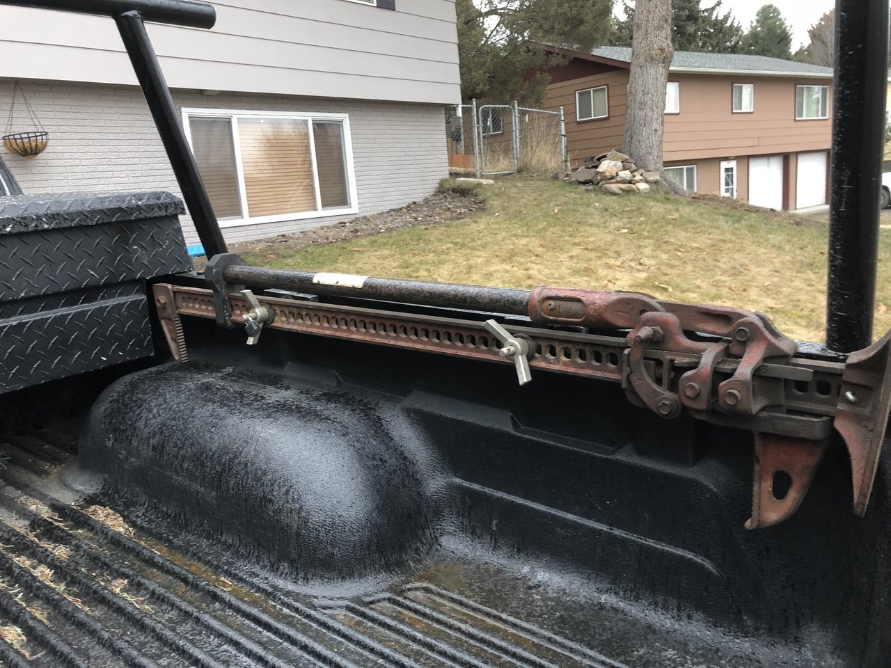

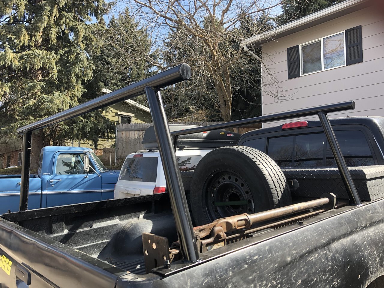

    Bedrack for my RTT and hi-lift mount:

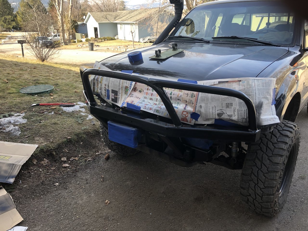

    Painted my front bumper with VHT engine enamel

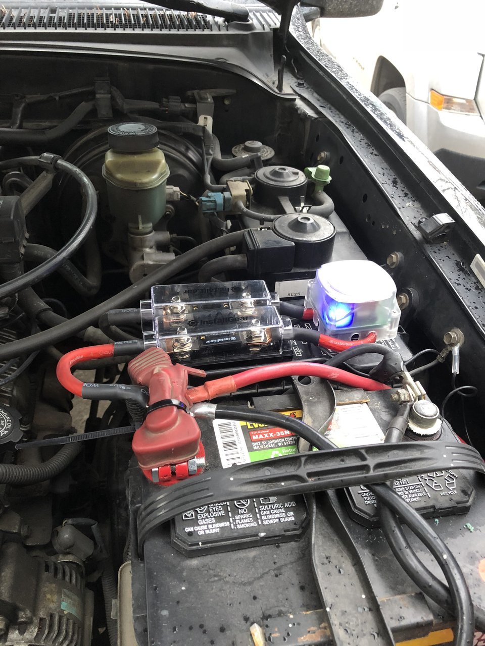

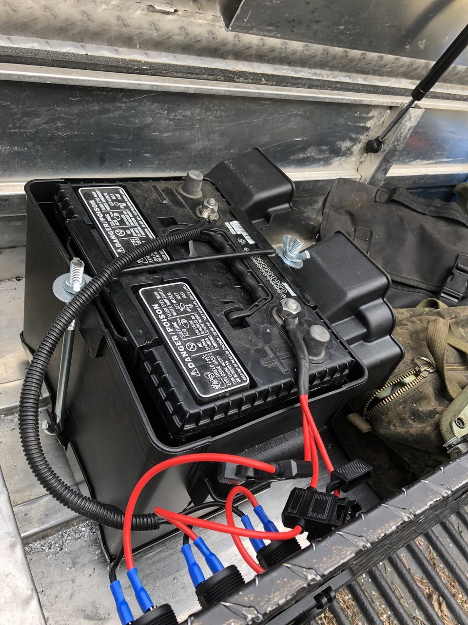

    Dual battery setup, cheap walmart marine Deep cycle mounted in the bed with an Amazon isolater

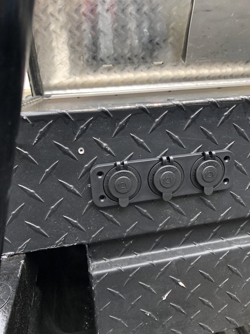

    also wired three 12v outlets to the bed box for RTT lights, heated blanket, etc:
    Works great for now, i'll clean up the underhood junctions some more, maybe relocate my aux. fuse panel into the bed box with the new battery. not sure. Maybe also save $$ for a Blue Sea isolater

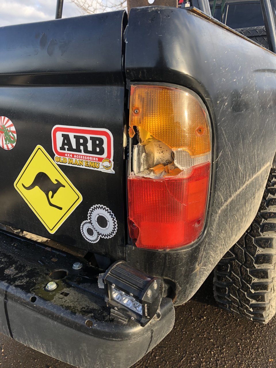

    Took a trip to dump some scrap metal....trying to kick a wasted longblock SBC off the tail gate was fun. spun a 180*, tipped off the side of the tailgate, bending the corner of it and destroying my effing taillight. add that to the Amazon wishlist! I should remember that's why I have a 69 Ford F-250 this kid of crap.

    Replaced my tail lights.

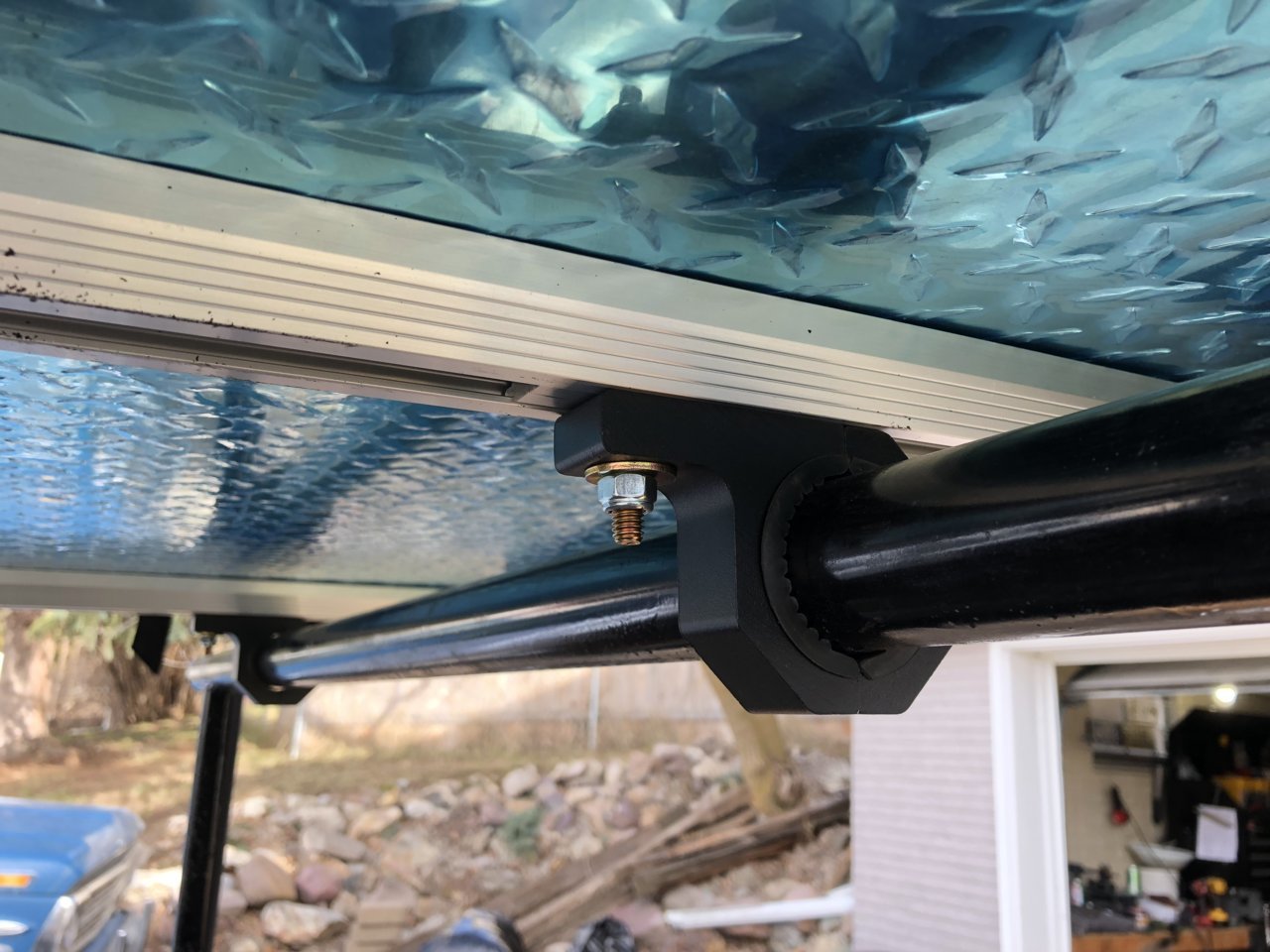

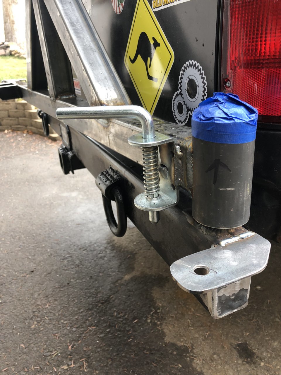

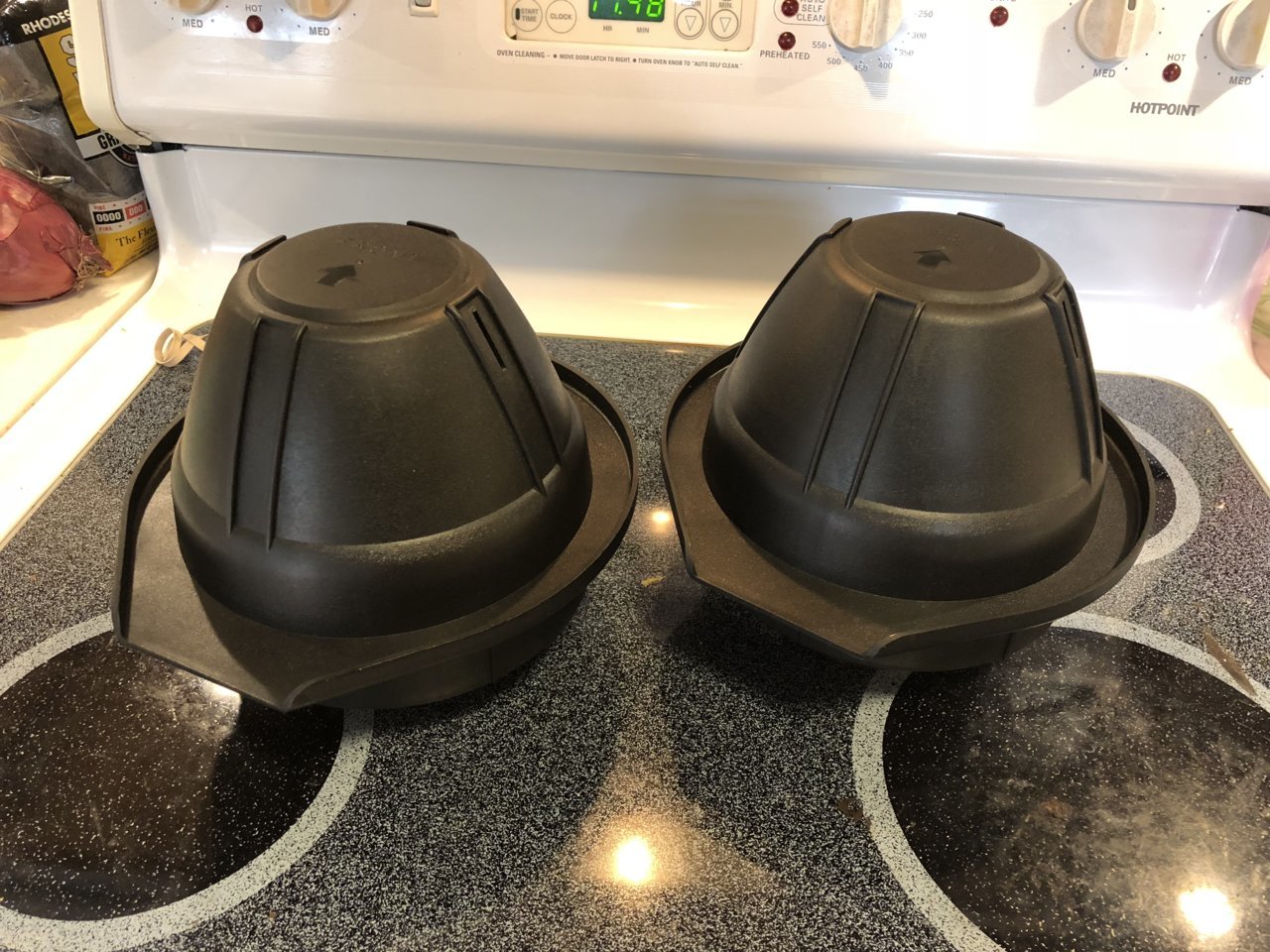

    Also bought four of these LED lightbar tube mounts to mount my RTT. it's been pretty windy almost everyday, so I haven't unfolded it all yet and sat in it lol
    Kinda wish I had my old 85's flatbed, and I'd make one of those big aluminum Aussie-style tray/canopy combos. Someday.

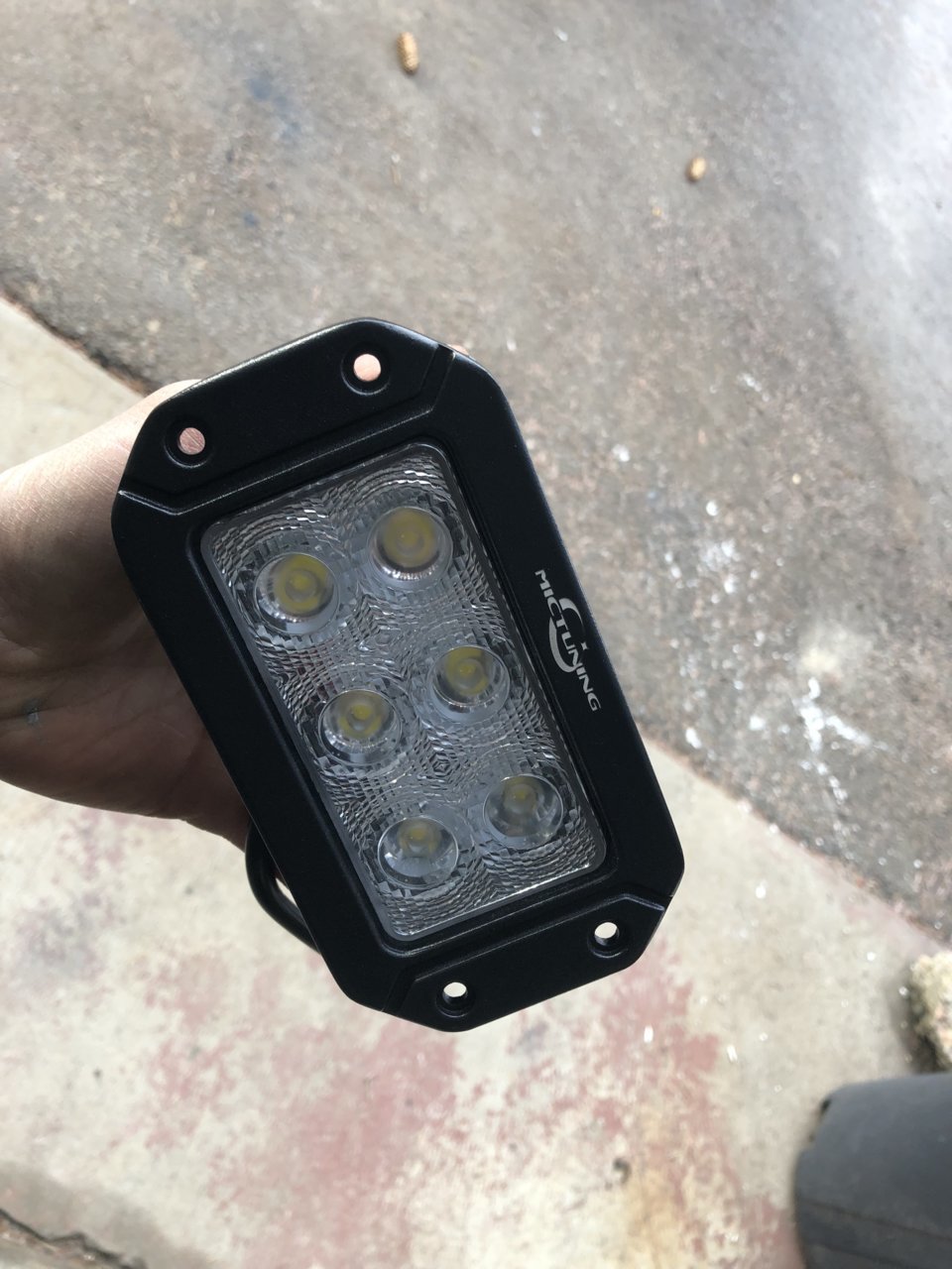

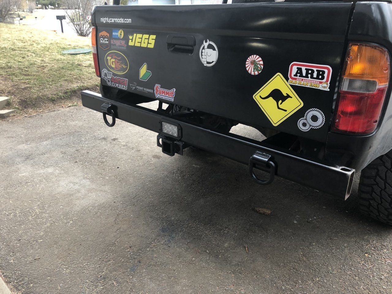

    Also started my rear bumper/swingout setup. Used an 18W LED from Amazon for a center backup light

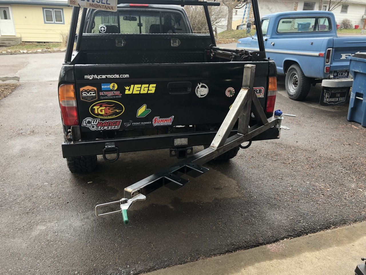

    got all mounts, receiver fabbed, d-rings, and cut the hole for the A to Z Fab spindle kit. that should come tomorrow.

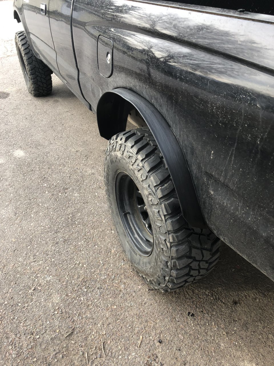

    Interesting idea for the fender flares, I may give it a try.

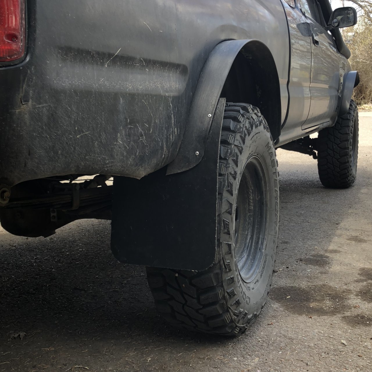

    I think buying some UHMV sheets from onlinemetals.com would look nicer, but this stuff was at Lowe's. I couldn't find factory 01-04 flares to retrofit, and the only other options are $400 Bushwackers. I might buy the ebay chinese ones for the front to see how they work. Me and the wife are making a serious effort to relocate to Oregon this year, their mudflap/flare laws are a little stricter than MT

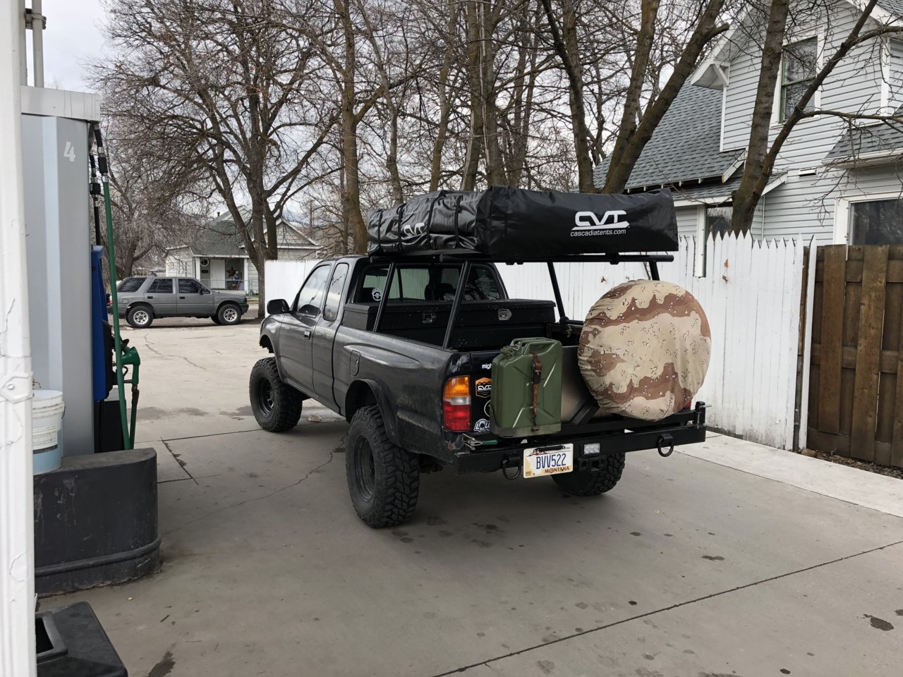

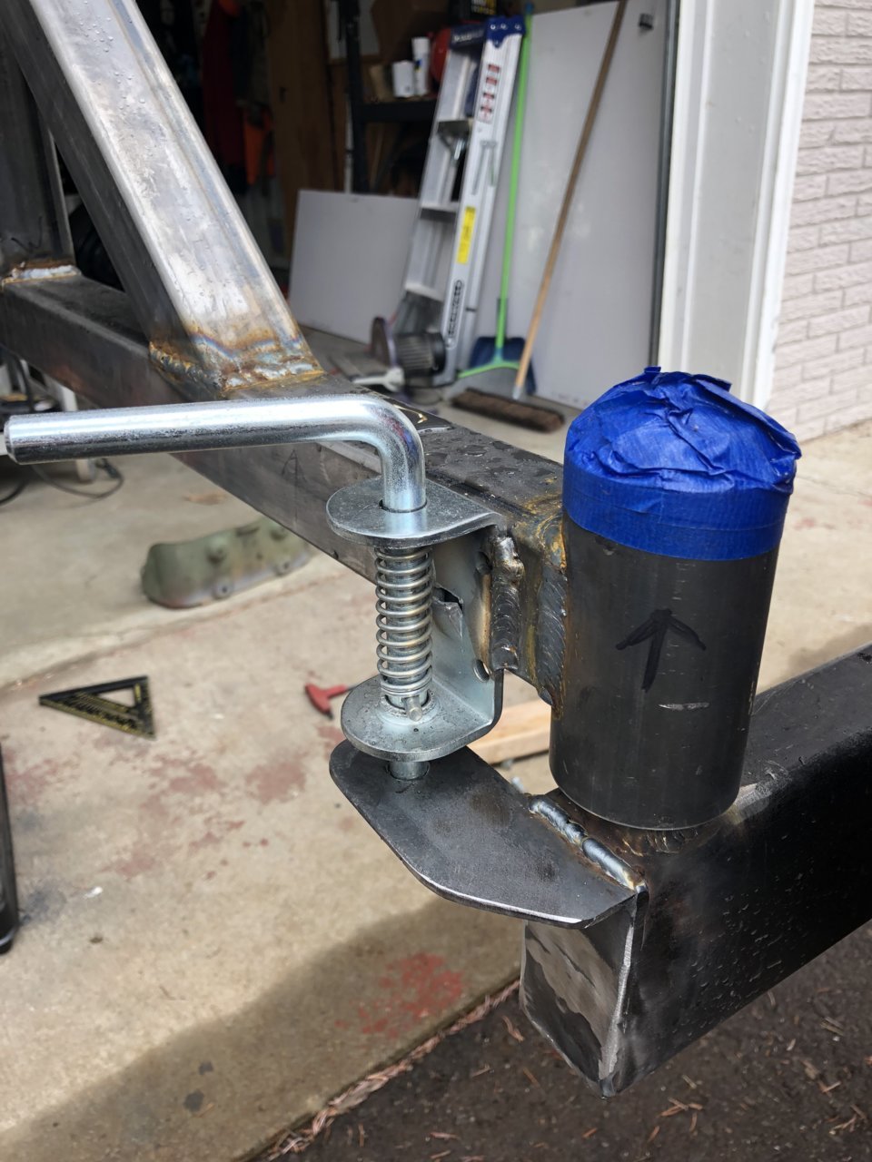

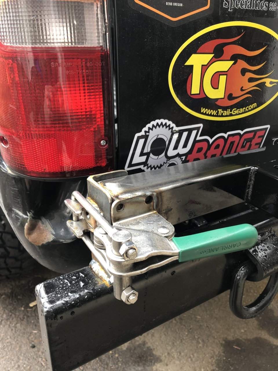

    Finally got the tire carrier done, mounted my nato can and spare. Gotta tackle my lower ball joints today because i'm moving to oregon in two weeks :DIMG_3621.jpg
    First time working with one of those Carr Lane cam latches. Took quite a bit of fiddling and thinking, but it works great now. Also bought the spring pin from HF to keep it held open

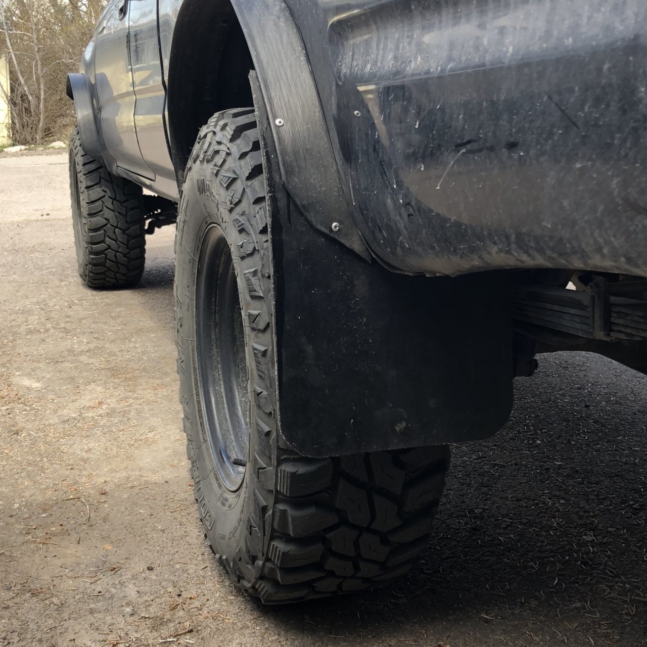

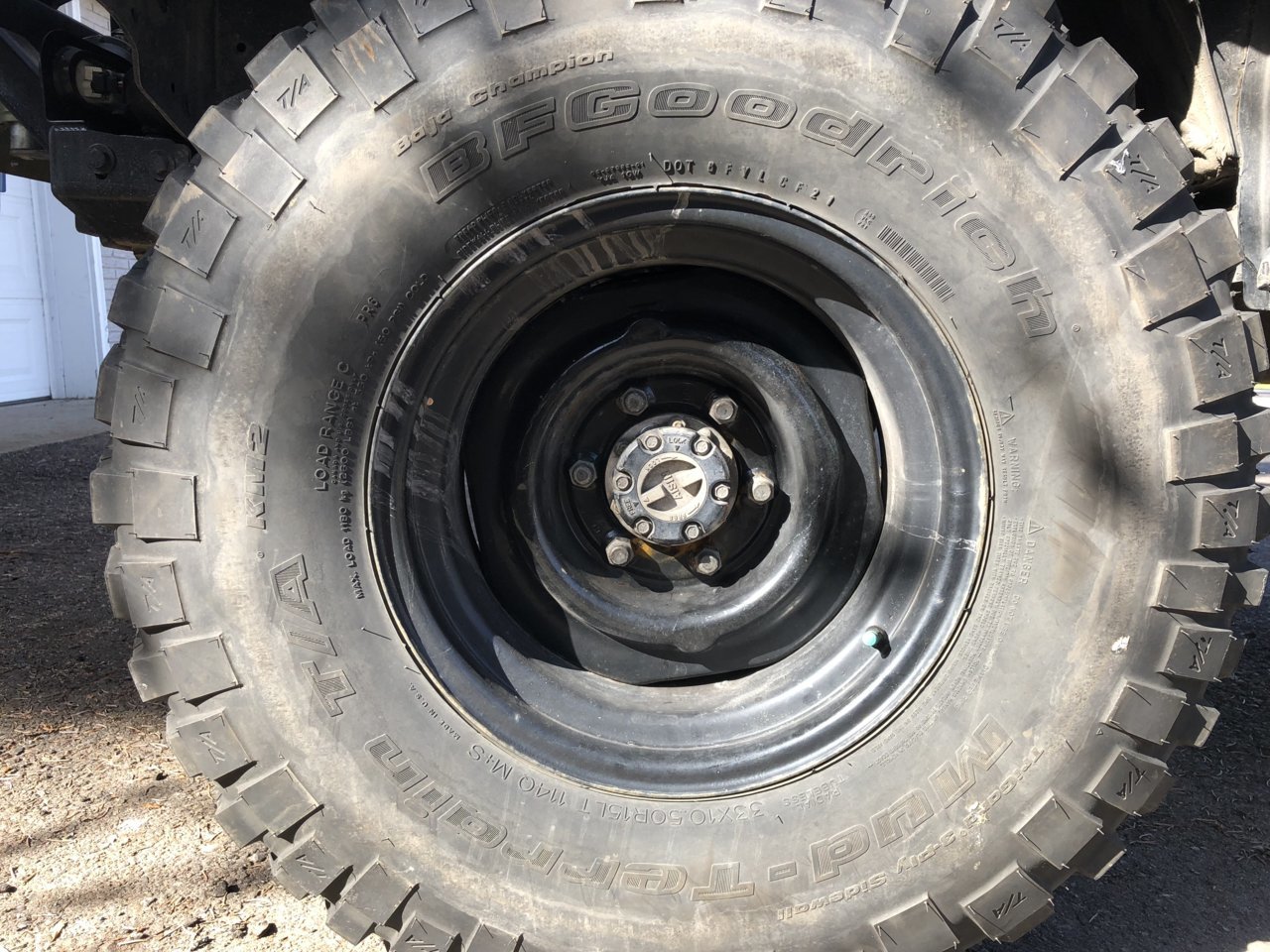

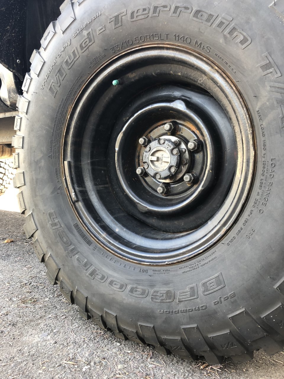

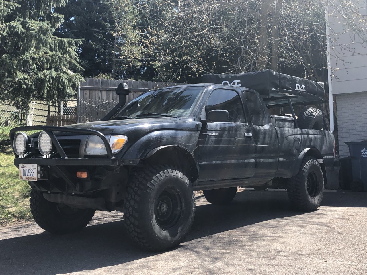

    Pics with the 33x10.50's
    thats with some squat in the rear from the RTT
    The wheels are kinda unique, factory 15x8 3.5BS from a Chevy CUCV Blazer, M1009. I like em. Centers were cutout for the big Toyota hubs

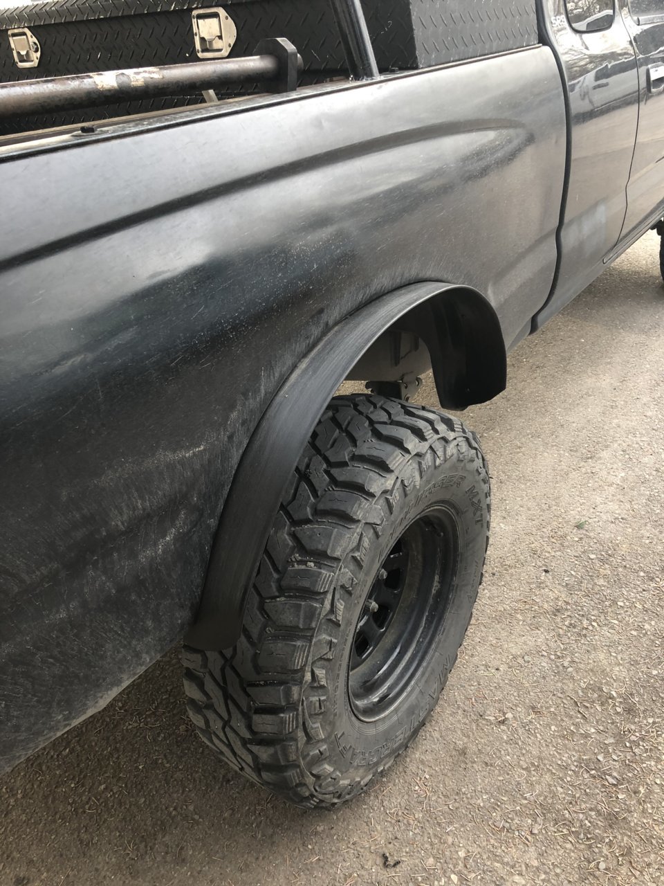

    More additions to my ugly ghetto flares...Oregon laws are a little stricter than MT i think

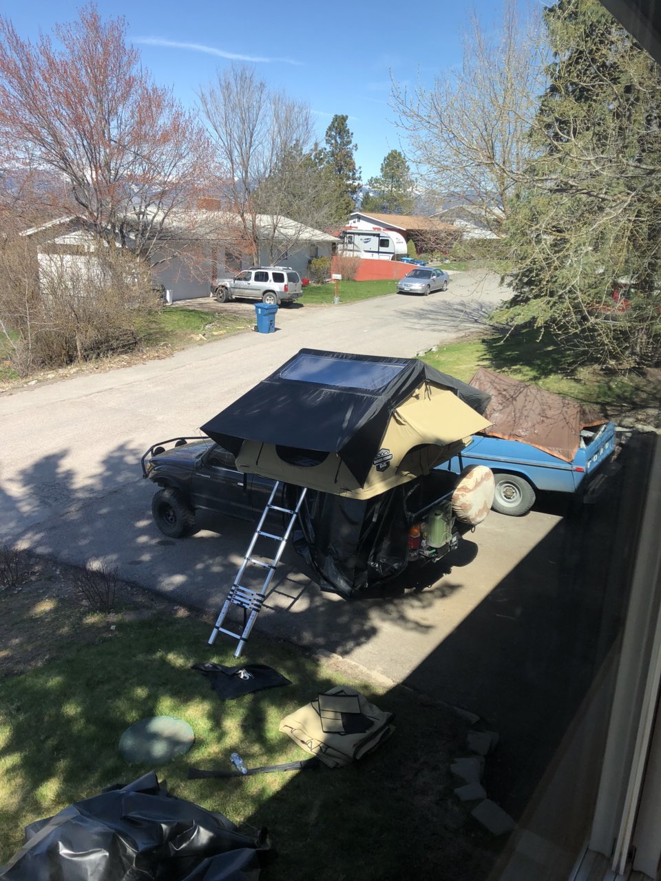

    Even folded out the RTT to make sure I had it all correct before packing up for Oregon
    Im excited to use it soon!
