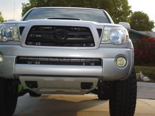

    On rick's pic, you can see the gap a lot better than on my pic. IMO, I think you should keep the gap and not worry about it.
    Nice rig, rick!
