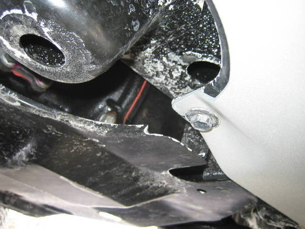

  14. Jan 3, 2009 at 8:51 PM
    #34
    JJ Customs
    JJ Customs Supreme Leader!
    Feb 24, 2008
    #4935
    5,770
    Jay
    NV
    Sierra Denali Ultimate, 6.2
    A few additions to make me feel cool.
    Here is a close up. I will look to see if I can find the instructions. If I remember right it only attaches with the two bottom bolts. The upper two have two black strips that run down the backside and tie into the bottom two. Hell hold on and I will go look. leave the factory one in place!

  17. Jan 3, 2009 at 8:56 PM
    #37
    JJ Customs
    Feb 24, 2008
    #4935
    5,770
    Jay
    NV
    Look at the pictures that have been posted and hold yours in place. You will see the correct holes if you do.

  20. Jan 4, 2009 at 10:23 AM
    #40
    Ticketdoctor
    Ticketdoctor Senior Lettuce Washer
    Dec 10, 2008
    #11440
    223
    Ithaca, NY
    09 Tacoma Double TRD O.R. 4x4 Timberland Mica
    XM Radio Mod, TRD Skid Plate, Bed Mat, Weathertech, More to come.
    I don't know why I was so concerned about installing the TRD Skid Plate. Very very easy to do. Took about 20 minutes if that.
    All you need is a 12 mm socket....
    There are four bolts that hold on your stock (black) skid plate.
    The two in the rear will need to be loosened (Not Removed).
    The two (2) bolts at the front will then need to be removed. These will not be used since the TRD skid plate comes with longer bolts and spacers.
    After you have loosened or removed the above noted bolts take the TRD Skid Plate and slide it under the two loosened rear bolts. Raise the front of the skid plate and screw in the bolts.
    My TRD Skid Plate had the bolts and spacers attached to the plate. All I needed to do was start tightening.
    Note: I left the stock skid plate on the truck.
