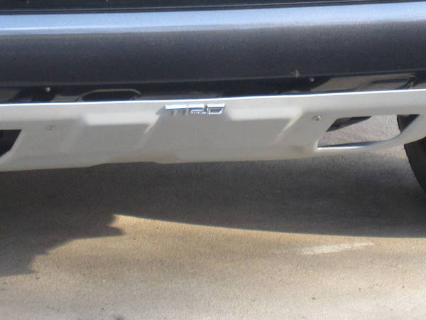

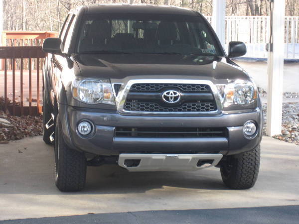

    Skid plate installed on top of black factory plate.

    I've had one on my '08 and now my '11, though you really couldn't tell on the '11 with it coated. Both installed right over the stock skid plate. Just remove the two front bolts and loosen the rear two, and use the provided bolts/spacer attached to the front of the skid plate and re-use the two rear bolts.
