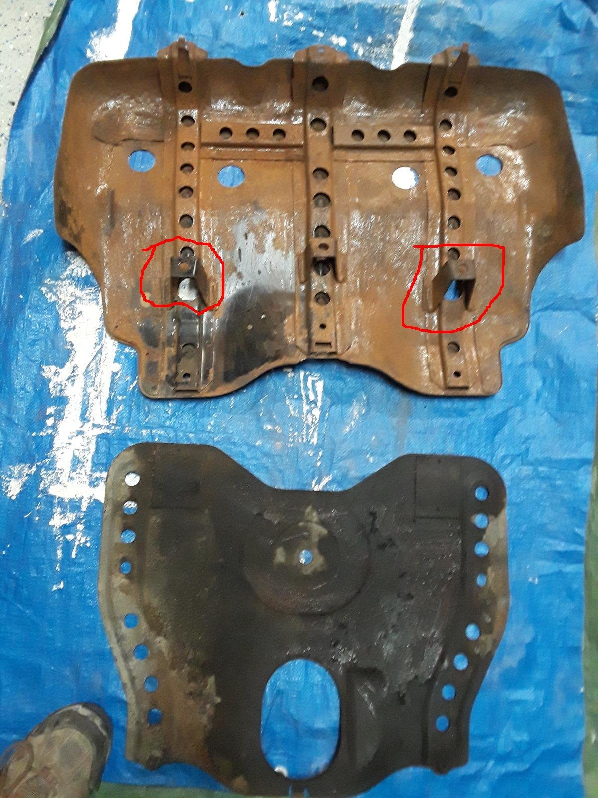

    If you haven't taken it out yet . . . . the skid is in two pieces, front and back. Take it out as one piece, don't disconnect the two pieces. They're a beotch to get back together under the truck.
    Get it jacked up and on stands, put some blocks under about the middle of the assembly which is around the back of the front plate. This will make it easier to drop the whole thing once it's loose without bending the fastening points.
    Get the front ones under the radiator out, then there are two deep holes you'll need an extension for, take those out. (See comment below about the brackets.) The front of the assembly should now drop down on the blocks.
    At this point you can see where it's still held up in the back, should be two more bolts at the corners. Take those out and it will drop it on the blocks. It's helpful to use the blocks when putting it back in.
    You'll probably see the inside is way worse off than the outside because water gets in there, settles, and accelerates rust. The "right way" would be to completely de-rust it chemically but wasn't worth the time to me. Take it outside, hit it with a wire wheel, get to as much metal as you can, wipe it down with acetone to get most of the dust out, primer then paint.

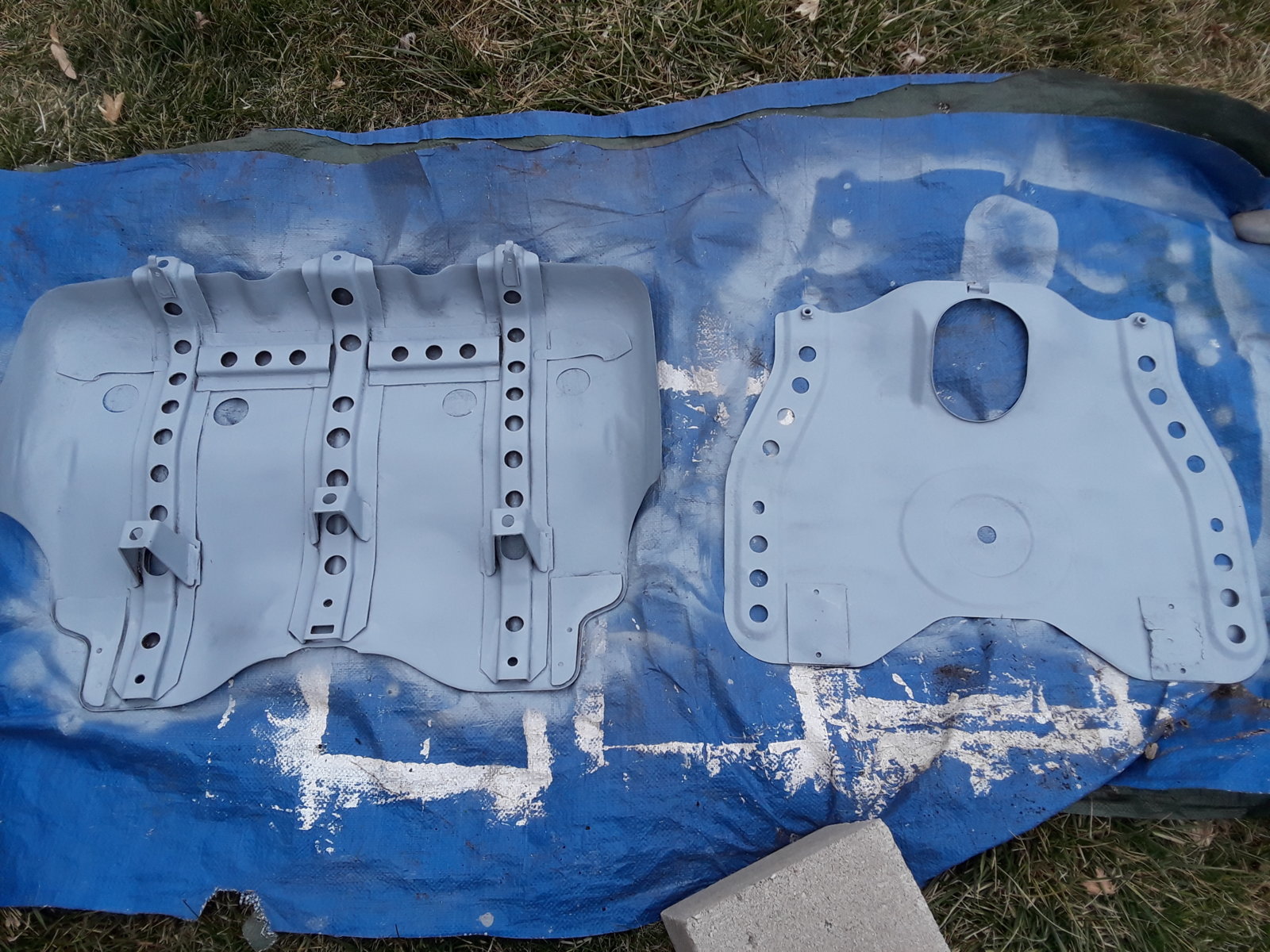

    Here's mine before I painted it both sides, you can zoom in and see all the holes. Note the three brackets on the middle of the front piece, the two outside ones are the ones you need an extension for to get the bolts out.
    If you DO take the two pieces apart, loosely put them together by the two bolts before putting it back in, it's a beotch to get it lined up right under the truck. I've had this thing on and off so many times I found this is the easiest way.

    See my previous post and pics. Across the middle of the front plate you will see three brackets. The middle one is just a spacer, but the outside ones get two bolts through them. I can't imagine how you'd get those out without an extension. :-D

    Can you post up a pic of your front skid?
    FWIW, I've owned a '98 and an '02 and the oem skids were identical. The front skid has two attach points to the engine crossmember a few inches ahead of the steering rack. Because of the design, those two bolts are recessed into the skid plate a bit and cannot be reached with a normal socket and need a short extension to be accessed.

    To use Bill's image, the two points circled in red are the attach points in question. @rocknbil

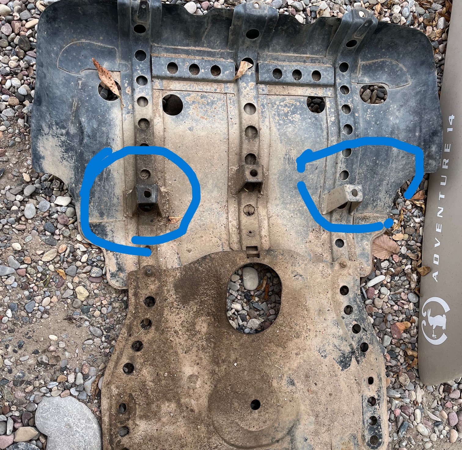

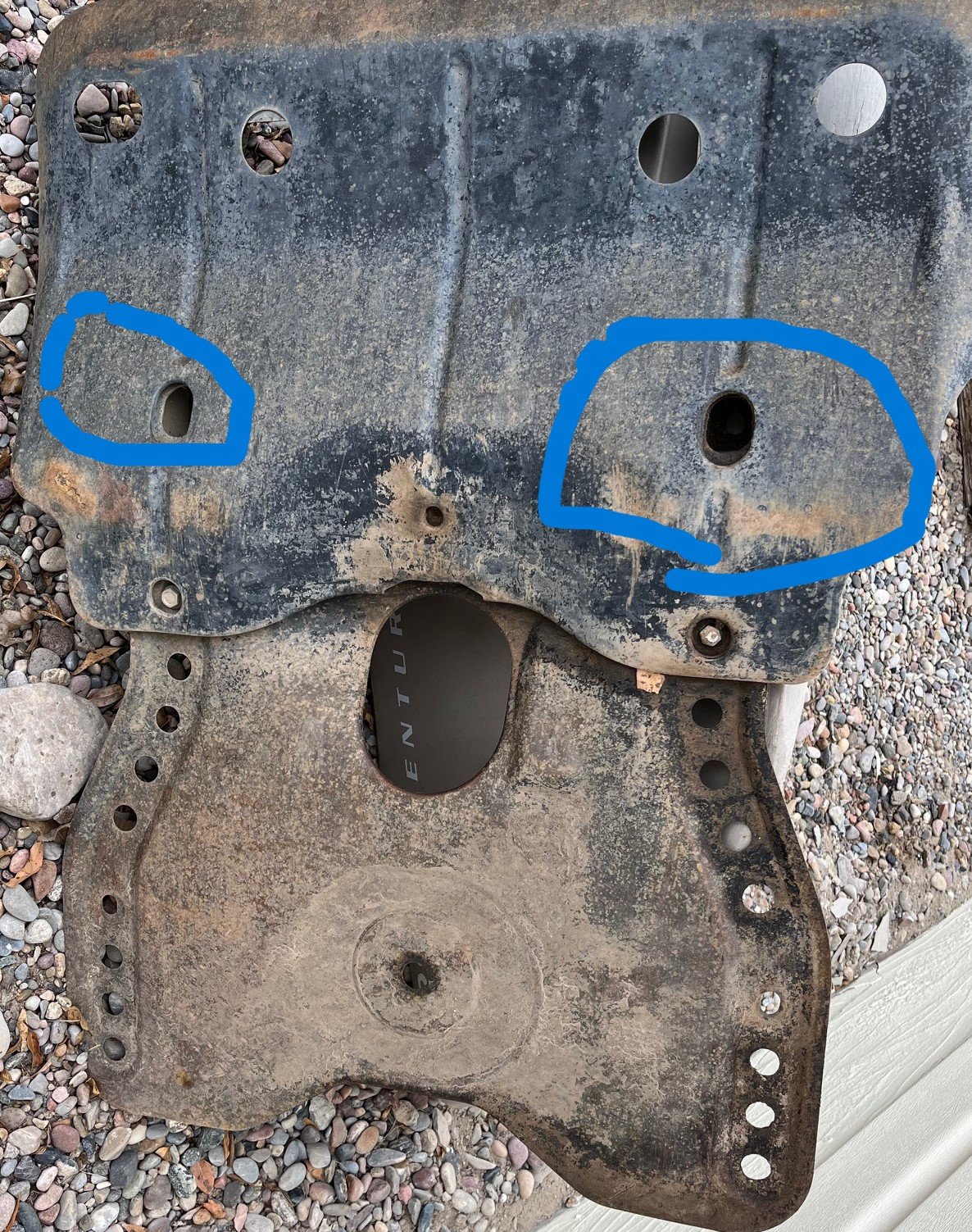

    Interesting...could be that someone before me threw those other two bolts away and I just never knew. You're saying these should have bolts in them? Mine never did since I've owned it. Since there are three of them but one doesn't have a bolt hole (what's up with that?), I think I just figured they were spacers/stabilizers or something. They never had bolts so I never gave them a second thought. I stand corrected!
