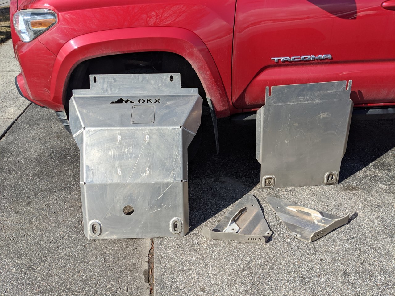

  3. Jul 6, 2020 at 2:19 PM
    HeyWannaTaco
    HeyWannaTaco Well-Known Member
    Feb 20, 2020
    #319814
    530
    Dan
    Ontario
    2019 Red DCLB SR5
    OVTuned, OKX Skids, AVS In-Channel, N-fab Predators
    buckwheeat likes this.
