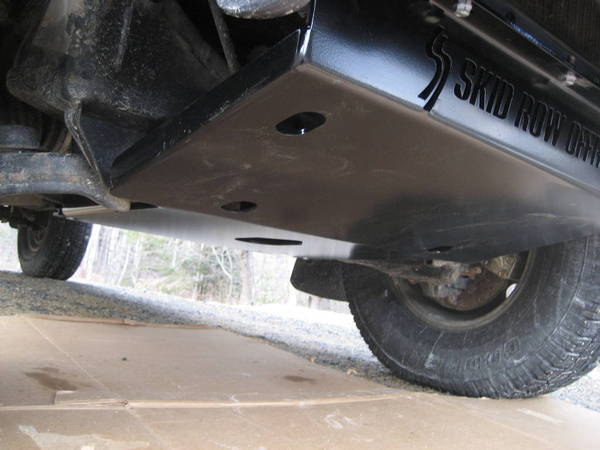

    I just installed the front skid, nice slotted holes so everything lines up nice. Haven't bought the other ones yet but plan to.

    i like their skid plate. i tried to order one without their logo cut-out, but they wouldn't sell me one:(.
