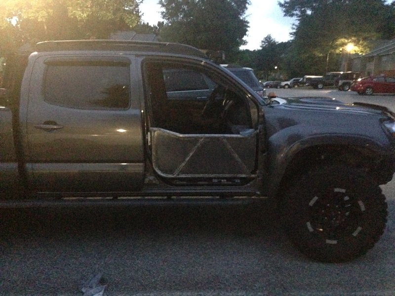

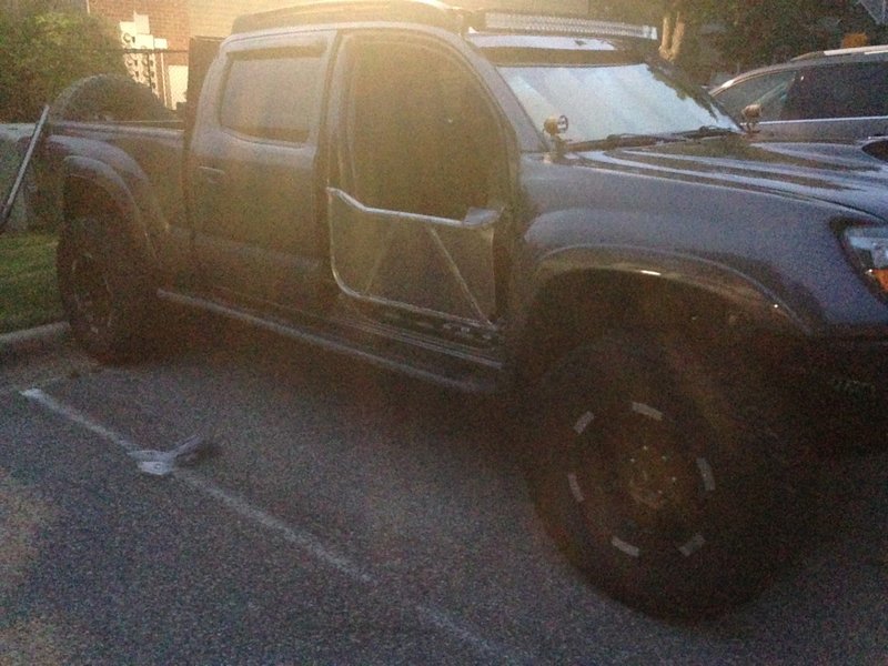

    Will do. Worst case, I'm looking at getting them powder coated monday next week. Test fitting tonight to make sure they all line up (and I gotta fab up a tab that hits the "door closed" rubber button thing so the light goes off on the dash and in the cab)

    You can probably use a rubber nub that can bolt on to the tube. Check you local hardware store in the furniture parts section. That should give you some ideas. Welding a small tab would be easy too though.

    Test fitted the doors before paint next week. Should have done this when I first got them, but everything fits fine and the hardest part was unplugging the 2 wire harnesses for the doors. Pics taken at night and the street light really made it grainy, sorry.

    Those plates you welded in make a huge difference on how those door look! Good job man! Truck looks awesome!
