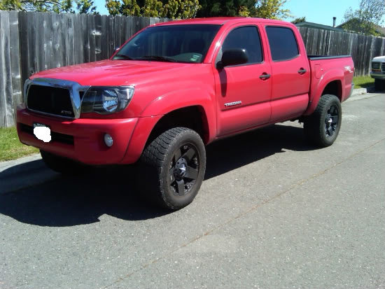

    I have the kit that your referring too. I like it, I had 295/70/17 on it for a while but now im back down to a 285/75/18. IMG00067-20100504-1157-1_0eecff6375c737b7b8495b56b47cae4b76a01b94.jpg
