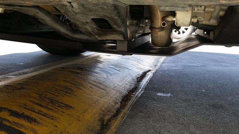

    I just got a Skid from BPF, plus a heavy duty tow hook bracket.

    Are you happy with that exposed face where it goes under the exhaust pipe? I wouldn't be. Do you take this vehicle off road much?

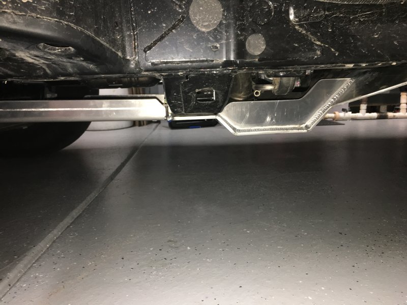

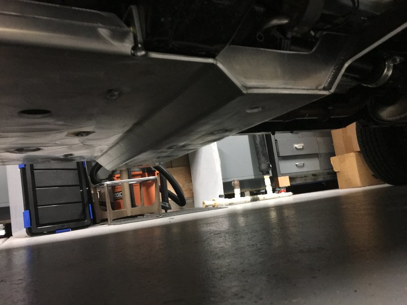

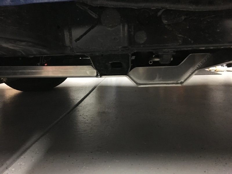

    Do you have an exhaust reroute? It looks like it but I can't quite tell.
  15. Oct 24, 2016 at 8:19 AM
    #35
    RelentlessFab
    RelentlessFab Eric @Relentless Fab Vendor
    Feb 17, 2008
    #4772
    15,817
    Eric
    Sparks, NV
    07 AC 6mt>03 SR5 >08 Sport and 17 6MT TRD OR
    Relentless Armored! Too many others to list.
    Thats dropped to clear stock cross over. No re-route

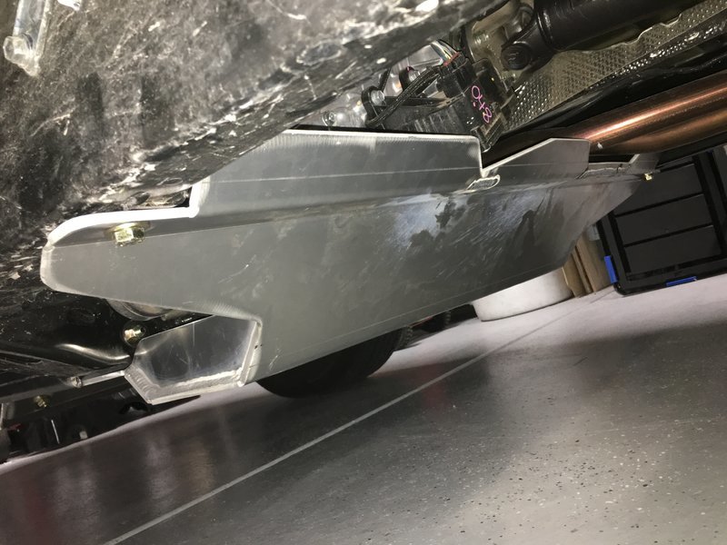

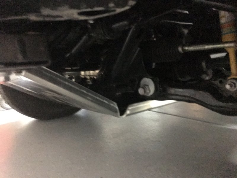

    I've wheeled plenty with skids with the drop for the exhaust crossover, not the end of the world. I havent found a spot where it has prevented me from forward motion. That said, if you're concerned then simply reroute and we can make flat skids.
    In your pic above I see exposed hardware and seams in the skids, I don't like having either of those on my parts so my designs are different. We also incorporate formed or boxed/welded caps on the edges for additional strength and rigidity over the open ended design. To each his own from the design perspective.
