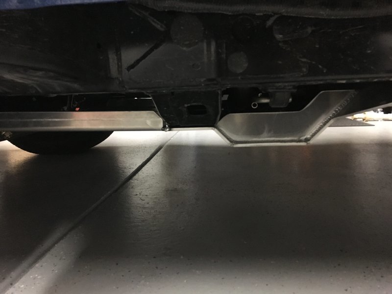

    How does the rear of the IFS skid attach to the cross member?

    Both middle and rear have drop spacer tubes welded on to the top side of the skid that have a welded on cap with slotted holes to bolt through. Recesses the bolts up into the skid so the heads aren't vulnerable and also puts the skid in position that it clears a 1" diff drop

    I'm not asking if it will suppress an IED, I'm asking how it does when you try and drag that nob over a rock.

    It is more of an inclined plane than an exposed face, right? It should just slide up over whatever you are trying to clear. One reason to go steel instead of aluminum since it slides better.

    Are you looking at this photo? That looks to be a 60 degree angle

    They're 45deg brakes
