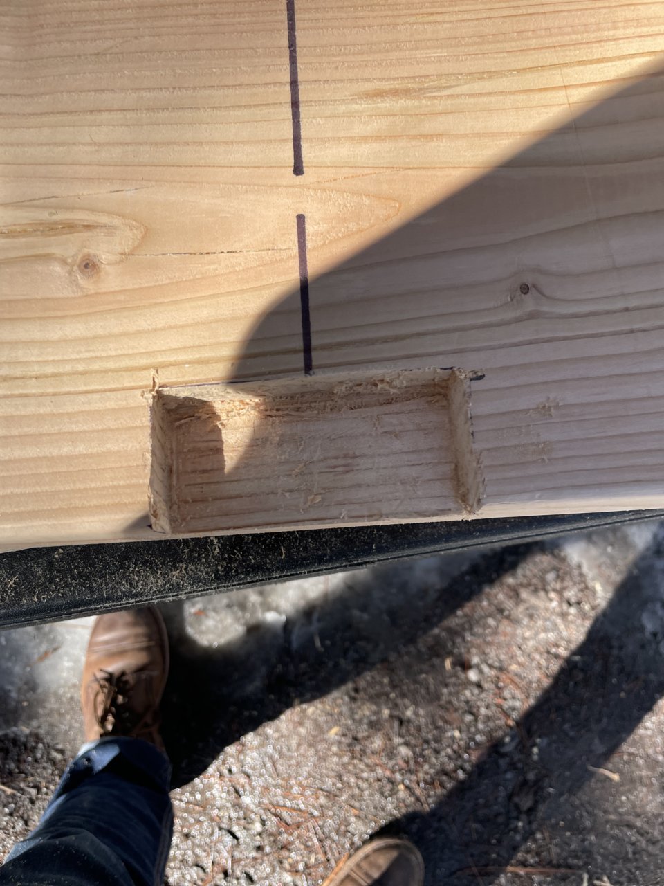

    Finally finished mine. I just notched the 2x6

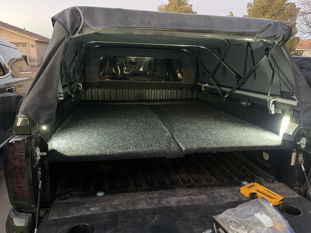

    So glad I found this thread (and this forum). I stopped by the lumberyard today, got some 2x8s & fit ‘em in.
    I’m looking to finish mine before my annual camping trip next month.
    A question for y’all who have completed it - what type of surface cover did you use on the plywood? Outdoor carpet? Marine? Just weighing my options & I appreciate your responses in advance!

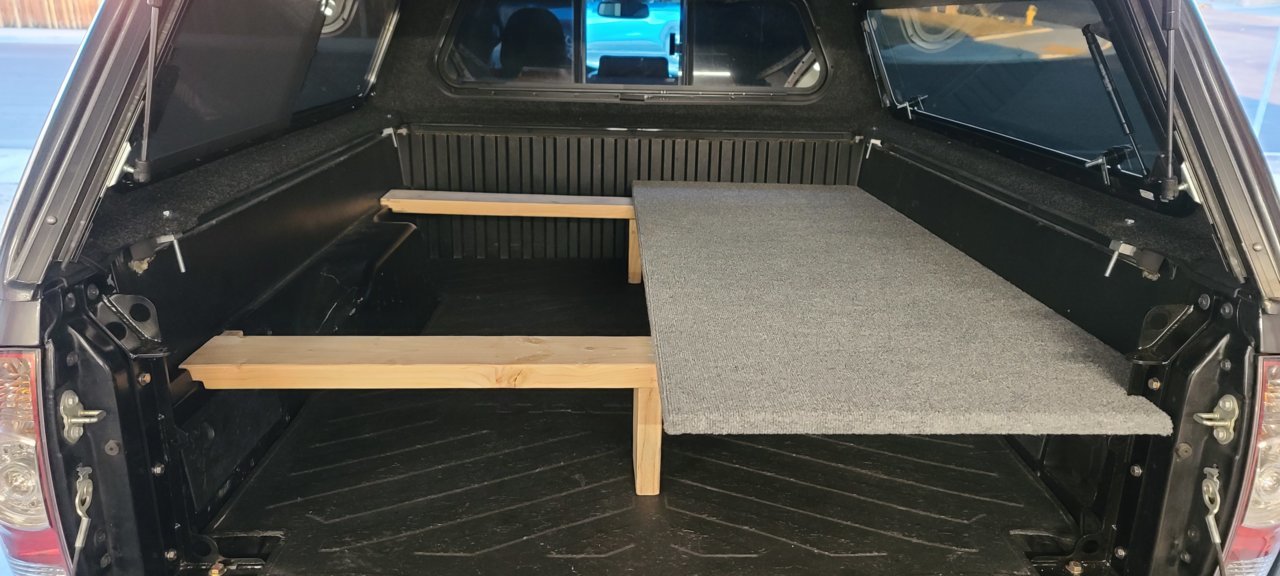

    I did this as well and then notched out the center of them to run a 2x4 down the middle.

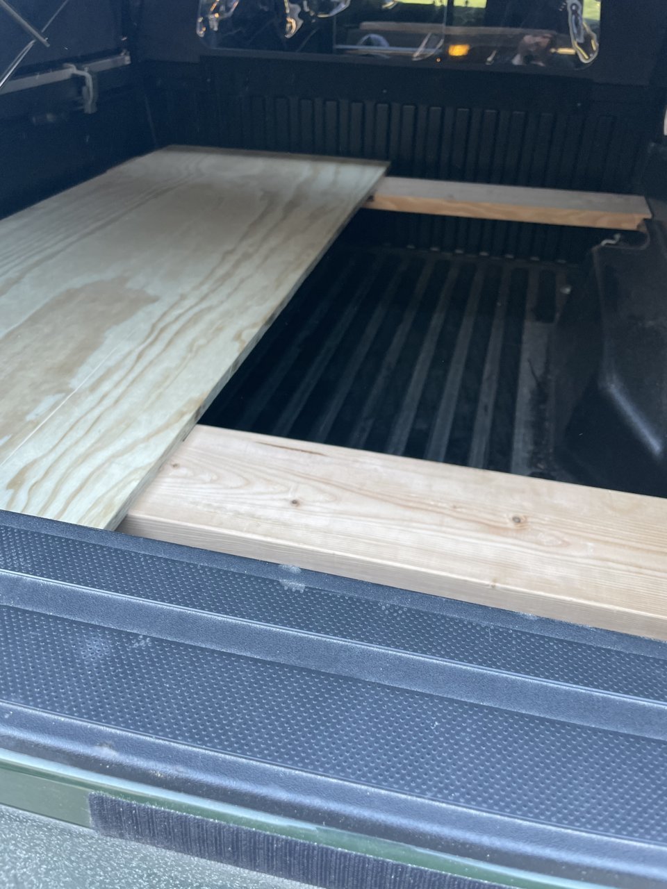

    A deck board is the perfect height. Don't even need to notch it like you would a 2x6. My platform with deck boards has had over 500lbs on it bouncing around off-road and it's been fine.

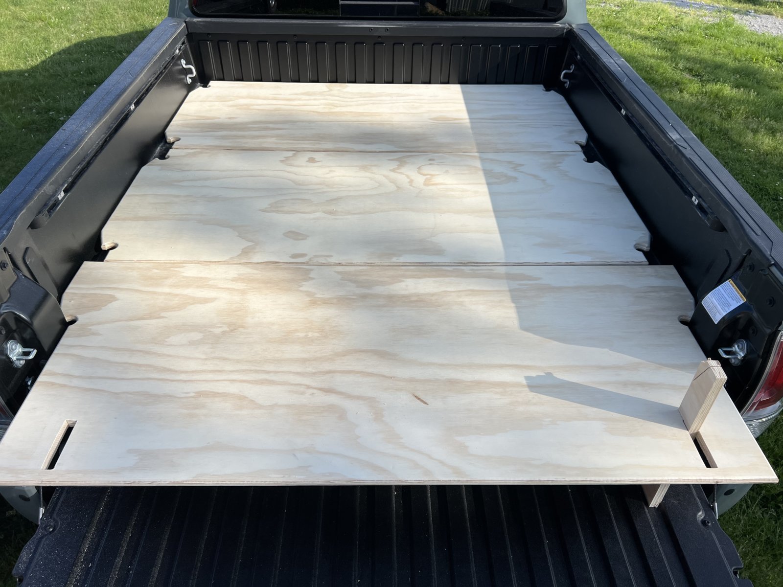

    Neither! No 2x’s. I studied the bam beds and this is what I came up with. I’ll make the support legs and cut some handle holes tomorrow. 2 sheets of 3/4 grade a sanded pine plywood. $55 each. $20 jig saw. $27 router bit.

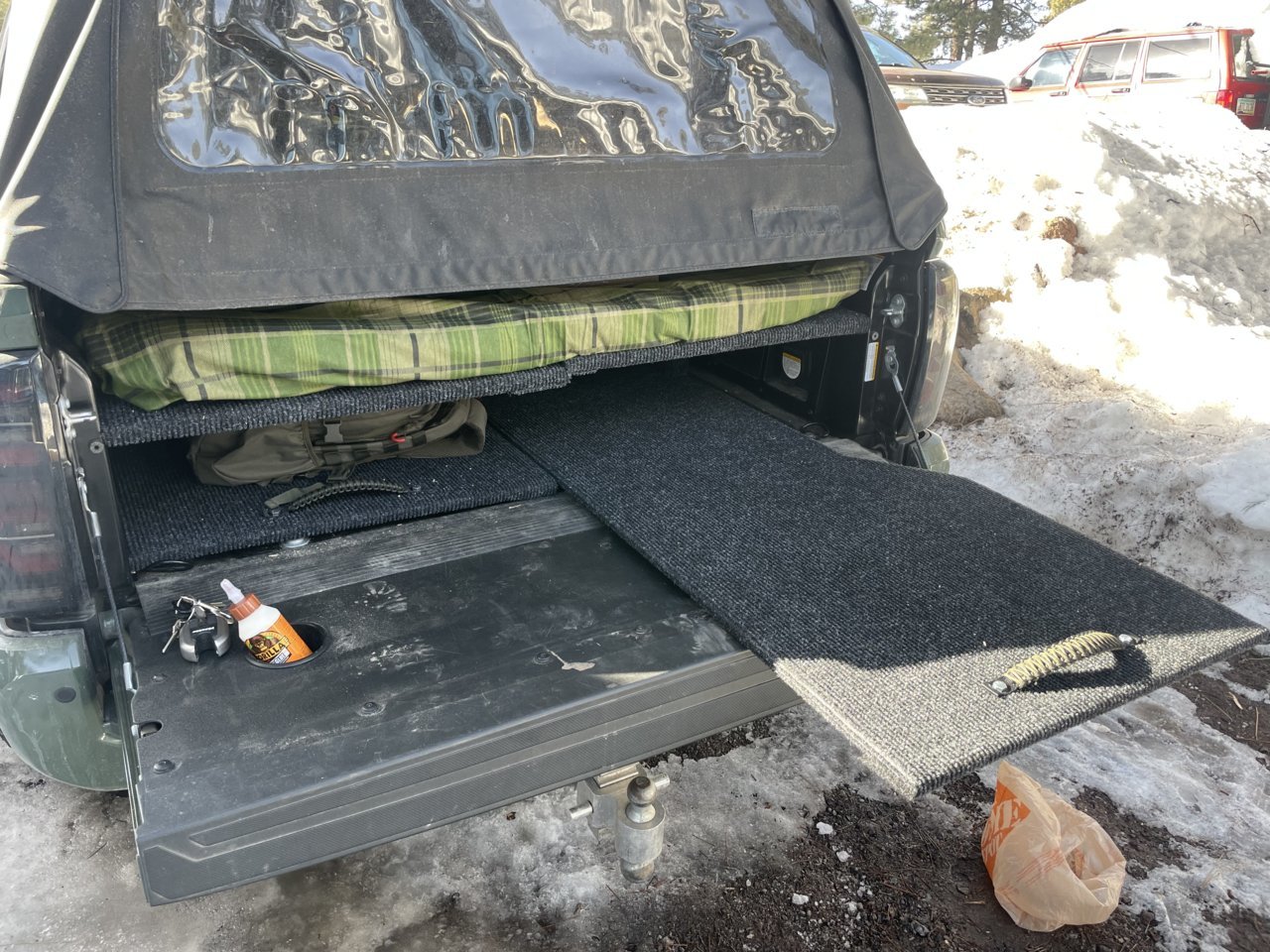

    I built and tested a sleeping platform this Memorial Day weekend. I have a short bed so I used the Adjustable Tailgate "Cables" chain hack here and I built an overhang from some Nylon ripstop fabric and adhesive velcro to give room for my feet. It absolutely poured rain overnight, and once I swapped from the mesh window to the vinyl window, it was surprisingly completely dry. Not saying it looks professional or isn't fussy, but it works and was very cheap. I also built it so that I can haul a bike in the bed.
