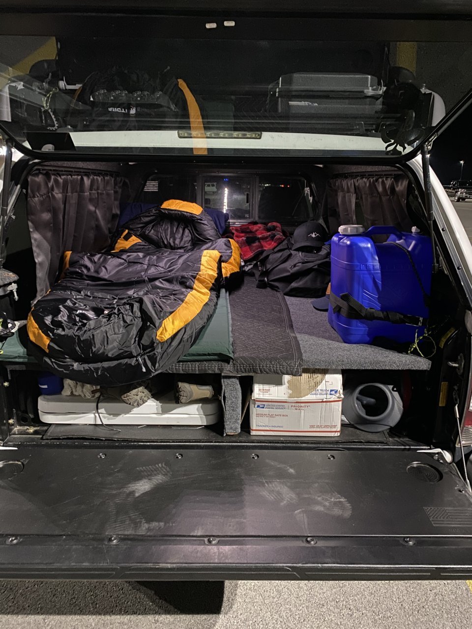

    Here's my setup. Need to re-staple the carpeting on the wood, but it worked pretty awesome. 9 day road trip around the Great Lakes.
    Recommend buying battery operated LED adhesive light strips, then sticking the adhesive side to adhesive-sided Velcro and placing them on the ceiling of the cap.

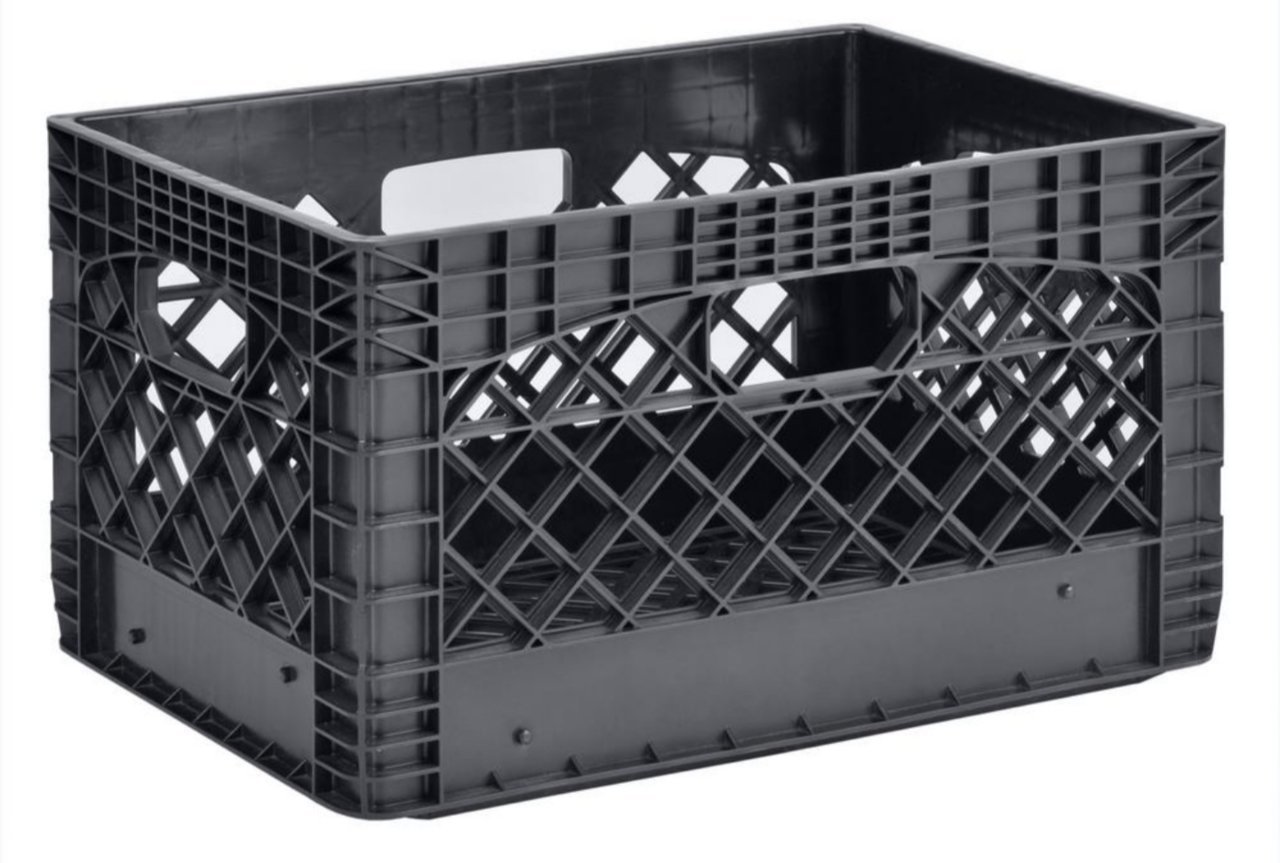

    1/2" or 3/4" plywood on top of 4 to 6 milk crates. Use drywall screws, they'll go right into the plastic milk crates. Cut a side out of the milk crates and use them for storage. The 6 gallon crates are awesome for storage. I've done this a few times. You can make the platform any size you want, more narrow and have room to roll a mountain bike in.

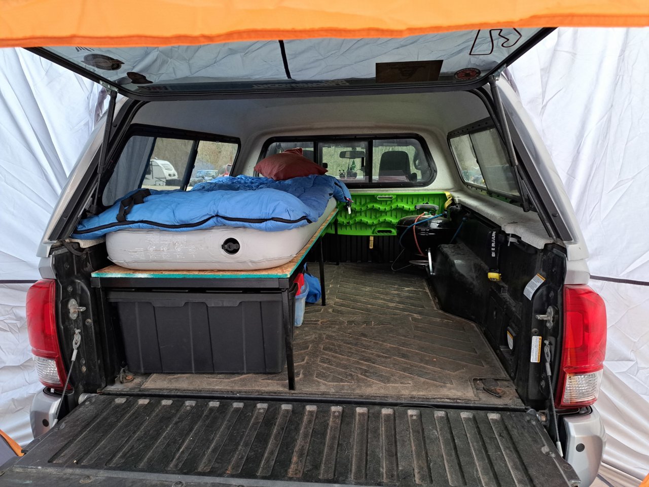

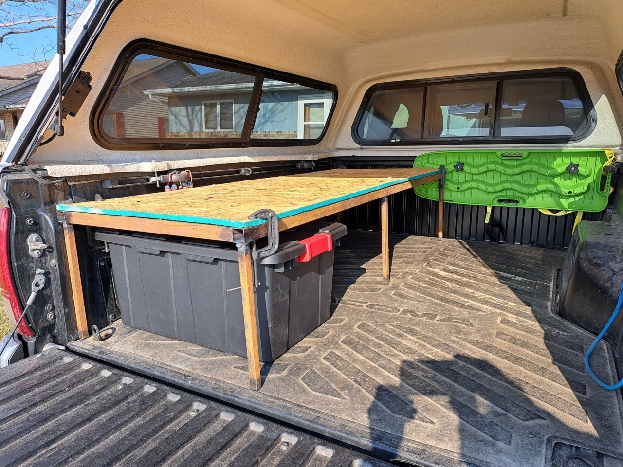

    The start of my setup:

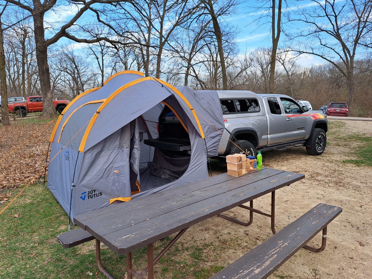

    6' bed, so it really doesn't help OP. A drawer would be nice but I am installing a flexible solar panel on the roof of the cap and will have a battery/power station under the platform. LED strip lights will be attached to the roof of the cap and I will figure out some form of curtains for the windows. And for a little extra room when parked, I bought this tent setup:
    It's free standing when you disconnect the 4 straps, so you can set up, go exploring for the day and back up to it and re-attach in minutes. I figure, if the weather is crappy, I can set up a table and chair in the tent to hang out. Or, a person could put a sleeping bag on a cot. Lotta windows, so it breathes well.
