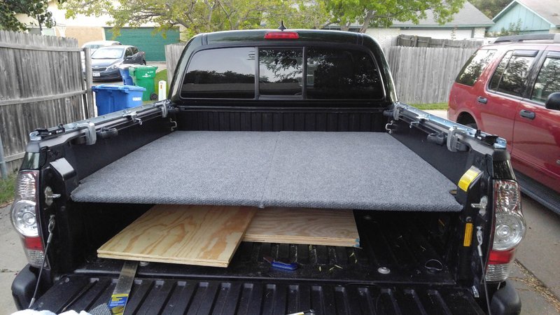

    I just finished mine this evening.
    Will only use it for camping and when I have my softopper on.

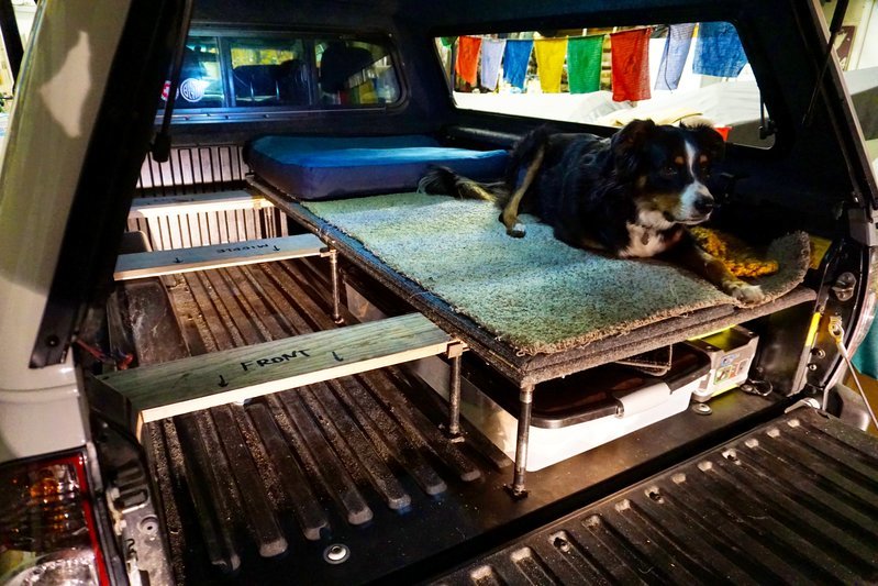

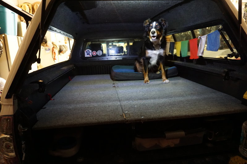

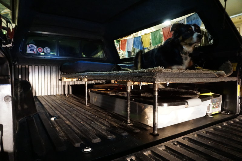

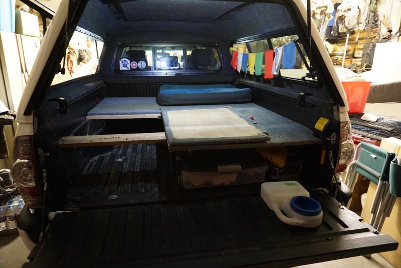

    image.jpg image.jpg image.jpg image.jpg I built mine out with the capability to fold in half when I need the additional space for larger gear! Pretty stoked on it

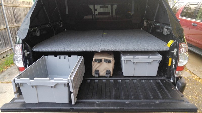

    Just got my containers in today.
    will slide them under the bed. Along with canopy, fishing gear, tripods and timelapse tracking dolley
    Edited to add:
    I added 1.5 inch shims under the support beams to gain enough height for the 9 inch tall plastic containers.
    Same wood left over from cutting the 2x6's
    All six will fit. Slide in the first four vertical, the last ones horizontal.

    Its a short. So not all six will fit under there.
    Could turn one side sideways.
    They just came as a 6 pack.
    The rest of my gear will go on top of the bed.
    Edited my first post...
    Just went out and spaced them leaving the center area I will need for longer gear.

    What are you using to support the platform? Not sure I have 9" under there, thought I was right at 8". I'll have to double check.

    I added a 1.5 inch shims under the support beams to gain enough height.

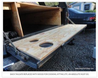

  16. Sep 19, 2016 at 7:14 PM
    #96
    gmajor
    gmajor Well-Known Member
    Aug 17, 2016
    #194879
    121
    Still curious whether anyone has done the mod in the post quoted above. Seems like it could be quite nice!
  17. Sep 20, 2016 at 6:13 PM
    #97
    tacorgidor
    tacorgidor I4C4LO
    Nov 15, 2014
    #142419
    1,054
    SoCal - LA area
    '15 MGM DCLB 4X4
    Billie 5100's all around, 885's, Dakars, Wet Okole front seat covers, Weather Tech mats front and rear, NFab nerf bars, front mud flaps removed, hoseclamp tailgate mod, front badge color match, cb antennae mount in a bed cleat, 4' Wilson antennae, salex console organizer, led's in map and dome lights, plasti dip all badges black, bedside stickers removed, OEM exhaust tip, plastidip hood scoop black, bed rail mounted military can, maglite seat mount mod, TRD shift knob, OEM bed mat, bottle opener bed mod, window tint on fronts, uniden 520xl cb, Redline hood struts, OEM front skid plate(silver),RuggedT bedside decals, Yakima cross bars and Yakima Load Warrior basket, cali raised amber pod, cali raised 31" light bar in lower valence, painted engine cover, 7 pin relocate. Blue sea fuse box, Softopper black. Shmelfab sliders
    I like that idea for a tailgate food/prep area, nice and smooth, and the cupholders are bonus! They put 13 cup holders in our trucks but none on the tailgate where they are most needed!
    gmajor[QUOTED] likes this.
  18. Sep 20, 2016 at 9:20 PM
    #98
    Bajatacoma
    Bajatacoma Well-Known Member
    Dec 10, 2010
    #47503
    1,926
    SC
    05 TRD Off-Road, SR5, 6 speed
    Yes, but I used a piece of HDPE (like cutting board material). The stuff is kind of expensive so while I wanted a black piece, the local plastics place had a white piece off of a larger sheet that would work for a good price so that's what I went with. I measured it to fit, drilled my holes through it and the tailgate then countersunk the holes and added screws. I used some of that spray paint designed for plastics which has held up better than I expected but if I were to do it over I'd get some black dye and try that, or just leave it white. You don't need a very thick/heavy piece, just thick enough not to flex under the weight of your knees I figured, plus I didn’t want to lose any more bed length. In addition to being a much better surface for cooking or other small tasks, it is much nicer to sit on and it’s a lot easier on my aging knees when climbing in the back. I did not bother to cut holes for drinks/a stove/whatever those holes are for as my stoves are plenty stabile on a flat surface. The only thing I worry about is if my tailgate gets stuck again and I have to take the panel off to access the release rods (cheap-assed Toyota plastic clips on the release rods). I can use a stubby screwdriver like I did last time but it’s a PITA. On my last Tacoma I had a piece of plywood but the plastic cleans up easier and looks better.
    In my old Tacoma I tried the forward shelf and while it’s a great idea and works well, I prefer my head at the front of the bed for whatever reason. If you have two people you pretty much have to use a shelf or move everything out of the back.
