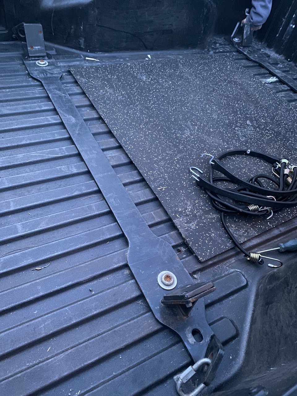

    Hi everyone, a little advice would be appreciated. I’ve purchased a slide in camper for my 2020 taco DCLB. The camper was previously in a 2nd Gen DCLB with airbags. I plan on going a similar route.
    I was hoping to tie it down to some heavy duty d-rings to the frame box bolts as that seems easiest.
    My question is, what are these flat bars called? Do I need them? The seller said they were made by Four wheel campers for their campers specifically, however I can’t find any info on them.

    I was actually going to say the same thing as well. Glad you're ahead of it! If I had to guess, those flat bars are some sort of bed stiffener system just to add strength to the box. Not sure if you need them or not, but at minimum you should be running regular bed stiffeners.

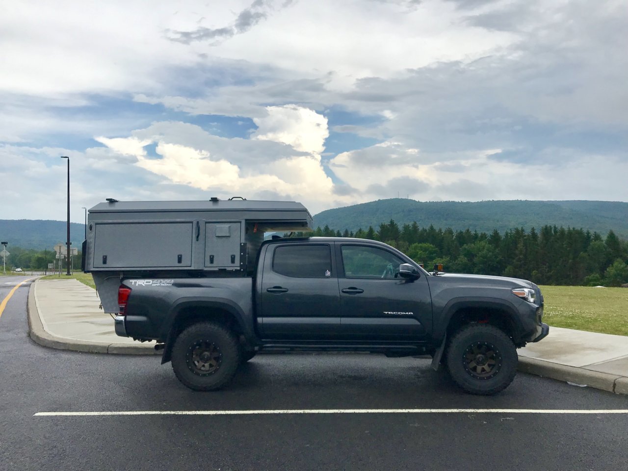

    my Alu-Cab came with very similar brackets. They bolt to the bed (really through the bed) and into the frame. The camper is than attached to them via turn buckles or some other attachment. A slide in camper shouldn’t need bed stiffeners unless it’s not what I’m imagining. My slide in doesn’t contact the outside of the bed one bit... pics of the camper may help however.
    My camper connects to a very similar bracket at the very front of the bed the rear of mine goes to a hitch mounted attachment but the long bed setup has a matching rear bracket like yours.

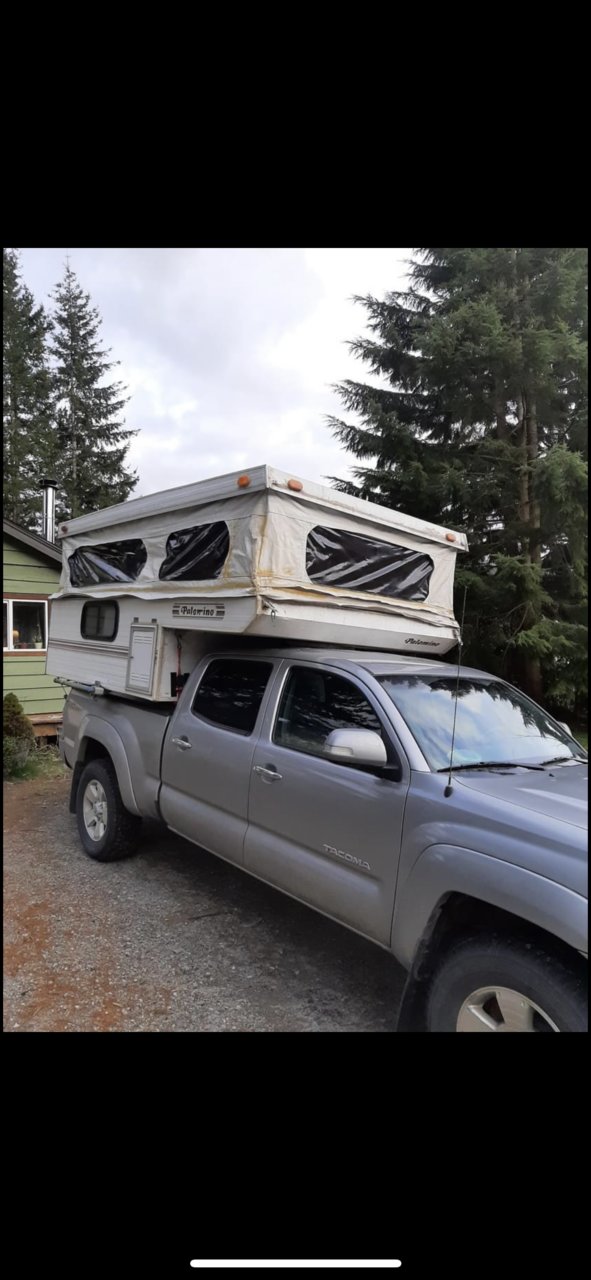

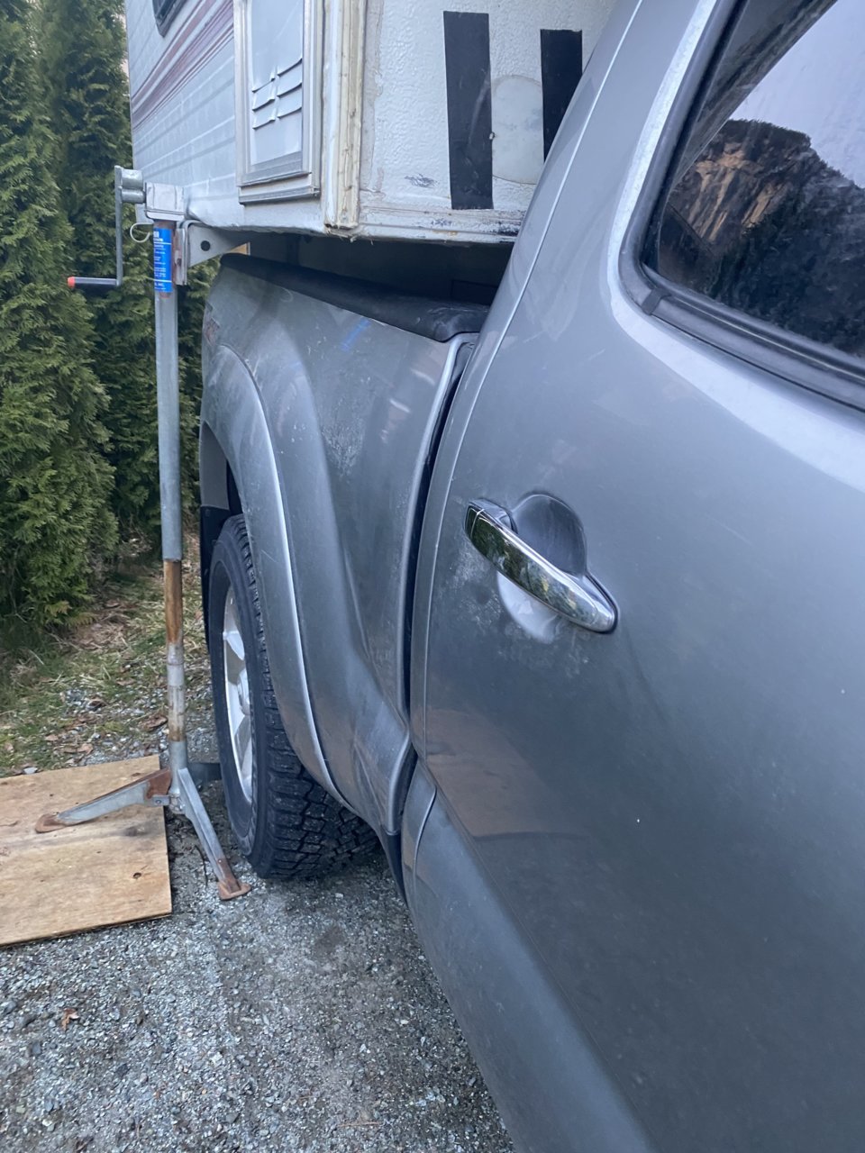

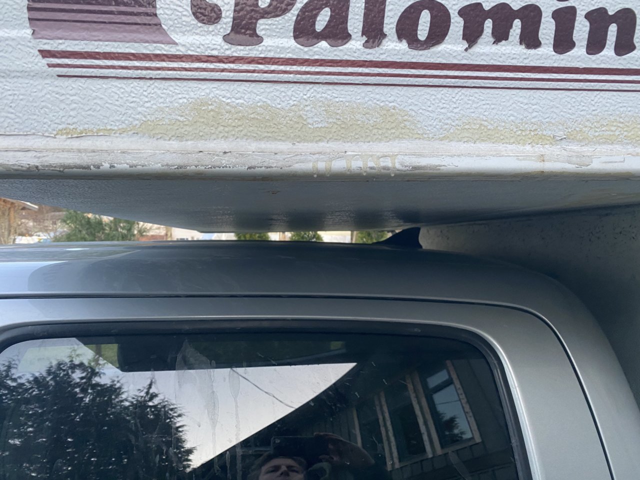

    This camper was originally for a Ford ranger so it’s actually narrower. The height shouldn’t be much of an issue as the bed floor to top of shark fin is the same or very close, to a 2nd Gen (I measured this am).
    I think I’ll build a 4x4 pressure treated frame for it to keep it centered in the bed.
    In addition, I’ll be using turnbuckles to heavy duty D-rings in my bed frame bolts and also I need to get spacers for the jacks to make it not so scary tight loading.
    Should that fastening be adequate? Or should I take the plunge and get belly bars instead?
    Pics on his vehicle:

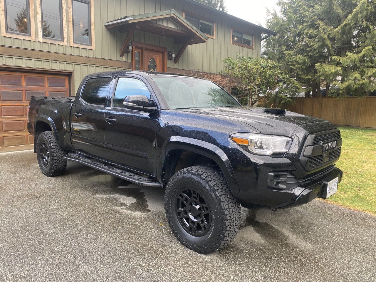

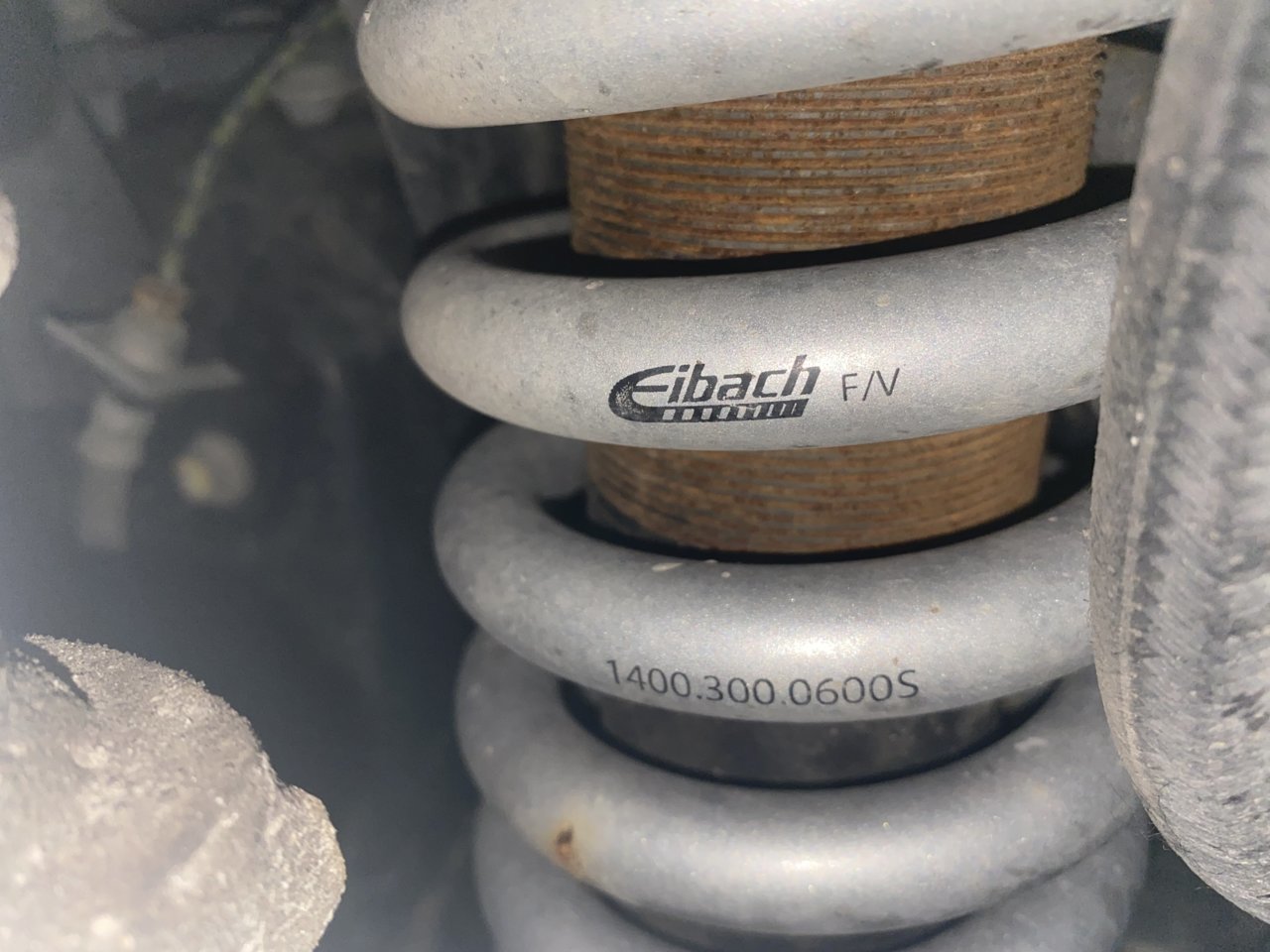

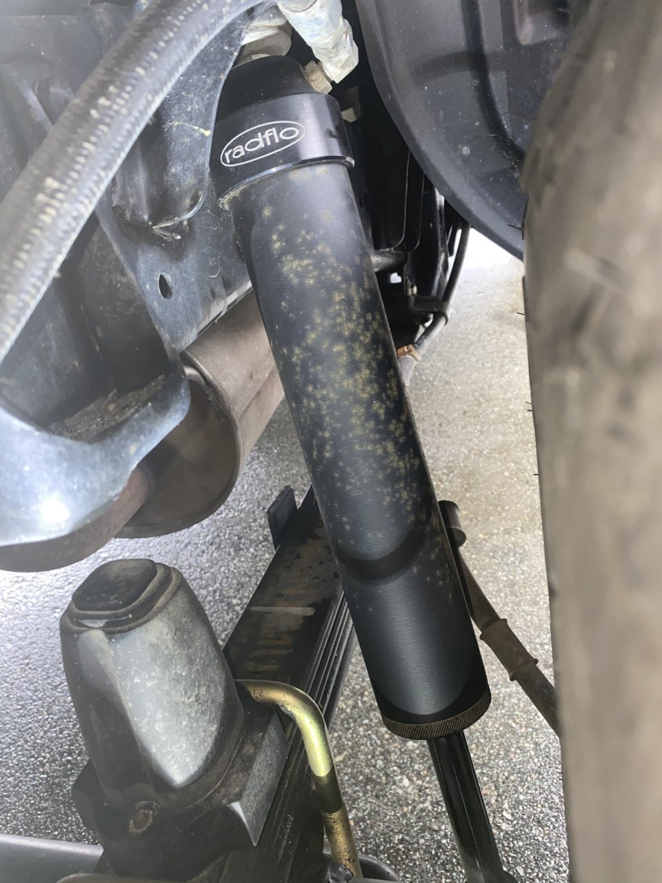

    For context I’ll be putting it on this rig. I’ve got a fair amount of suspension work done already but it’s going back in for a leaf swap on warranty (OME squeaking bs) and I’ll get air bags installed then.
    Hoping to also get my shocks and coil over bodies and resis swapped at the same time as they rusted all to hell in 10 months.

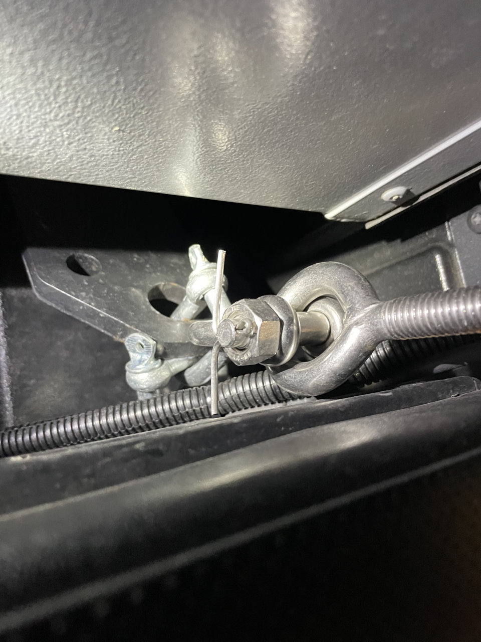

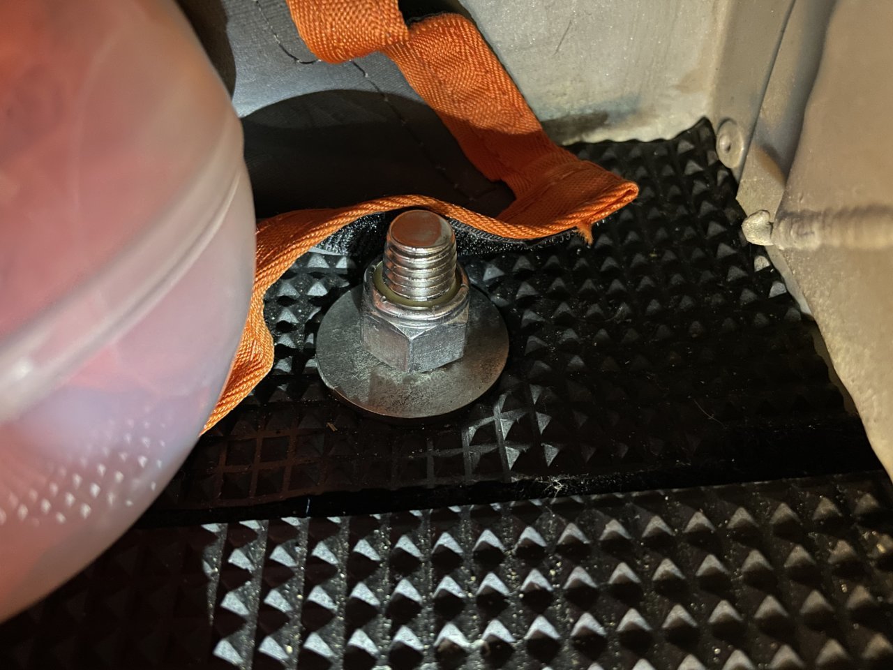

    So I really couldn’t offer you advice on mounting. I went 100% with the factory equipment since I do a good deal of backcountry stuff and certainly wouldn’t want to lose it. I actually read an article a few years back about a guy who dropped his 4WC off his Tacoma (or similar) while off-roading. It wasn’t great, i think they ended up getting like 10 or 12 guys to lift it back onto the truck while out on a California trail. His attachments points came loose so be careful!
    anyway I just went in my garage and took the best pics I could. It’s cramped space in there but you get the idea. The bars I have bolt down to the bed than Stainless hardware attaches a long I bolt (6”) to that, and finally that eye bolt pokes through a reinforced hole in the camper and a lock but is fastened to that. E-rigging online would have any and all of that stuff you need, once you decide how you’re doing it. Here’s a few pics I hope it helps. Good luck!
    079A812A-E431-4425-9D69-71E0F3C19E40.jpg 1AF17C7C-069B-4C65-88FA-B03D9E6A9F8A.jpg
    I will say I have seen several truck campers lately that attach via ratchet straps to the bed D-rings, Kimbo as well as the new Cirrus 1/2 ton truck camper both use ratchet straps without issue. I follows SpaceHover on IG with his Kimbo, and if the straps held on for him they must be strong enough, good luck.
