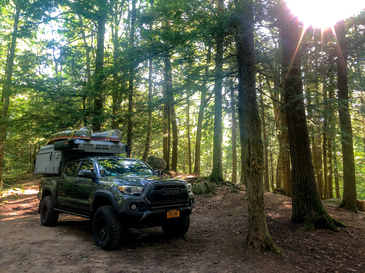

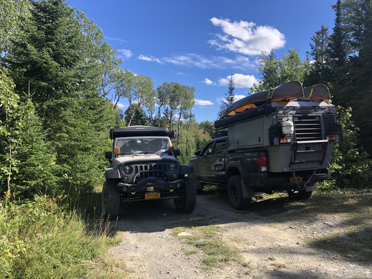

    2017 Double Cab Off-Road
    OME HD Lift all around, SCS SR8 Rims, 255 85 R16 Cooper ST Maxx, Decked Drawers, 30" Rigid Pro Light bar above bumper on Rago Mounts, Rigid Dually Side Shooters on Rago ditch brackets, Hondo Garage Un-Holey Phone Mount X2, Hondo Radio Knobs AR Bolt Face, Garmin InReach SE GPS synch'ed to Iphone for GPS only mapping, Wet Okole Seat Covers, Husky Liner Contour floor mats, 63 QT ARB Fridge on Alu-Cab tilting slide. GoFastCamper (#41), ARB 2500 Awning with Full Room, Mobtown Off-road Sliders and Full Aluminum Skids.
    96666C5B-3653-4164-B7B7-330E524D68BE.jpg DC3EE823-C75E-460F-8067-34BD8D04D63D.jpg
    1100# AluCab Khaya, fully loaded with water tanks filled.
    OME +660 rear leafs, 886X front coils. Firestone Ride Rite Airbags. JBA UCA’s helped a TON with stability. Also Cooper ST Maxx E-rated 255 85 R16’s.
    Haven’t done gears, 5.29’s are in my future, Covid messed up my plans last summer to visit ECGS to have them installed.
    Runs great at 65 and under, I don’t care for much over 70 mph, starts to feel a little questionable.
    I like it, wouldn’t change a thing honestly.
