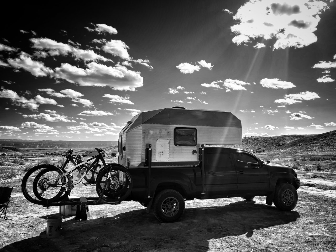

    You're not wrong at all. But, having made minimal enhancements to my suspension and carrying a base model Kimbo in the back, the truck handles it just fine. I had already had the standard 885 with Billys and Dakars installed a couple of years before. Only added airbags and E-rated tires. My tire weight actually became lighter going from a 265 Wildpeak SL to a 245 Toyo AT3 E. Being able to take this camper off by-myself in about 15min. and have my truck and not a full size is a nice thing. After having it off-road where line choice is crucial and plenty of highways and mountain passes, I am very pleased with how it handles. Yeah you take corners at recommended speeds, but I would hope you're doing that with a trailer or anything else that's close to the GVW. Gas milage is about the same or better than some rigs here, unless the wind is blowing in the wrong direction.l'll probably hit and hold 3k rpm and cruise up most mountain passes here at around 50mph, that's with a 900lbs camper alone, plus the gear, pups etc. I'll pay the price at the pump for more extended stays while camping, more restful sleeping, sever weather protection, and full winter camping. I totally understand if you don't want to push what's on the sticker, but many have and are doing it as safe as possible if you ever consider the FWC again. My driving is much safer with that thing on the back compare to how I usually drive.

    I'm about 13.5-14 with the Kimbo. Less than a half tank from Steamboat to Denver. Thats two mountain passes and 155 miles.

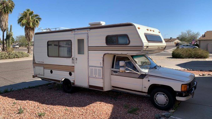

    Anybody remember these, rented once, other than no power it had all the room we needed. Slept 4. And we only went 500 miles.
