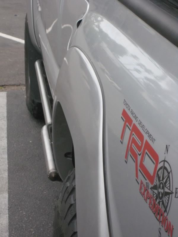

    Here are the current prices for standard sliders with kickout. I also want to offer sliders with the rear kick up, so all info regarding those will be up this next week. Pics of these mounted on a very nice truck will be up after this weekend.
    These have a 7/8" gap between the pinch weld and slider to avoid rubbing, about 5/8" between open door, and are higher than the bottom of the frame. Legs are far toward the ends to avoid any unwanted flex.
    Narrow or Wide available

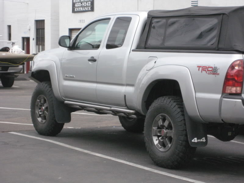

  2. Mar 5, 2010 at 6:16 AM
    #22
    gjbonner
    gjbonner Well-Known Member
    Nov 1, 2008
    #10420
    1,276
    Guy
    Northern Idaho
    07 Tacoma Off Road TRD
    Rhino Lined exterior,Fab Tech 6", 1.25" SpiderTrax spacers, Wheels painted Rustoleum Hammered Black, All Pro front plate bumper, Warn 9.5 ti winch, BHLM, Cig lighter constant on, Door beep toggle switch, Locker mod, Lock/unlock beeper Mod, Rear tailights smoked, 750w inverter with the outlets and on/off switch wired to rear of the console, Blacked out badges, blacked out rear bumper.
    wide version for me:) 05+ DSB

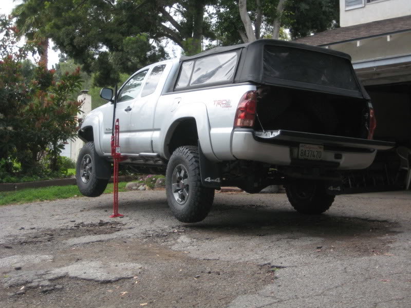

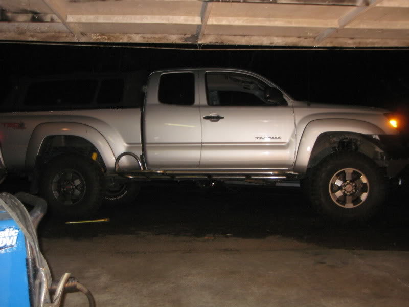

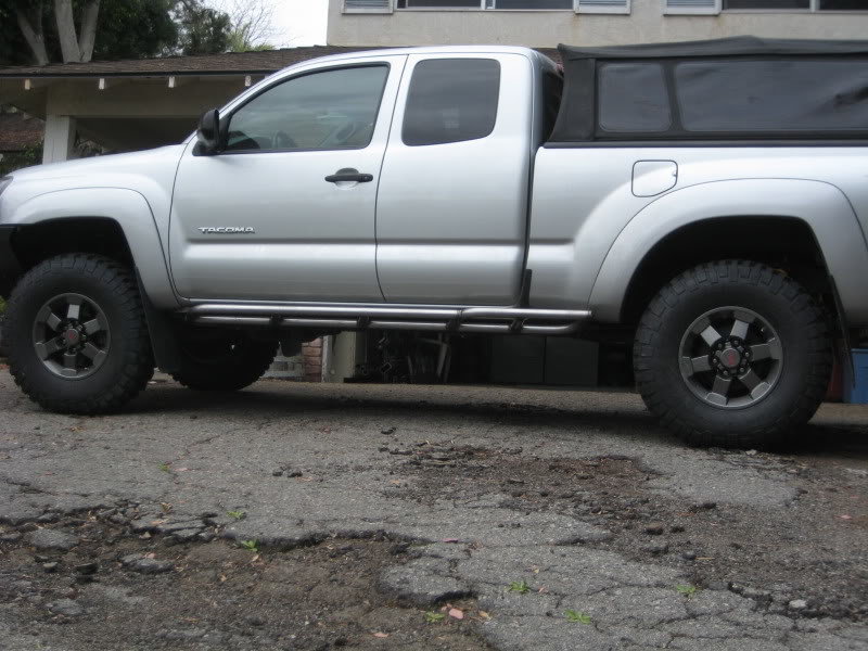

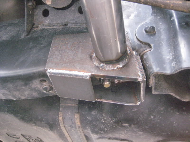

    Well, today was a good day to play with sliders!
    We were able to get the completed slider back onto my truck for a little bit of testing, but before I go into the results of this testing, I want to give you guys some facts about these sliders.
    1. The front leg is only about 7” from the front of the slider. This means that the most critical place on the slider (the front, as that is where you come down onto rocks most commonly) is FULLY supported.
    2. The rear leg is only about 9” from the rear of the slider. Once again, this means that the rear of the slider is FULLY supported. Also, as Beefed has mentioned before, the rear bracket acts as a sort of slider to where your leaf back mounts and blends what is normally a sharp edge on the stock Tacoma:
    (notice those nice looking welds haha)

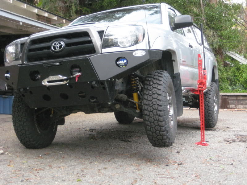

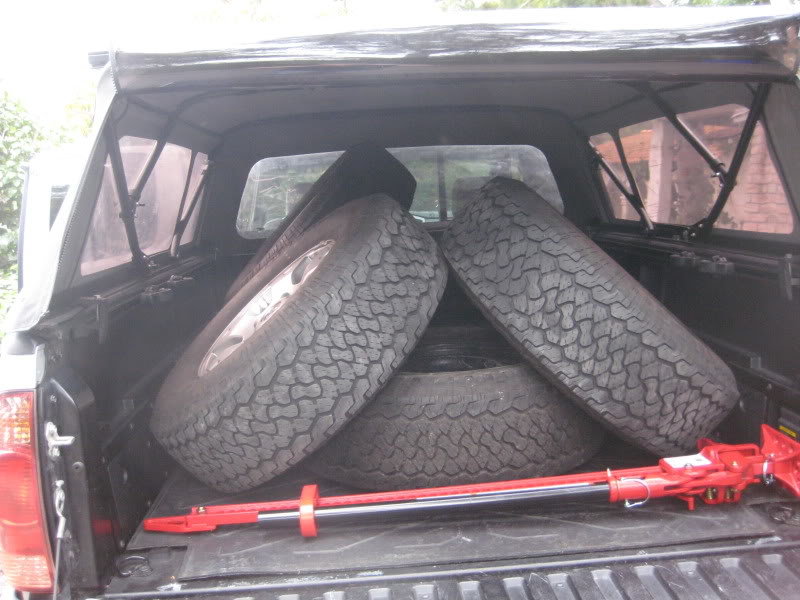

    Now for the fun….the HI LIFT TEST
    So, first off, my truck is by NO means lightweight. I have full winch bumper, with winch, 33+” tires all the way around, larger susp components, etc. I also had a FULL load of wheels/tires in the back of my truck (my spare 33+” and 5 stock OR wheels and tires) and a full tank of gas.
    So, what is the hi lift test? JACK THE ENTIRE SIDE (not just one wheel) off the ground using the CENTER (allows for most bowing on the long outer tube) of the slider (Notice both wheels are off the ground):
    There was MINIMAL flex (though Beef was still wants less so is investigating ways of making it less). However, I am not worried about this as the flex was VERY minimal, and working as an aerospace engineer, I know materials, and I know that NO (affordable) material will not flex. Flex is ok as long as you stay in the elastic region of the material, meaning, as long as it come back to how it was before, you are good to go… and as you can see by the following pics….it did!!!
    Before Test:
    After Test:
    Now remember, this is a worst case scenario with these. We are lifting the ENTIRE vehicle from the CENTER of the slider, and she bounced right back to where we started. I’d say it passed

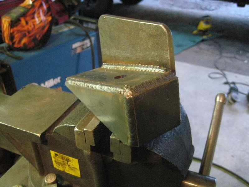

    And now for a few teasers of my special kickup that we are working on (please note, supports for the hoop will be added, this is just a teaser pic)

    Robert, that's an excellent writeup as usual. 2 thumbs up! :thumbsup:
    Guy is your frame the same platform as his AC? It should be right? The other 2 are the standard cab and the 4 door LB, so these should fit yours, which means I have a wide set waiting with your name on them. You're right, you have been very patient, along with a couple others and I can't thank you guys enough.
    My main goal with any item is to R&D every little detail and offer a product that will work as claimed. I don't like offering anything until I feel 100% comfortable with it. What's taken so long is Steven is very busy, and so am I, but I just felt this was LONG overdue and have put some stuff aside to get this moving for real. Now I'm ready to get a different model here and get those available.
