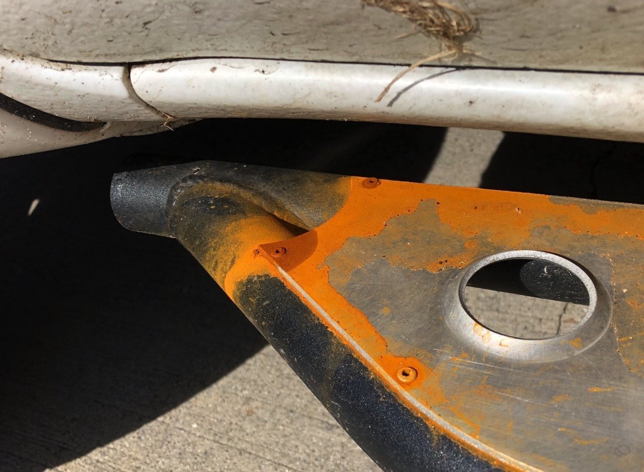

    The rivets holding the plates on my sliders are allowing water to get inside the sliders and rust.
    That damp area is there because I drove the Tacoma just before taking the pic. Evidently there is water trapped in the sliders and some of it sloshed out while driving. I drove in the rain a week before this pic was taken.
    This is happening on both sliders.
    Not sure drain holes would be the best solution. Any ideas?

    I'd drill a hole underneath towards the rear then lift the front end of the truck to drain as much out as possible. Then insert an air hose from a compressor and try to blow dry it out. Then I'd use eastwood internal frame coating with their 360 spray nozzle hose. Then seal up hole and caulk those rivets up as best as possible. Thats my 1 minute gameplan brainstorming.
    Looks like the rivets were not the best idea.
    https://www.eastwood.com/eastwood-internal-frame-coating-14oz-aerosol.html

    Hey @BKinzey sorry to see this. We have received some feed back on this issue and have a fix. We now use a seal rivet that when installed doesn’t have the hole for moisture to get into. We will make this right for you. Can you please shoot me a DM so we can work out the details of getting you taken care of.

    Just an update. I bought these used. Was expecting TW to offer suggestions.
    Apex has offered to remove the sliders, remove the rivets, drain the water and dry out the tubes, spray in anti rust treatment, put the plates back on using sealed rivets and re-install for free. Their shop is close to LA so all I have to do is drive down there and then return a few days later for them to reinstall.
    That's definitely standing behind your product.
    I've got an appointment for tomorrow.:taco:

    that's great they are trying to take care of you. :thumbsup:i have a set of sliders that have a cover plate with rivets. the powdercoater insisted on assembling tightly before doing the powdercoat exactly for this reason. (wish me luck).

    From my experience they have been nothing but great as far as customer service and I've also been very impressed with their products. FWIW, I have the same sliders, riveted on with aluminum rivets, and they've been sitting out in the elements for a three months without any significant rust. Occasionally I'll see a little bit of rust on the edges but nothing that makes me more concerned than the surface rust I see all over the undercarriage. I'm guessing OP's sliders were fully submerged at some point, which should definitely be considered in the design of the parts. I'm going to take Chris' recommendation and add a dab of silicone to the rivet holes to close them up to be safe though.

    Still don’t understand why they are riveting on the fill plates. Welding on would be a much better approach.
